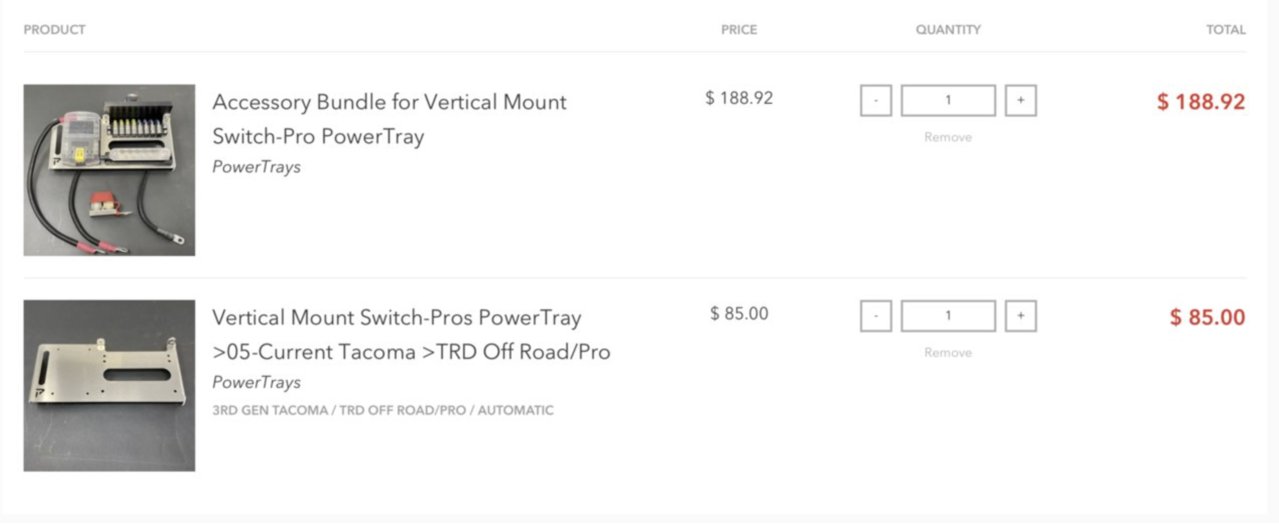

    Just want to make sure I got everything I need before I place the order. I got a 2017 TRDOR and just got a fridge so I want to start upgrading the electrical. I ordered a Group 27F Northstar, and 2nd gen battery tray. My goal right now is to add a panel to the bed of the truck so I can plug my fridge in. Since I plan to hook up the bed panel directly to the bluesea I don't think I need the switch pro at the moment. No winch at the moment. Besides what I attached in the pic, I think the only thing I need is the cable to go to the bed of the truck. Any suggestions on gauge for that?Screen Shot 2020-08-24 at 9.57.33 AM.jpg

    Yup thats everything you need for the install of the Switch-Pros PowerTray system and as for the fridge, I offer a 10 AWG wiring harness and Blue Sea accessory panel that will allow you to Power your fridge and monitor your battery voltage at the same time. Plus there's two USB outlets so you can charge your phone speaker camp lights whatever you need back there too.

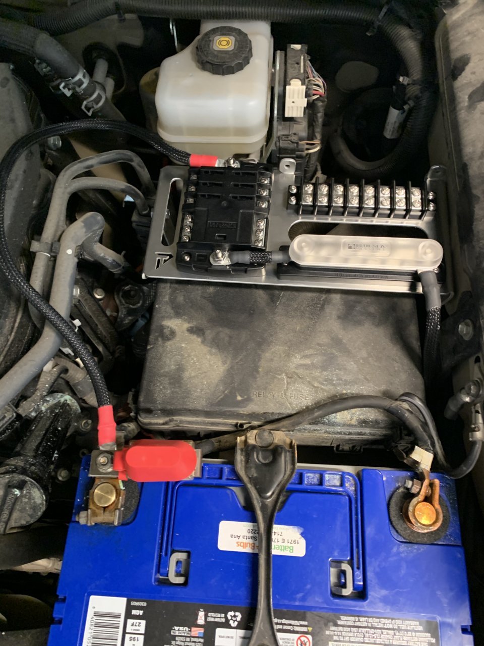

    Alright peeps just want to make sure I’m wiring this correctly. So far so good? Don’t have a switch pro yet so going to wire a panel from the bed of the truck to the blue sea so that I can power the fridge. From my understanding I just need to run cables from the back panel to the blue sea and plug the positive to the top portion of the blue sea and the nagatice to either the bottom or the extra negative block? Correct?

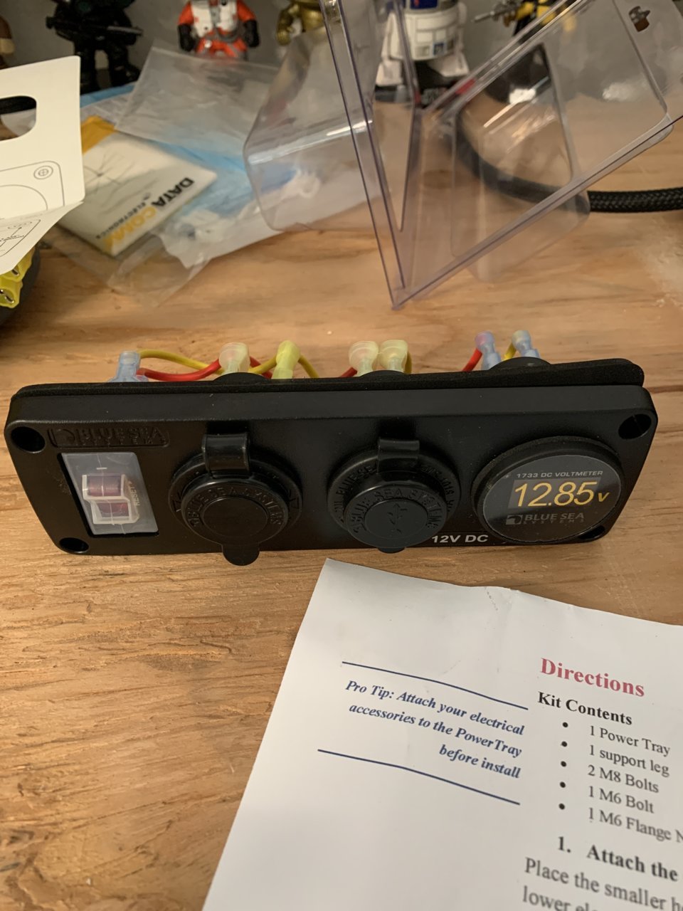

    image.jpg Also what size fuses to for something like this that I’m going to be connecting a fridge and some usbs?

    The ARB 50L has a peak draw of like 4 amps.
    USBs are usually 1-2.2 amps each. I think the Bluesea ones are 1ish amp per usb plugin
    So call it 2.5 for the USB outlet and 5 for the 12v fridge outlet, I'd put a 10 or 15A and call it a day.

    Yep that’s correct! Also you’ll want to place the cable on top of the MRBF 100a fuse space that it’s protected

    The switch on the below deck panel is already a 15 amp breaker so 15 amp fuse is perfect.
