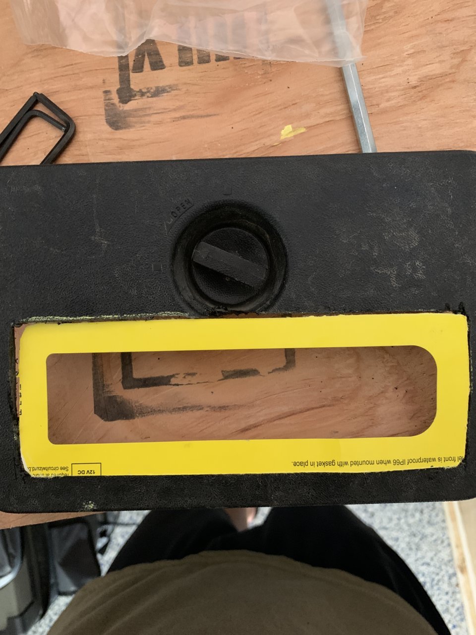

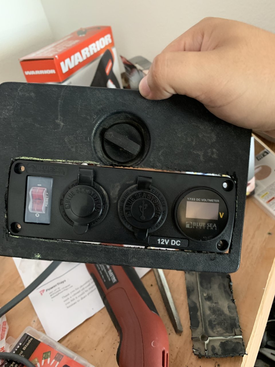

    I meant to cut inside Rectangle. DOPE!

    Oh nooo! Good thing that it’s a cheap part!

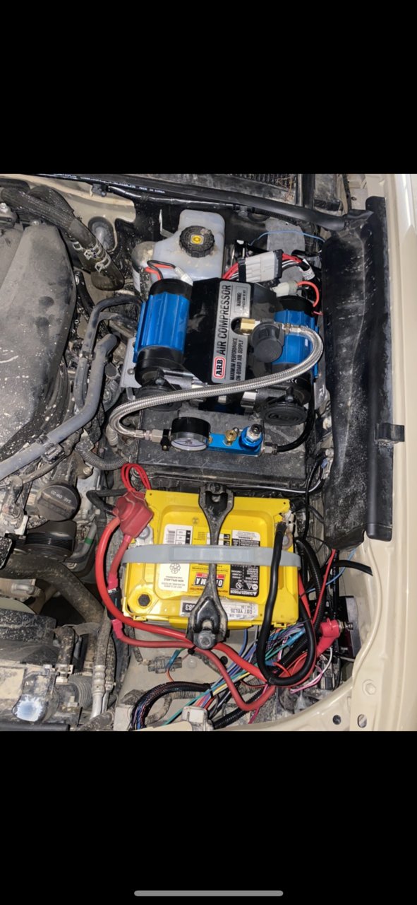

    Is there a power trays setup that will fit with a dual arb already mounted on the driver side?

    Possibly Im making some universal mounts that will mount on top of the OEM fuse block cover. Do you have the dual compressor mounted? If so id love to see some overhead pics to see the allowable space left over.

    here you go. this is the current switch pros setup that was done by a local shop last week.

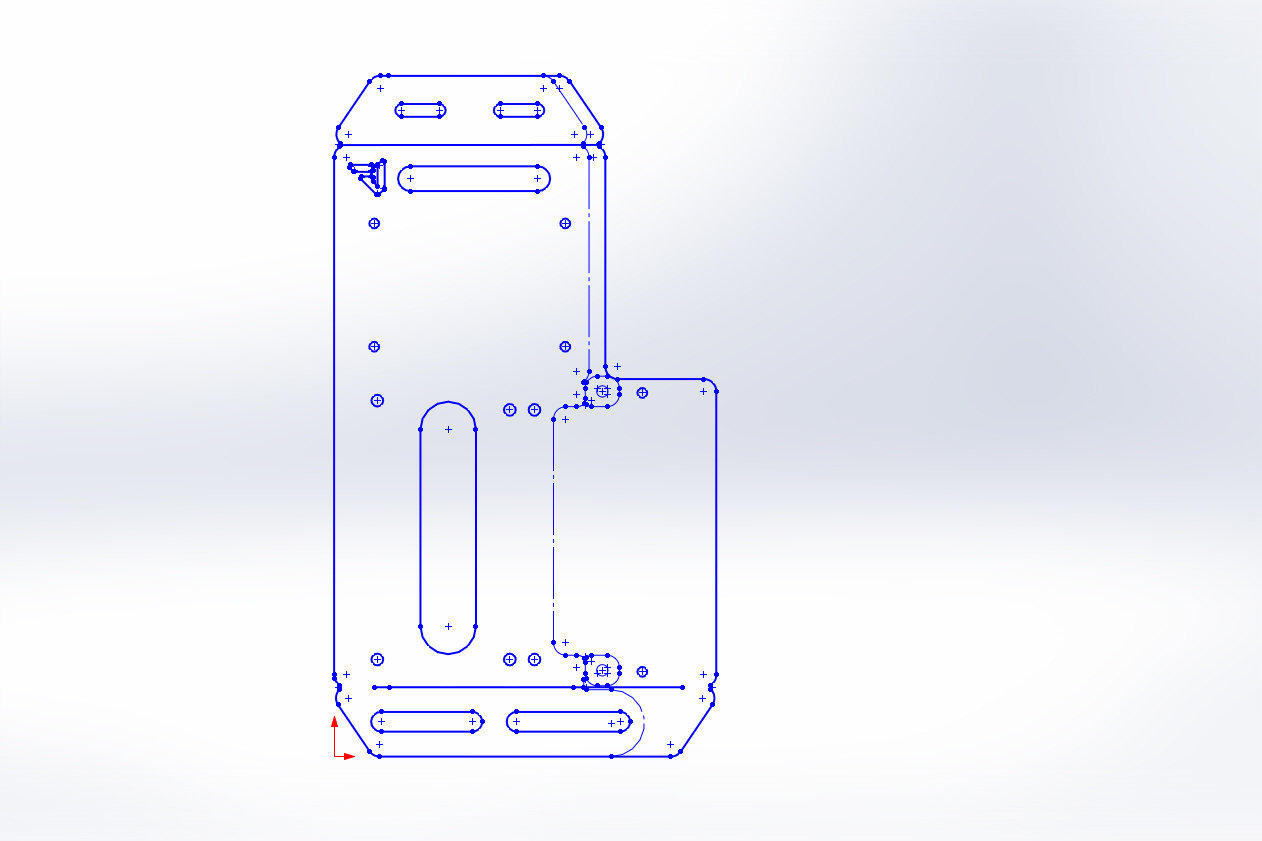

    Is there any way to modify my "gen 1" switch-pro mount for the new (vertical) style mount? I have the combination switch-pro and bluesea one...my guess is no, but I figured I'd see if there was an adapter kit or something.
    My 8100 is on the fritz and I'd rather switch to a vertical system if I can when I have to replace it.

    Technically its possible if you've got a steady hand. I created an overlap to show the changes from the original to the new vertical version.

    gotcha yeah that pretty much uses all the space unless you can relocate that air manifold setup...? Curious though, are you still able to remove the OEM fuse box lid?

    Excellent, I'll see what I can hack up.

    Need to remove the compressor to access the fuses.

    There are kits that you could move the air compressor to the passenger side.
    Alternatively, you could get creative. The passenger side (at least in the second gen) has the same threaded fender holes as the driver side. You could mount a powertray upside down on the passenger side and it would give you the same orientation of the mounting holes, just on the other side of the engine. Then grab a piece of flat stock aluminum and make a leg that runs from the tray to something for support. I think the 3rd gens still have that weird Y shaped bracket with the threaded studs right?
    You'd have to source longer cables, but you'll never guess who sells those to order as well :D

    Yeah at least on the TRD off-road/TRD pro models. The sports have that ABS module that occupy the space but you could retrofit the power tray to fit over top of that.
