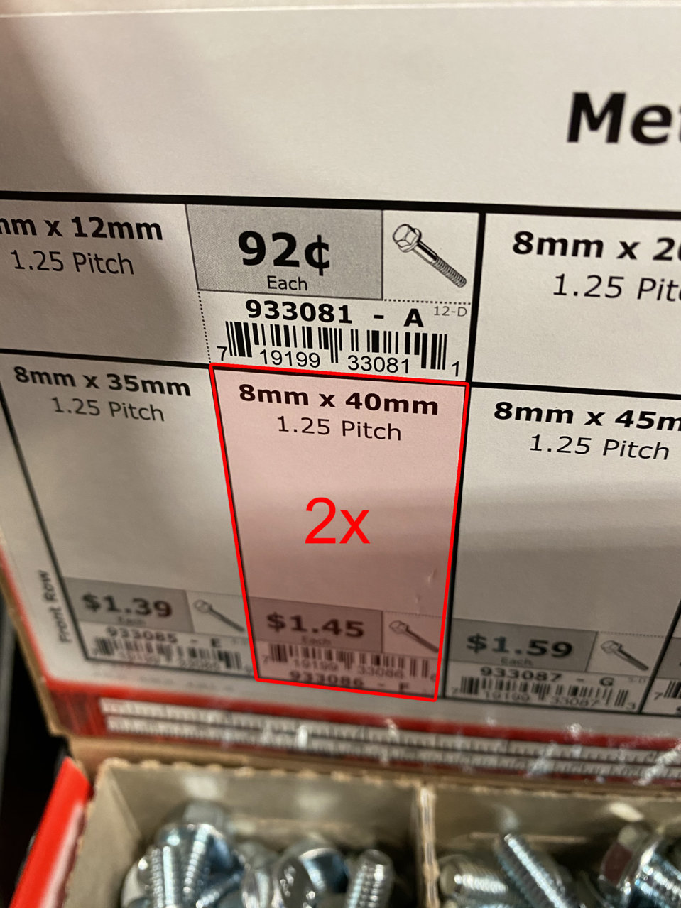

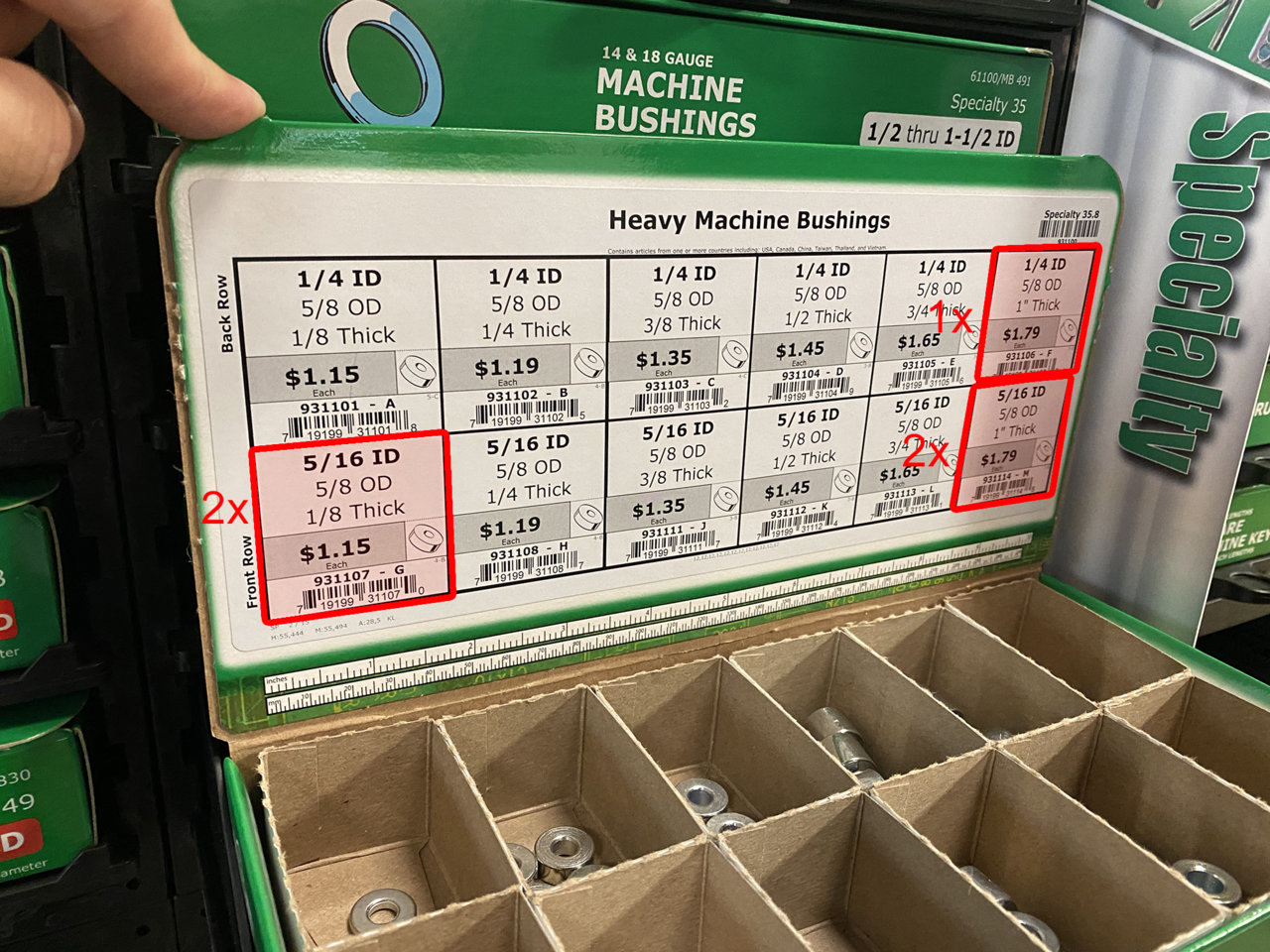

    With the help from @SpikerEng I was able to get exact measurements of how much space was needed which is 1-1/8". For those who are interested, I was able to source everything at my local hardware store. I didn't take photos of the hardware but I have the labels below --

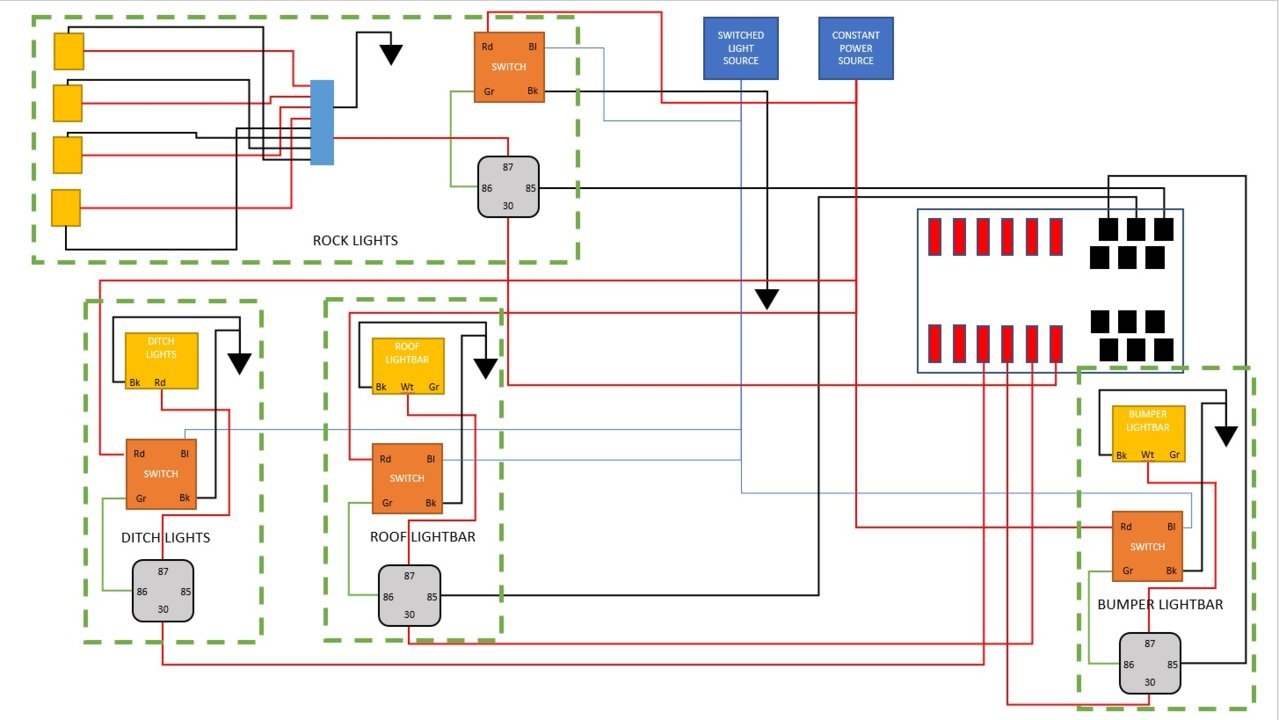

    Just started planning out my tray/ wiring.
    Have to wire 40” BD S8 lightbar, 30” BD S8 lightbar, BD Squadron Pro ditch lights, and BD rock lights (x4) and still have future expandability.
    First draft:

    you don’t need relays with a SWitchPros... just saying. Might make your like easier

    It’s not a switch pro

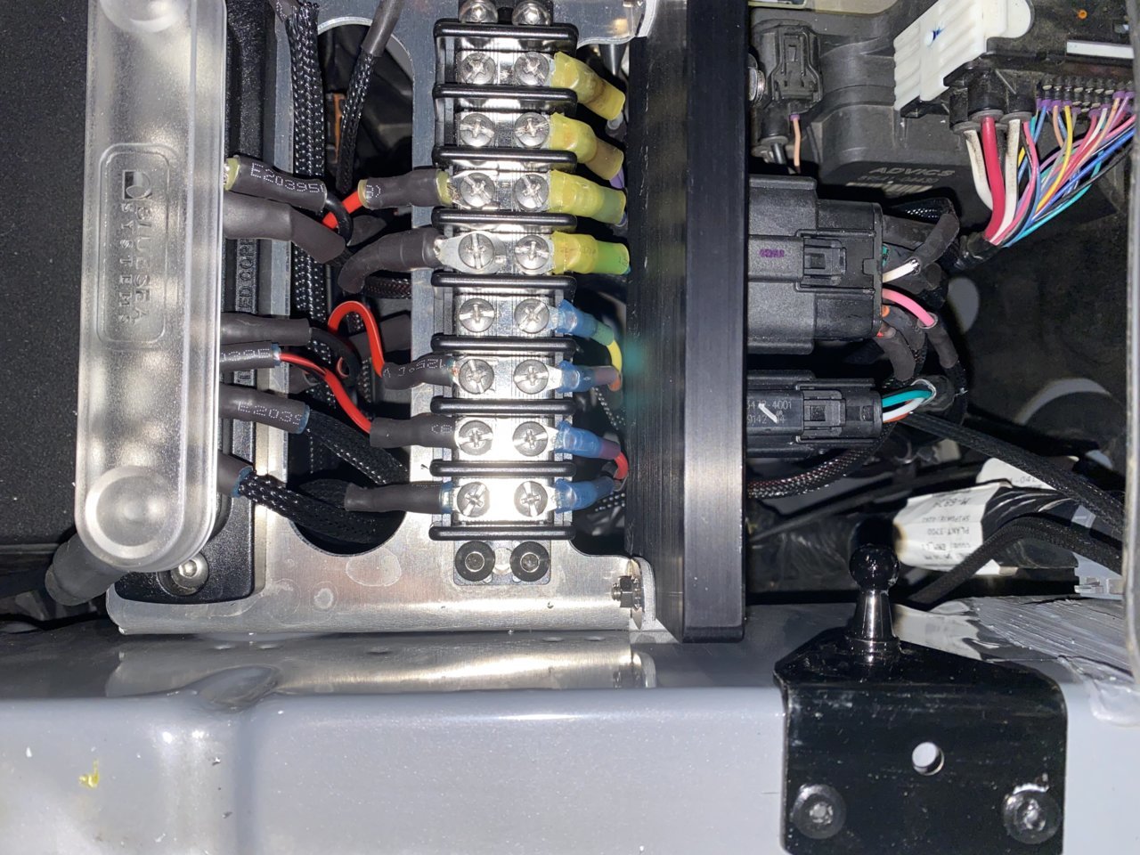

    Very happy with quality and install! Thanks again Maverick...

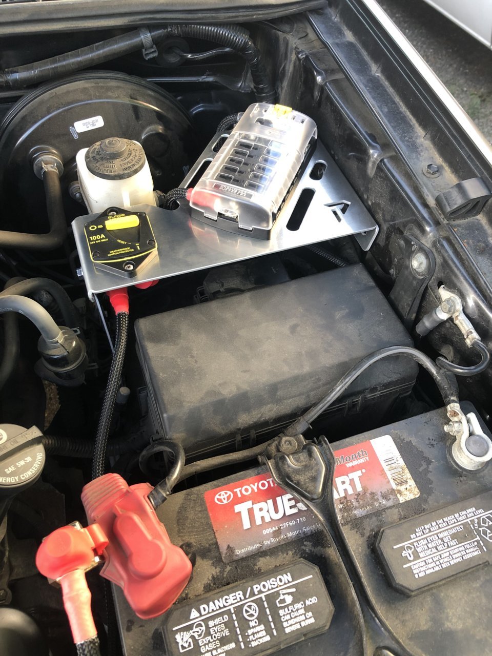

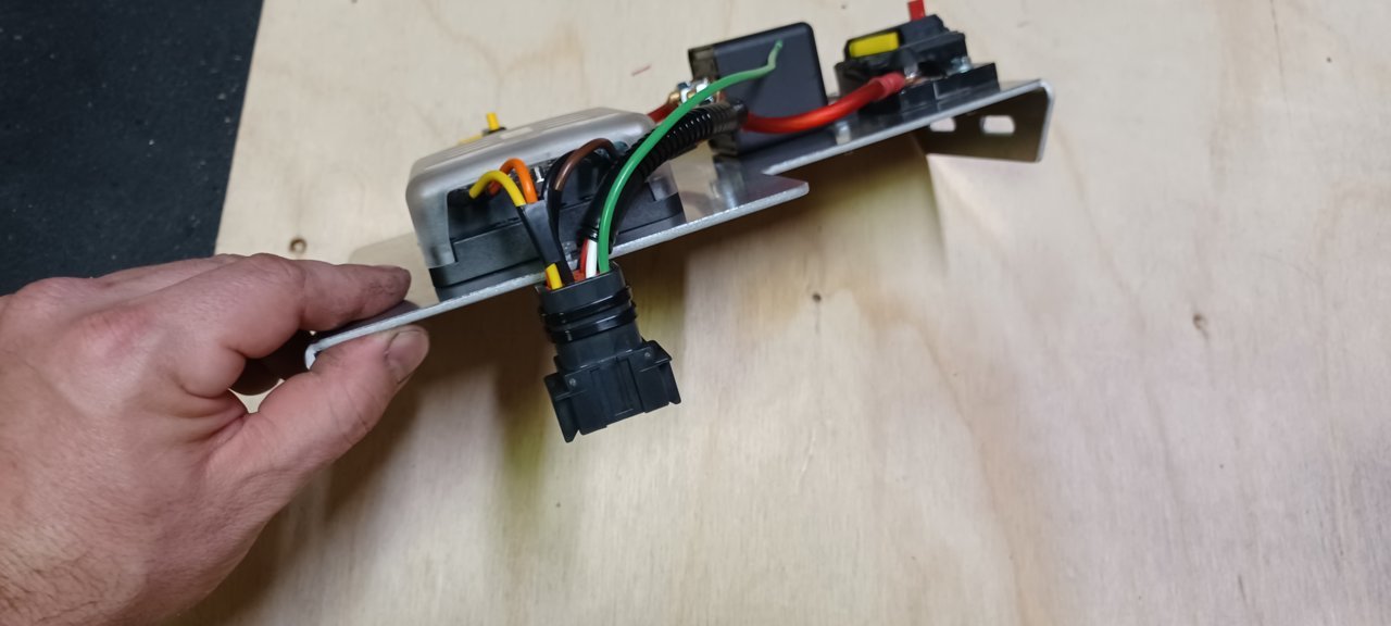

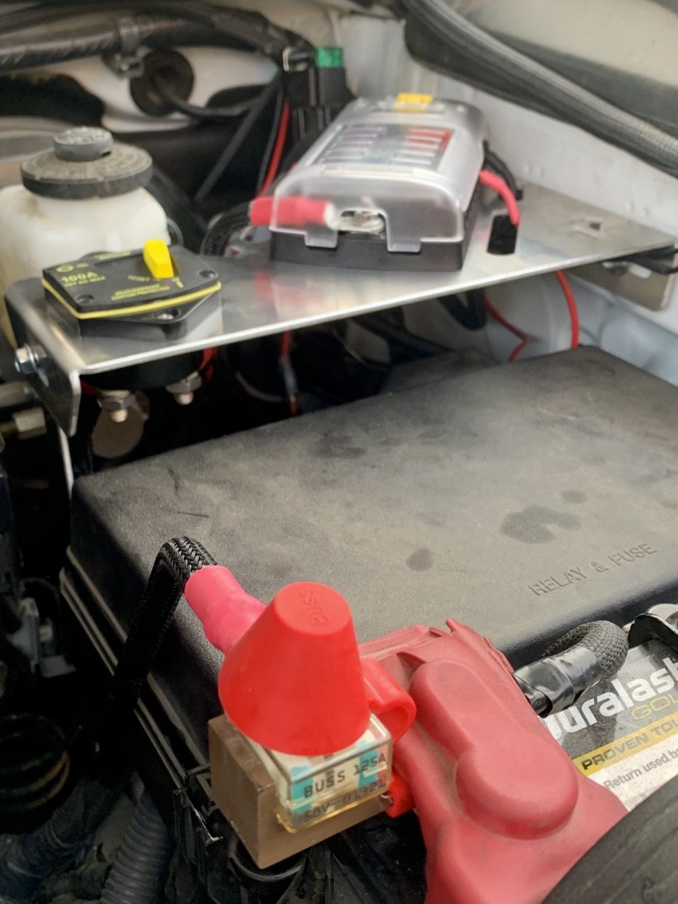

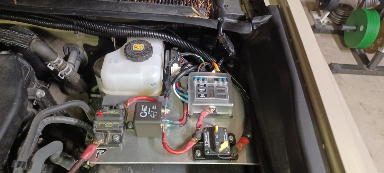

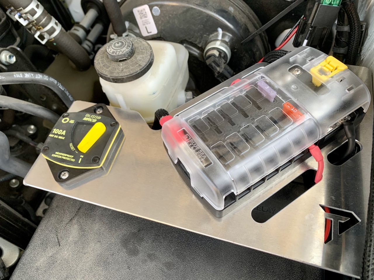

    Modified my gen1 switch-pro tray to work with the switch-pro requested vertical mount. I also switched all my power/backlighting/trigger lines to the fuse block under hood instead of in the cab.
    I also cleaned things up (a bit) and painted it black.
    Big Foot and Kuntrykid like this.

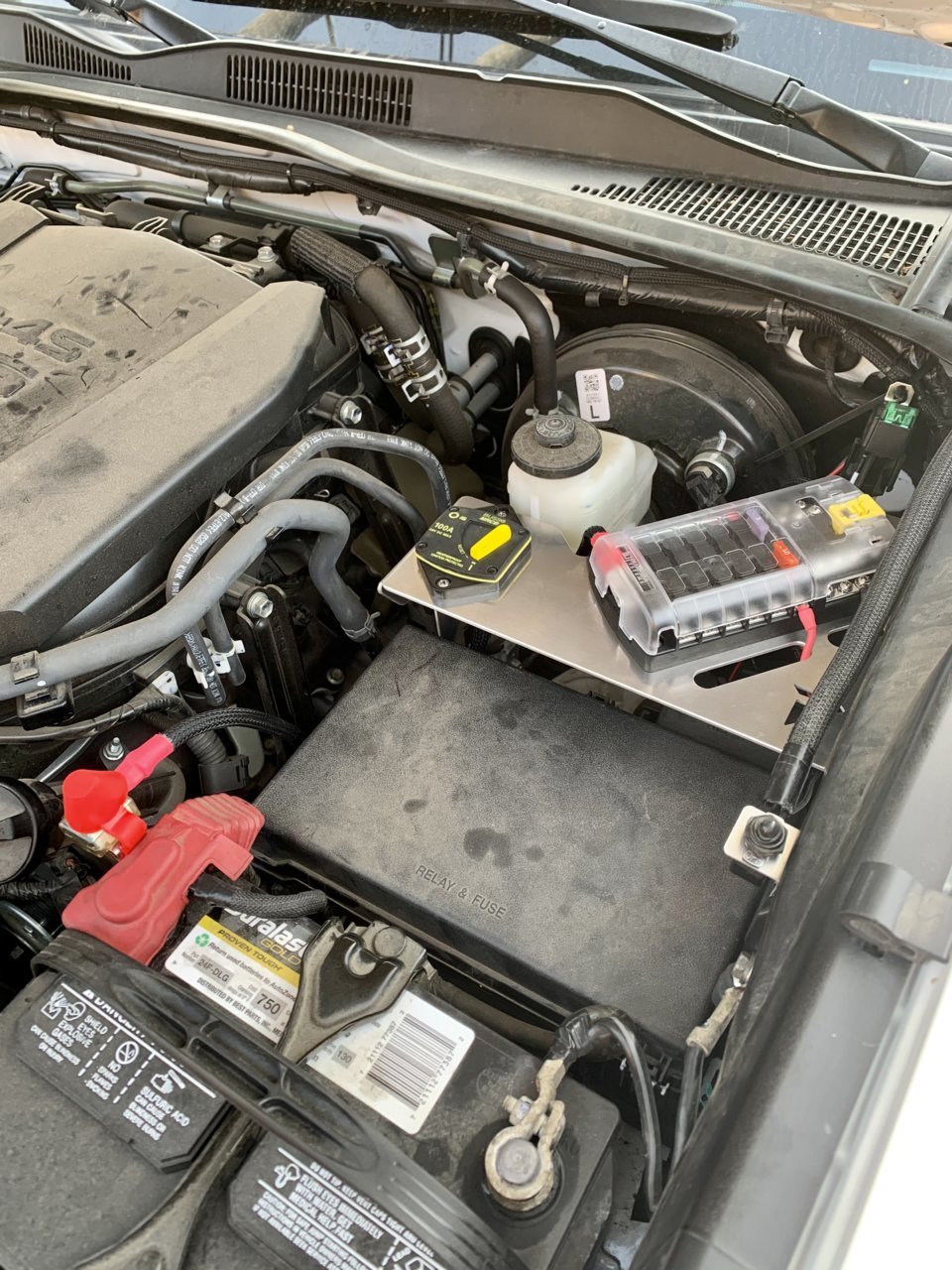

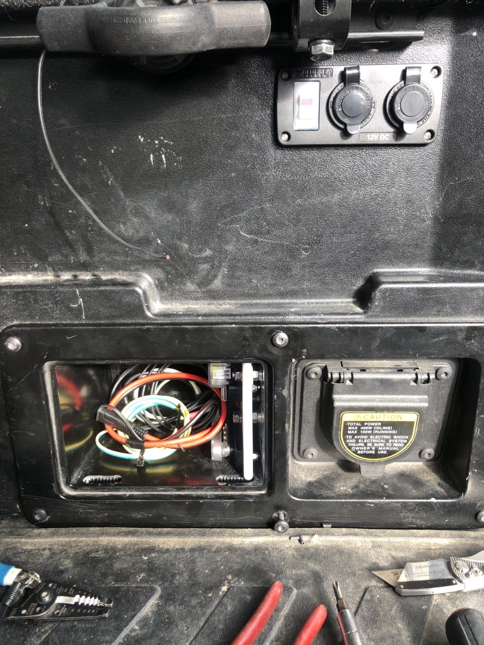

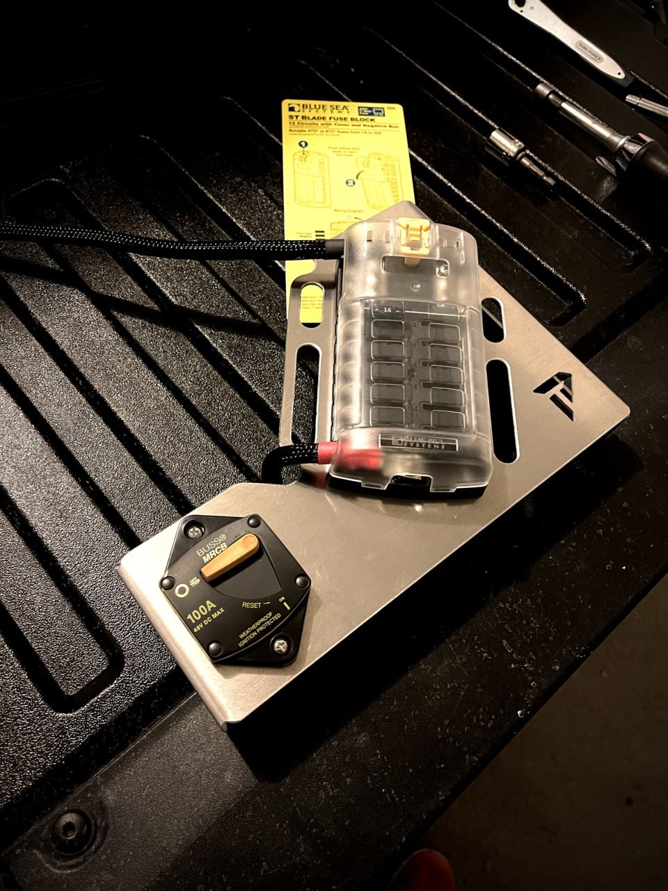

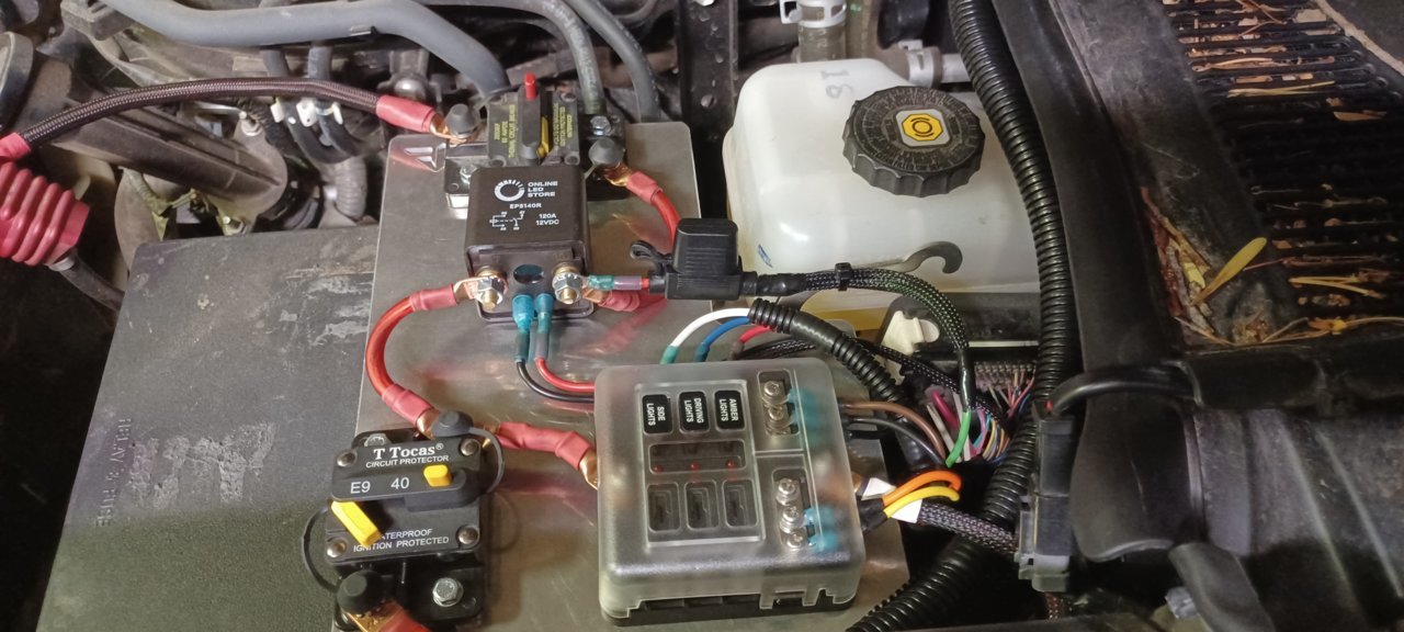

    Finally got this wrapped up. 2nd breaker feeds power to bed with air compressor and accessories

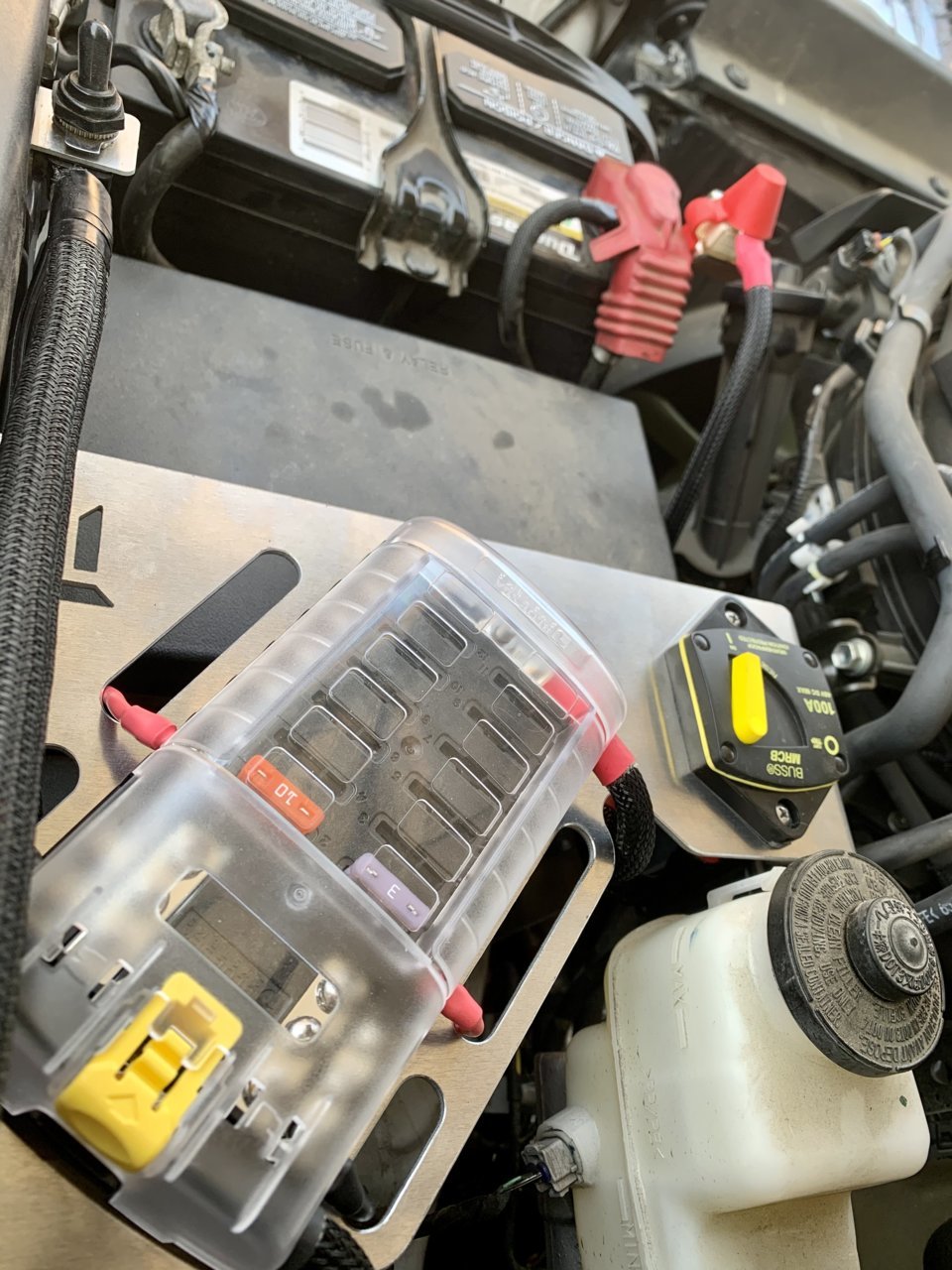

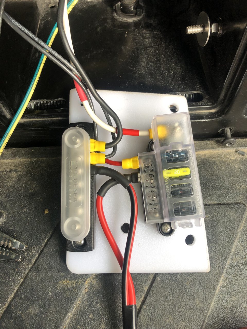

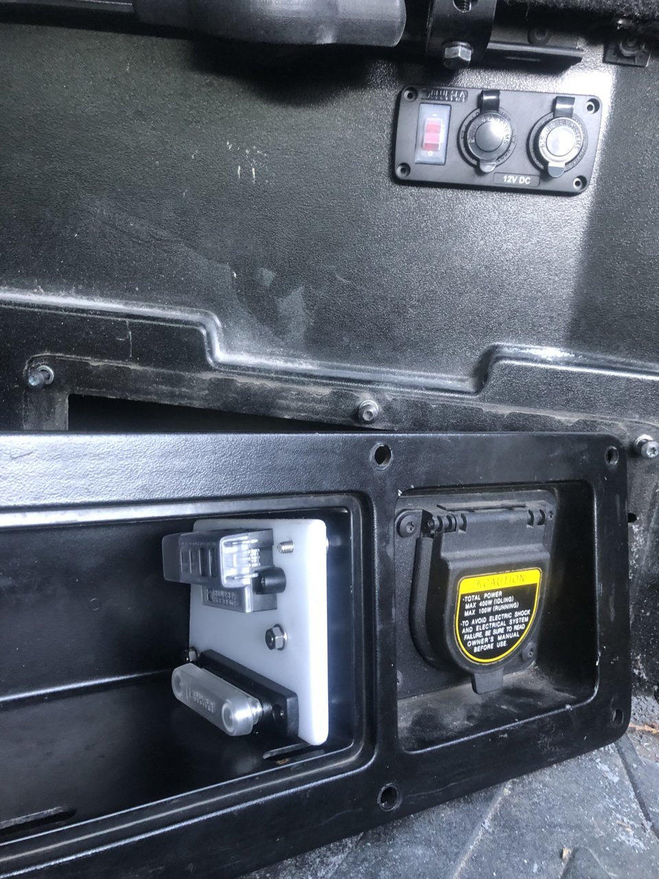

    15EB58BF-9AE1-4D05-99AE-1584C55CB21A.jpg Installed my PowerTray a couple weeks ago, wrapped this up over the weekend. Ran a pair of #10’s & a couple of smaller spares from the Blue Sea 12 ckt fuse block back to the small passenger side cubby. There they hit a smaller ground busbar & 4 ckt fuse block. From that I’m feeding a Blue Sea Below deck panel (usb & 12v plug) just below the canopy, a quick connect pigtail for a small portable Viair compressor, and canopy lighting that I haven’t gotten to yet. The ground bus bar & small fuse box are mounted on a piece of repurposed plastic cutting board that can be pulled out of the cubby to do any electrical connections. Most of the accessories I also got from PowerTrays & very impressed with the product & a seamless transaction! :cheers:
    3A249BE6-D7E2-4628-AD38-B6C3519FC73A.jpg 9A6C3226-EDB2-4EE1-9B3E-C9E8CD1A8F3B.jpg

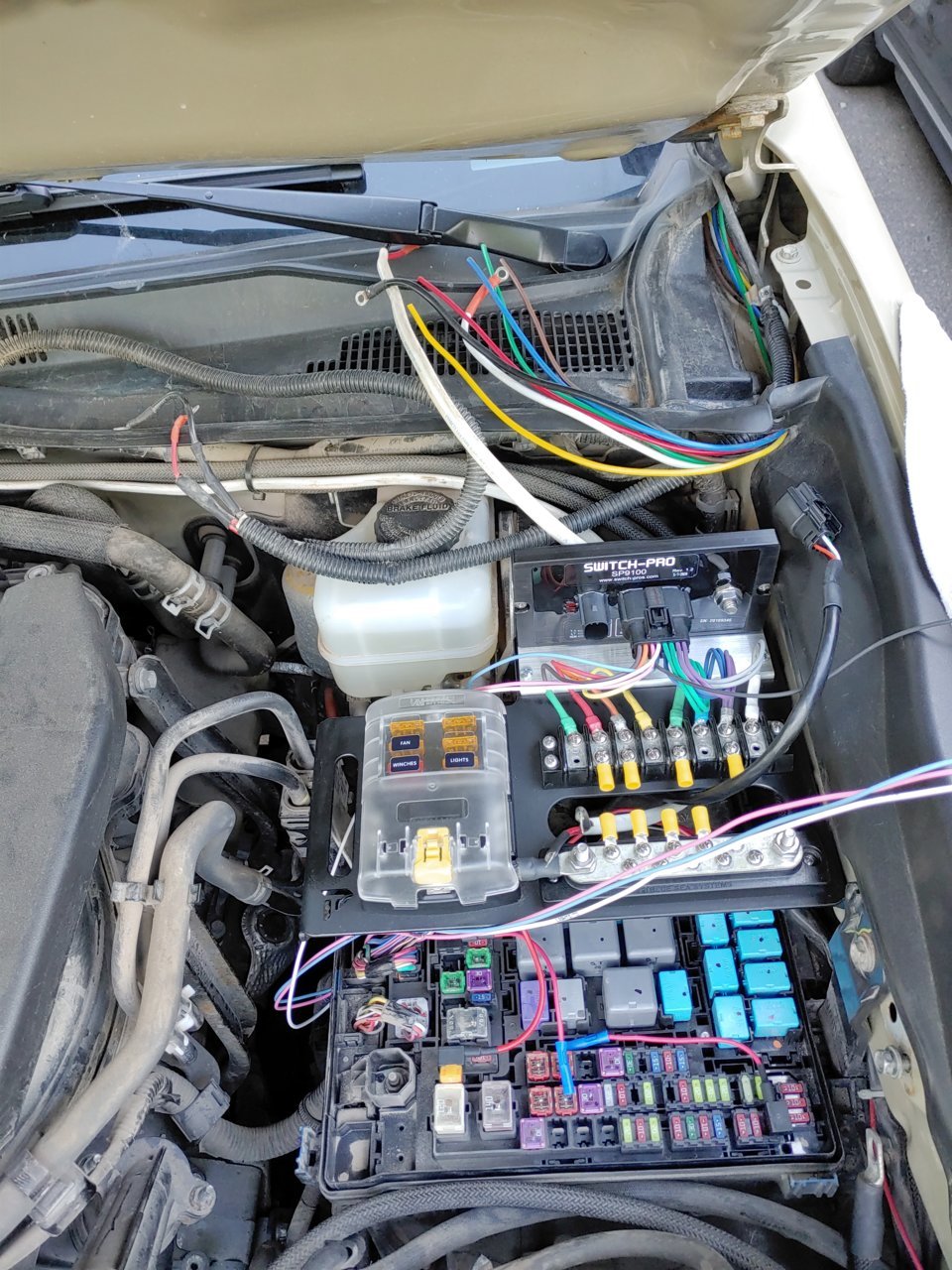

    Mine all went in the garage. I went with the power tray and a Switch-Pros to eliminate 8 relays and clean up all the extra wiring that you end up with from running a bunch of switches in the cab. Less wiring gremlins lurking at every connection. If you want to change something down the road it’s stupid easy.
