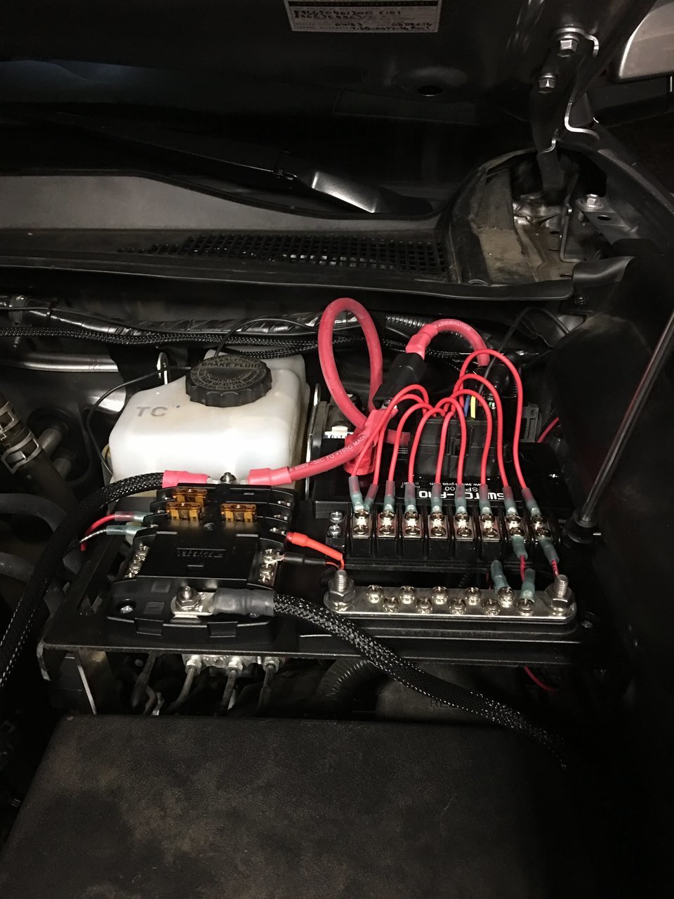

    All done! Errr mostly. For some reason the SP positive wouldn’t fit over my battery’s accessory terminal, so obviously not as clean as it can be yet but it worked enough to make sure everything powered up okay! Ended up doing plastidip spray in black and it looks awesome IMO. Great stuff @Mr.PowerTrays :cheers:

    I had that problem too. Drilled it to make it wider.

    Also most automotive panel edge trim should fit around the hole. But with how wide the hole is made its really not needed. Unless the wires get cut way to short and pulled tight to the edge, theres ample room for them to come through and not compromise the wire from abrasion.

    Awesome!! I’ll be checking later tonight then, can’t wait to get buttoned up. Yeah after mounting everything up for real it does seem a lot more spacious. Super happy with it, thanks again!

    The addition of the ground bus bar just on the other side of the terminal block makes it so that there’s no need to, run each accessory ground all the way back to your battery or try and find an open fender stud to ground to each time.
