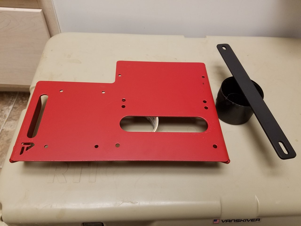

    Couldn't get the tray anodized the way I wanted in our processing shop at work, so I dipped it. Should match the future Odyssey red tops pretty well when it comes time!

    So this is going to sound stupid, but what size hardware did use to install all the stuff @CharlieCafe ? Went and got #10 and #8 screws at the store last night, and they weren't even close to gripping the plate material.

    I'm actually not sure. I picked up my hardware from @Mr.PowerTrays since I purchased the accessory components from him as well.

    You need bolts and nuts for the other side. Plate holes aren't threaded

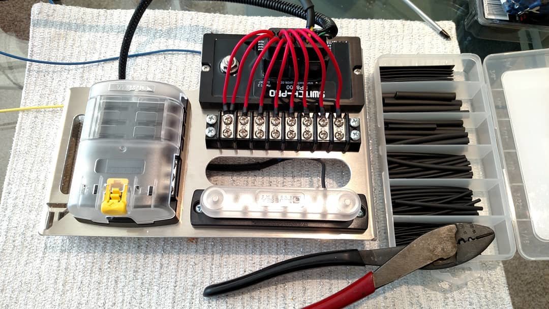

    This is what I have used:
    • Switch-Pros SP-8100-B (Blue Backlit Control) with Concealed Mounting Hardware (2x M4-0.7 x16mm Mounting Socket Cap Screws w/ M4-0.7 Nylon Lock Nuts)
    • Blue Sea Systems ST Blade Fuse Block - 6 Circuits w/ Negative Bus and Cover (12x #8-32 Screw Terminals, 2x #10 Stud Terminals, and 4x M4-0.7 x16mm Mounting Socket Cap Screws w/ M4-0.7 Nylon Lock Nuts)
    • Blue Sea Systems 8 Circuit 30A Terminal Block (16x #8 Combination Screw Terminals and 4x M5-0.8 x20mm Mounting Socket Cap Screws w/ M5-0.8 Nylon Lock Nuts)
    • Blue Sea Systems10 Gang Common 150A Busbar w/ Cover (10x #8 or M4 Screw Terminals, 2x 1/4” or M6 Stud Terminals, and 2x M5-0.8 x12mm Mounting Socket Cap Screws w/ M5-0.8 Nylon Lock Nuts)
    Hope that helps! It makes it so the nut attaches and there is not much sticking out the other side if any. That’s how I wanted mine because I didn’t want too long of a screw hanging out the back side.

    Dang. You wasted no time!

    What can I say, I like to do my research prior to purchasing things so that when it arrives, everything runs smoothly. I also like to help others as much as I can. I already have my write up complete for my install other than taking actual pictures of my own install. I will post it on my build once everything has arrived. Still have my new SwitchPro, Custom Length Welding Wire from @Mr.PowerTrays, and my Positive & Negative Military Terminal Clamp Connectors and Protector Covers in the mail. All of my BD Lights arrive the day after Christmas and I will be able to go to town on all my installs and wiring.

    This is awesome! I cannot wait to see that beast all wired up!

    Like @solscooter said, You just need nuts for the backside.

    whoa! haha good on you man! :thumbsup: very thorough.

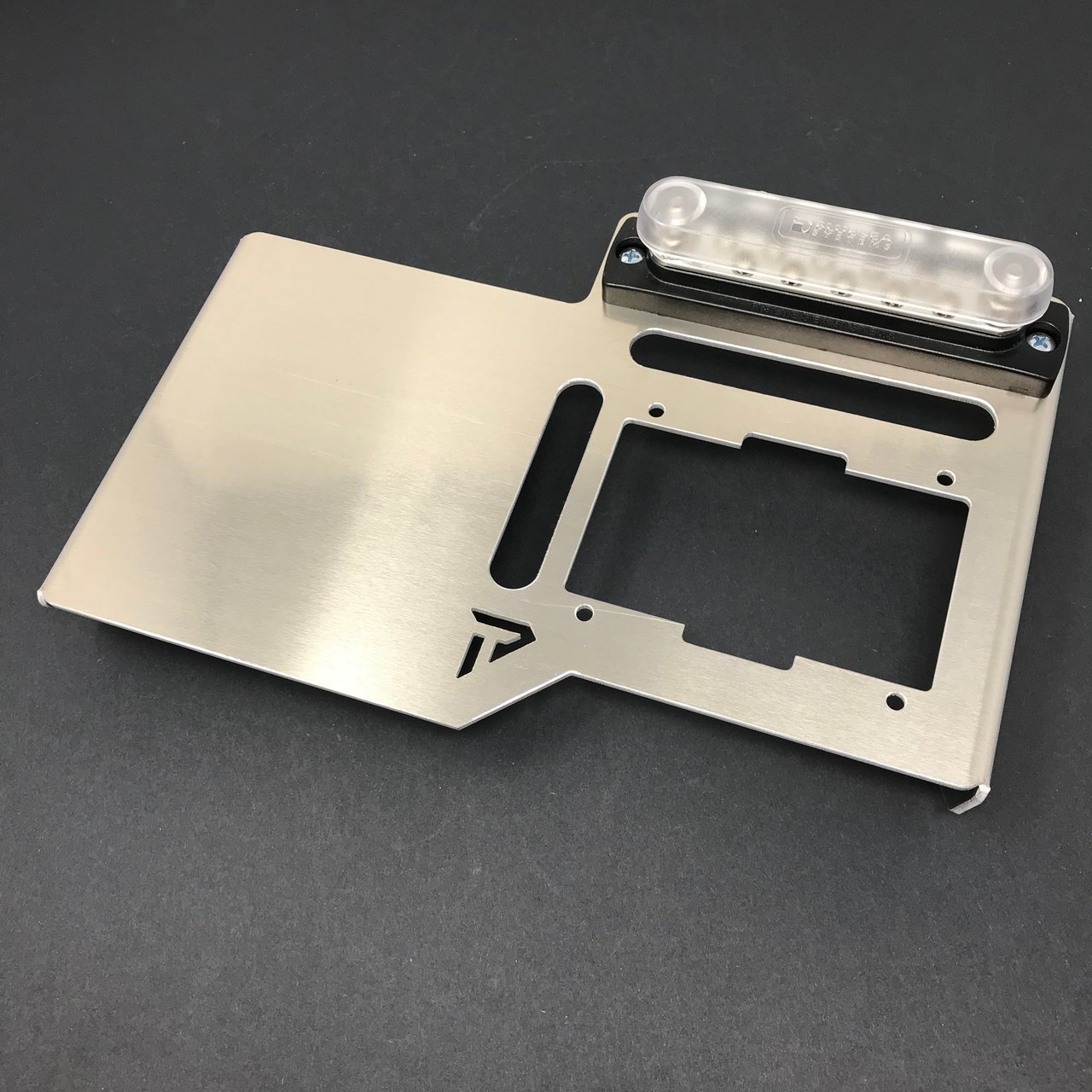

    This is what i'll be offering for the RTMR.
    Since most people using the RTMR have very specific power needs I didn't allocate specific space for circuit breakers.
    But surface mount circuit breakers can easily be mounted in that location.
