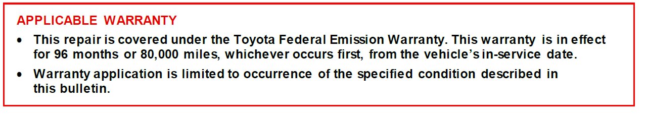

    Is it not covered by the Federal Emissions warranty for 80 months according to the tsb ?

    Good question, would be great info to know and something to throw at dealerships if they try refusing.

    Yes, as stated on the T-SB itself, the service is covered by the 80,000 mile warranty.
