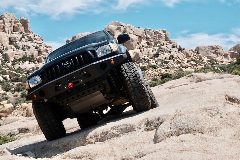

    I took this rig home with me in 2005 with 6k on it in norcal. Someone swapped it for a tundra, or so they said. Wheeled it stock for a long time except for a shell I put on it. About 4 years ago I put some method nv's on it and some bfg Ko 275/65r16. By that time the suspension was starting to be completely shot and could barely go offroad without bottoming out. Right when I was gonna throw money at it, I spent most of what I saved on a jetski for surfing, then put it off for another year. So tWo years after the jetski purchase, I ended up finding TW, and just lurked looking for info. So glad I finally joined cause Ive met some of cool fn peeps and learned a lot. The rest is history, I have started the mods and my list keeps growing. This is how my rig sits today.
    and more transformation shots
    And some shots pre dorkel
    and this is the earliest photo i could find just prior to the methods going on.

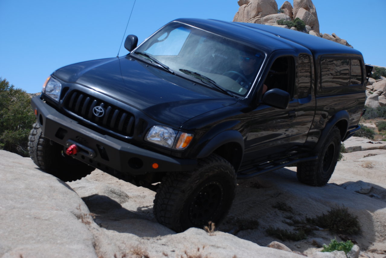

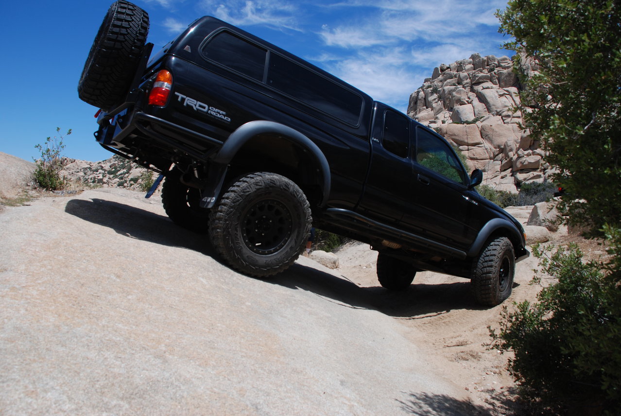

    Specs
    2004 Black extra cab V6 4wd w SR-5 TRD w e locker 190k so far
    Mods
    Armor
    Relentless offroad Summit front bumper
    Allpro sliders
    Budbuilt skids ifs and trans
    Cbi rear high clearance dual swing out bumper
    Recovery
    Warn 9.5xps winch
    Warn recovery kit
    Hitch reciever w dring
    48" highlift
    Driveline
    Nitro 4.56
    Harrop eaton electromagnetic front locker
    Factory rear locker
    Tacobox 4.7 gearing
    Exterior
    TRS retrofit headlights w halo and daemon eyes
    New grill from Amazon
    Diff breather ext.
    windshield reservoir relocation
    On-board air ARB CKMA 12

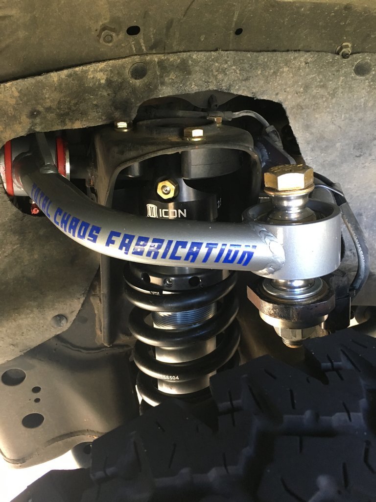

    Suspension 1
    Icon 2.5 coilover 650# 13”
    Total chaos UCA
    OME dakar leafs
    Icon rear vs 2.0 10"
    Suspension 2
    Same coil overs but w 700# 14” coils
    TC spindle gussets
    OME Dakar leaf with AAL
    Daystar eye bushing
    Toytec shackles w ome bushings
    Icon 2.0 remote resi 11"
    Wheelers rear bumps with 1" spacers
    Durobump front bumps
    Front Suspension Set up 3 (Rebuild)
    ICON 2.5 ext travel with reservoirs w/ 700# coils
    Front suspension 3.1
    changed the coils to 650# 14”
    Lights
    Rigid industries ditch spots midnight edition
    Cbi ditch mounting brackets
    Rigid SAE amber Fogs

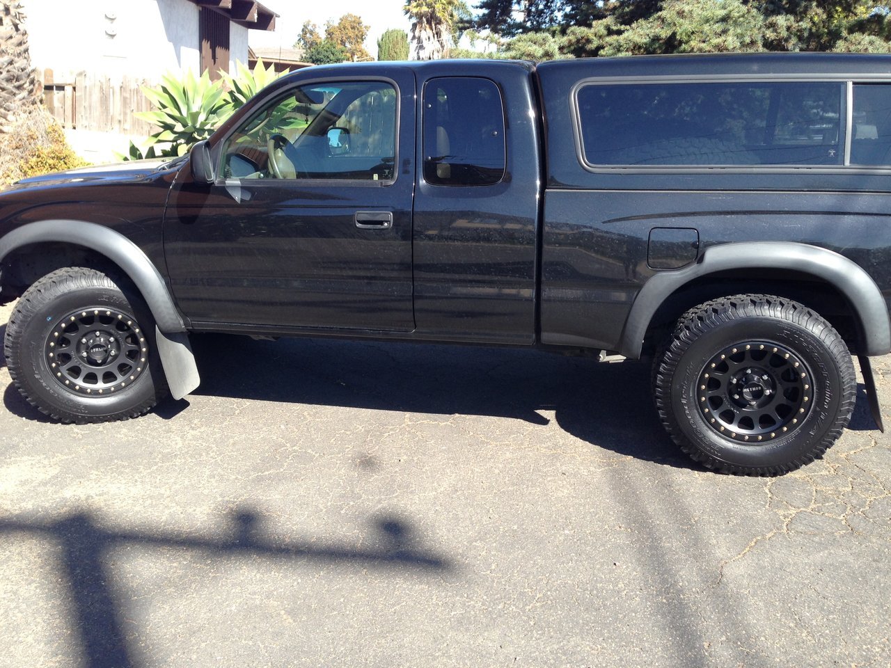

    Wheels and Tires
    Method nv 16x8
    Goodyear MTR 285/75 r16
    Other
    CVT Mt. Reiner
    Relentless offroad bed bars
    Corbeu Baja XRS Suspension seats w/ lumbar support
    Tundra Calipers/Rotors
    Wheelers front brake lines
    Headstrong offroad 26" Rear break line ext.
    ARB Snorkel
    Switch Pro
    Pioneer AVH W4500NEX

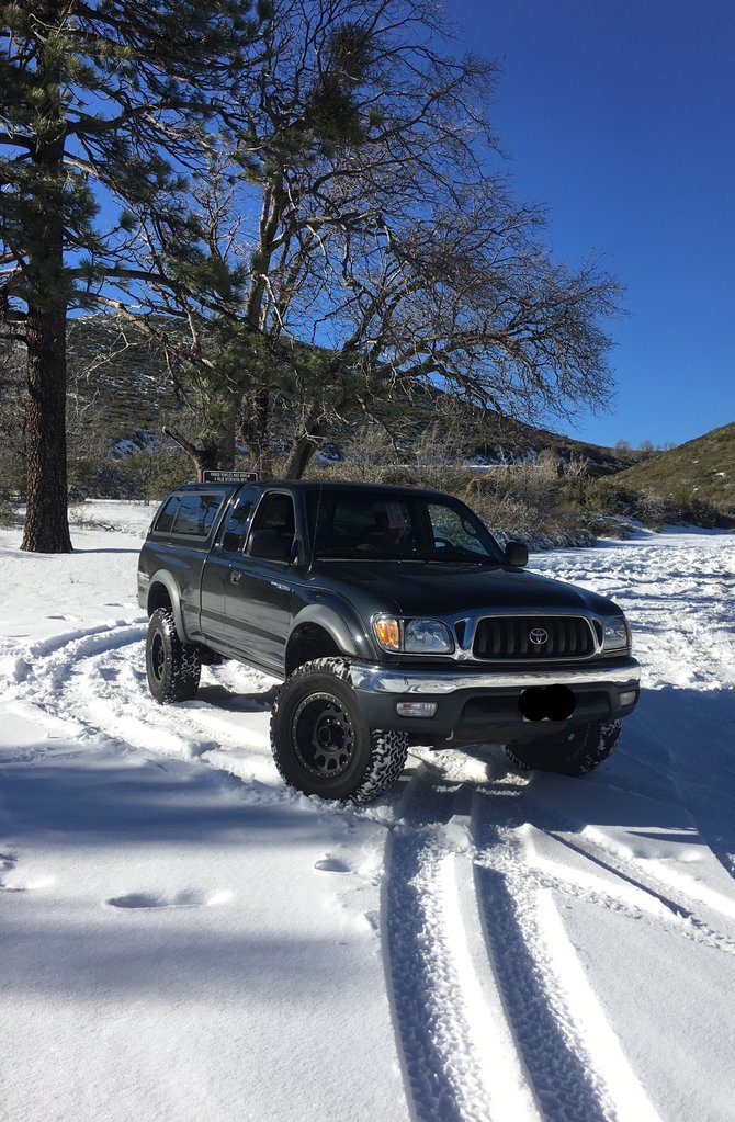

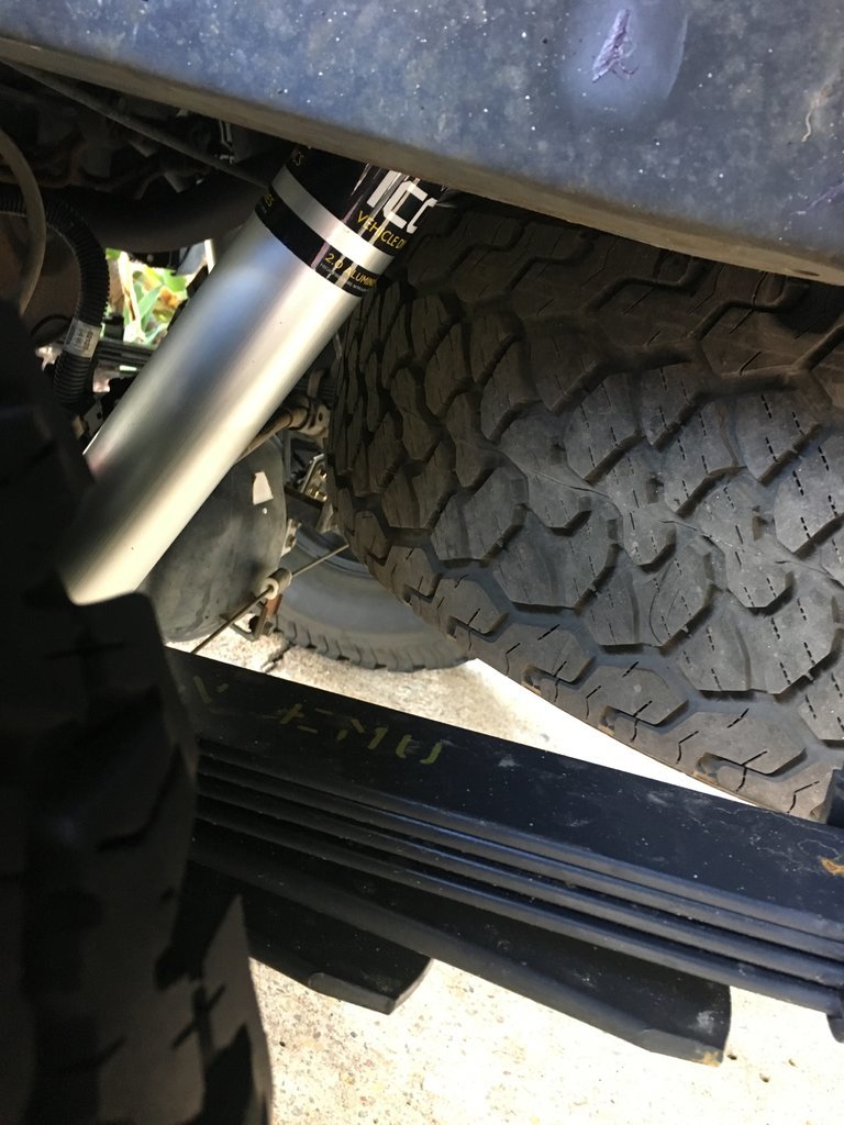

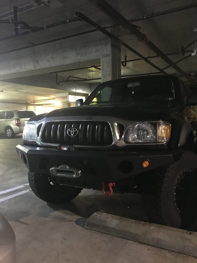

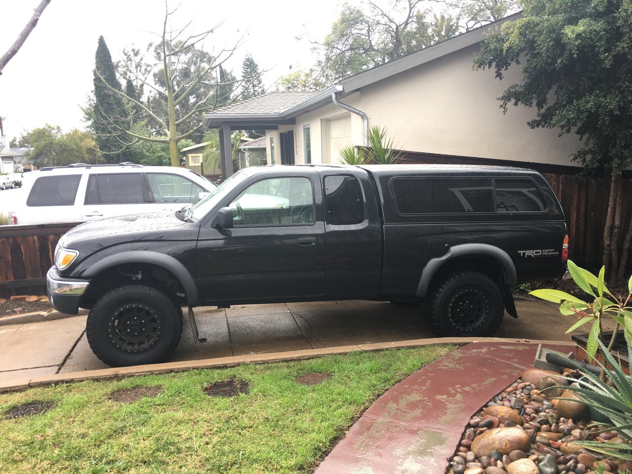

    So in the begining of my build, it started with the wheels, then I kept seeing a ton of yellow powder underneath my seat. I wondered wtf is that? I then looked under the seat and looked at the foam. It seemed to crumble just from me looking at it lol. Not good...that and my back started to hurt from my seats. Even the passenger side was shot. They were old...So I upgraded and these showed up..IMG_4457.jpg IMG_4459.jpg
    My suspension showed up at the same time so...IMG_4524.jpgIMG_4525.jpg IMG_4522.jpg
    Notice it was wet from rain, put the suspension on serendipitously in time to find snow in san diego. So we went for a romp in the snowIMG_4548.jpg
    Love gassing it in the snow...even the wife had some fun doing doughnuts in the snow...how can you not! Suspension was like night n day.

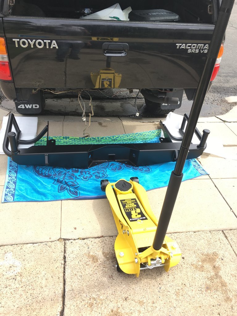

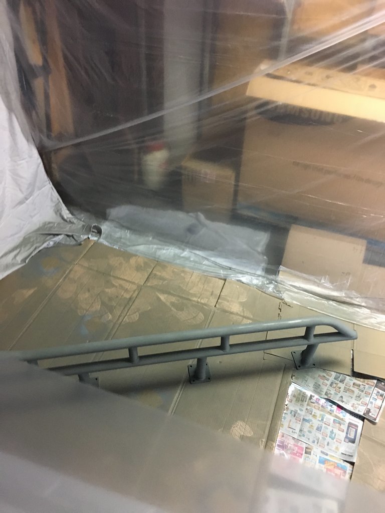

    Then my pallet from Allpro showed up.

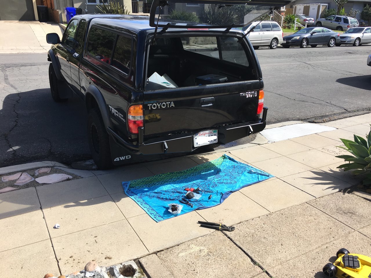

    I really wanted a swing out but settled for the allpro high clearance, till I realized my need for a hitch canceled out my high clearance, I need to use the jetski as I need to surf off it, non negotiable. So...the argument in my head began...in the meantime I began painting my sliders. And installed the front bumper and winchIMG_4593.jpg
    paint n install skids and more coats on the sliders
    Just clear coat to prevent rust
    sanded then primer
    And somehow I dont have a finished pic of the sliders...

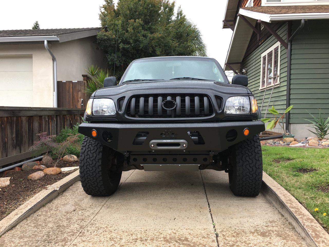

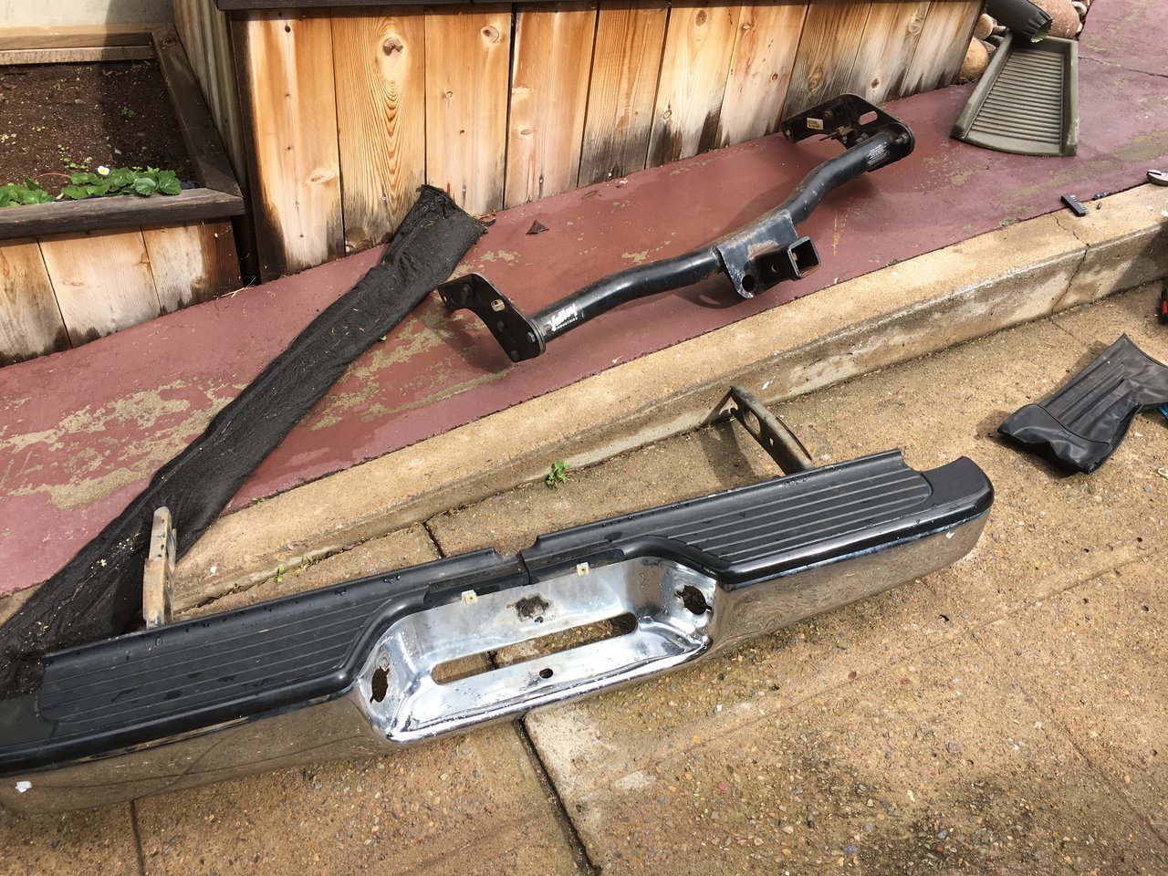

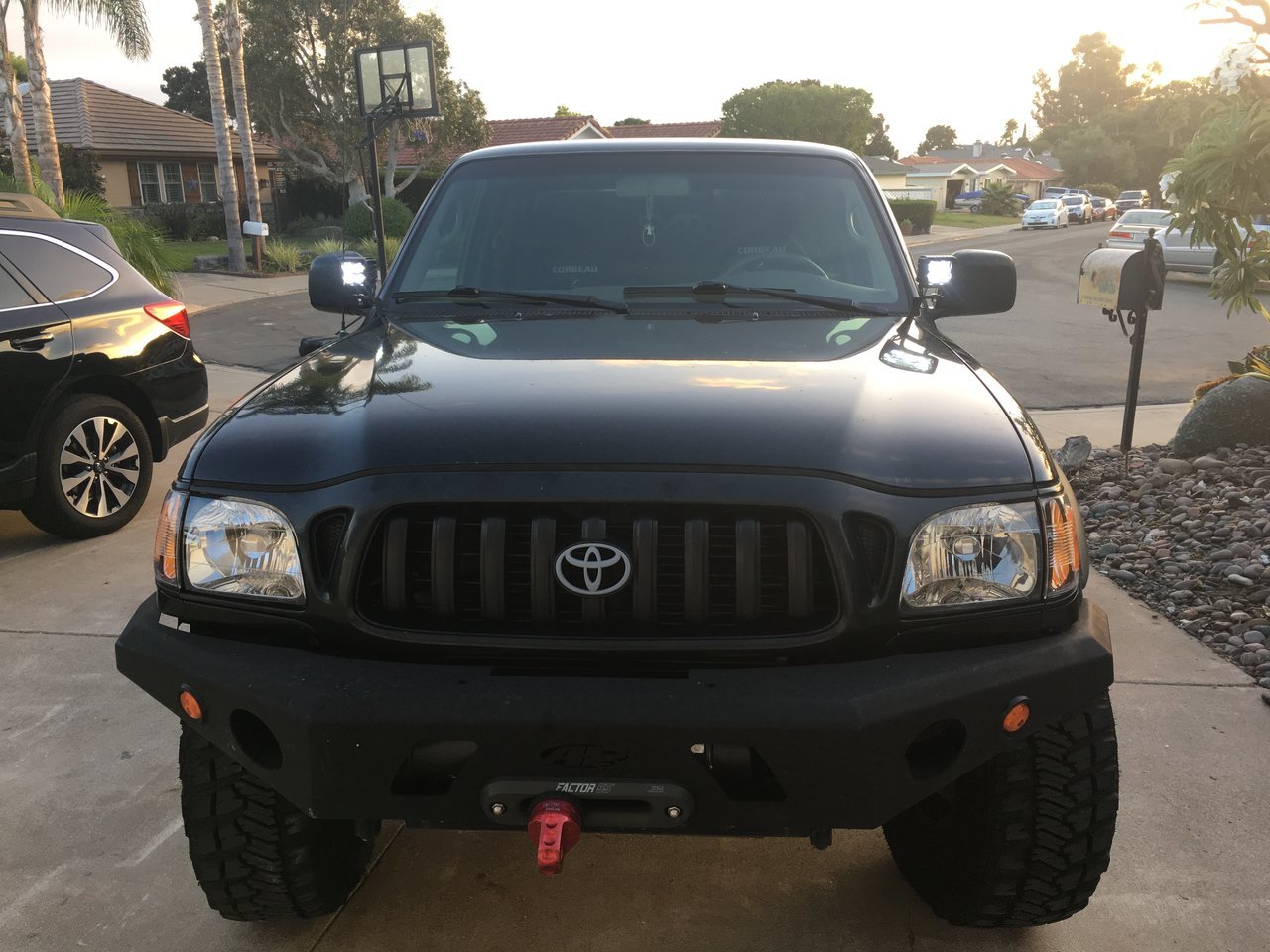

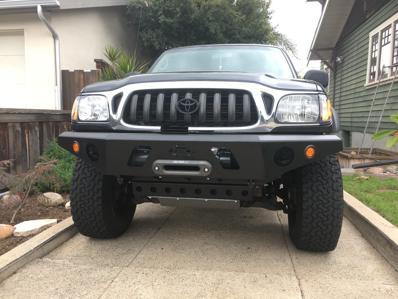

    Made up my mind with the bumper situation and sold this for $100 more than I payed for itIMG_4622.jpg
    I then went to have my sliders welded on and ordered a new grill for $70 off Amazon.
    All black looks way nicer! Still waiting on new winch line at that point. And decided to go with spending an exorbitant amount of money on my rear bumper set up. And also happened on a group buy for a compressor...who likie on board air :kona::bananadance:

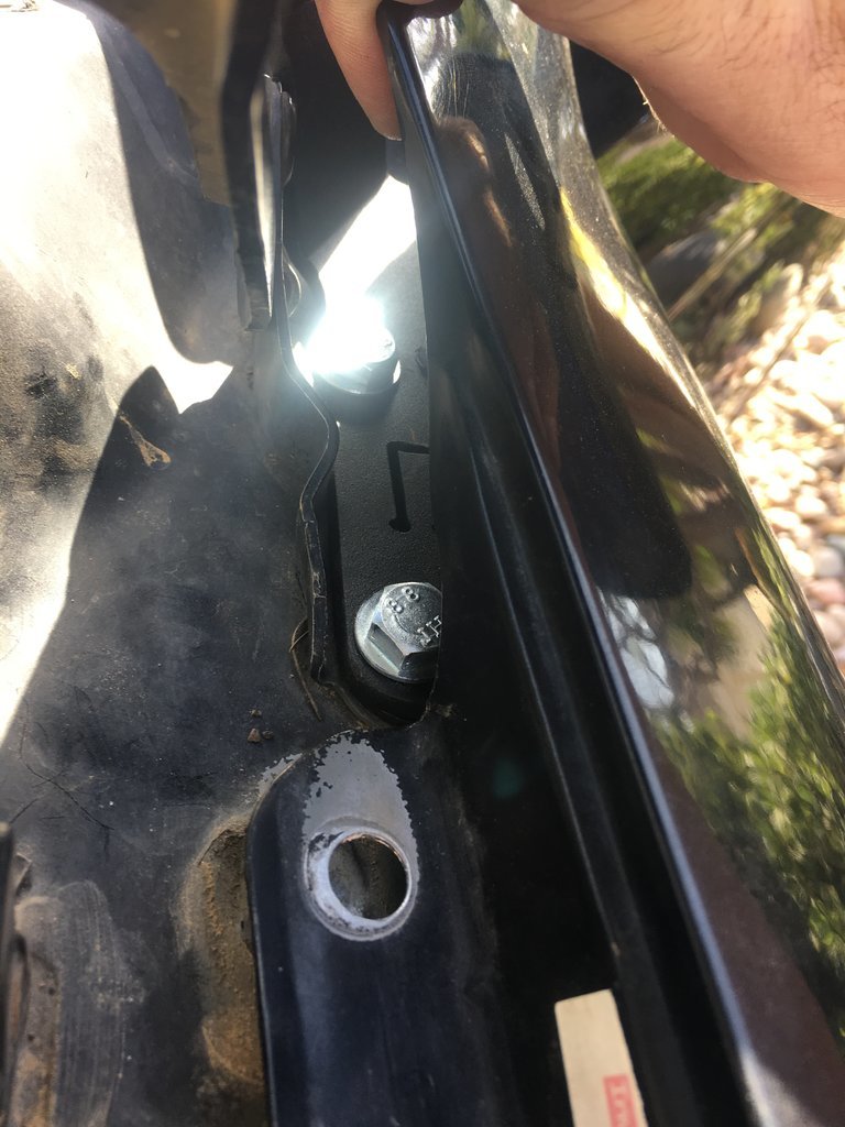

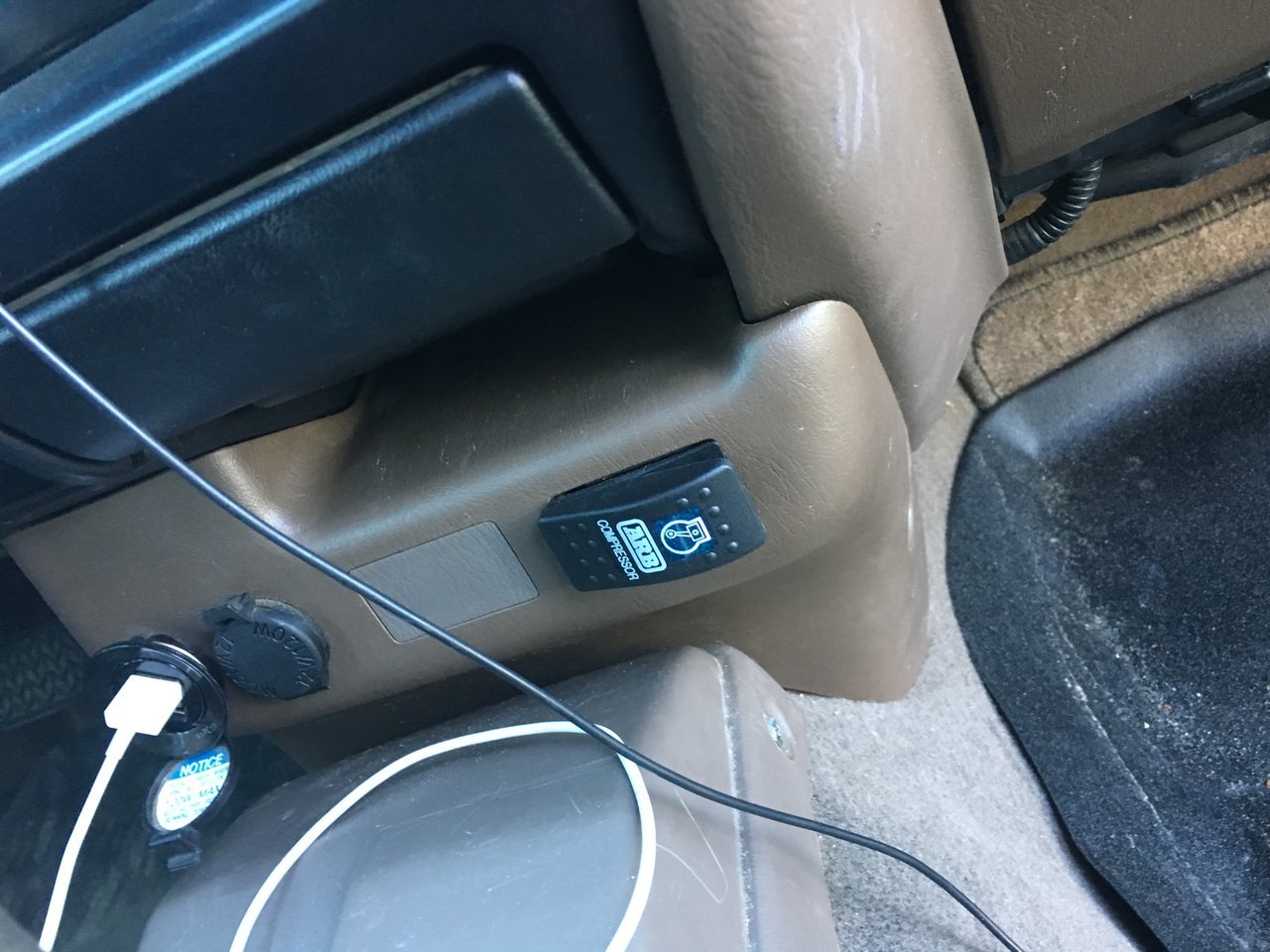

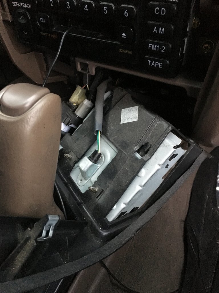

    Followed a build thread on using a cruise control bracket by @tomtom and made it happen.
    It bolts right into the factory pre threaded holes, 04 has that empty slot waiting for an air compressor...took this apart

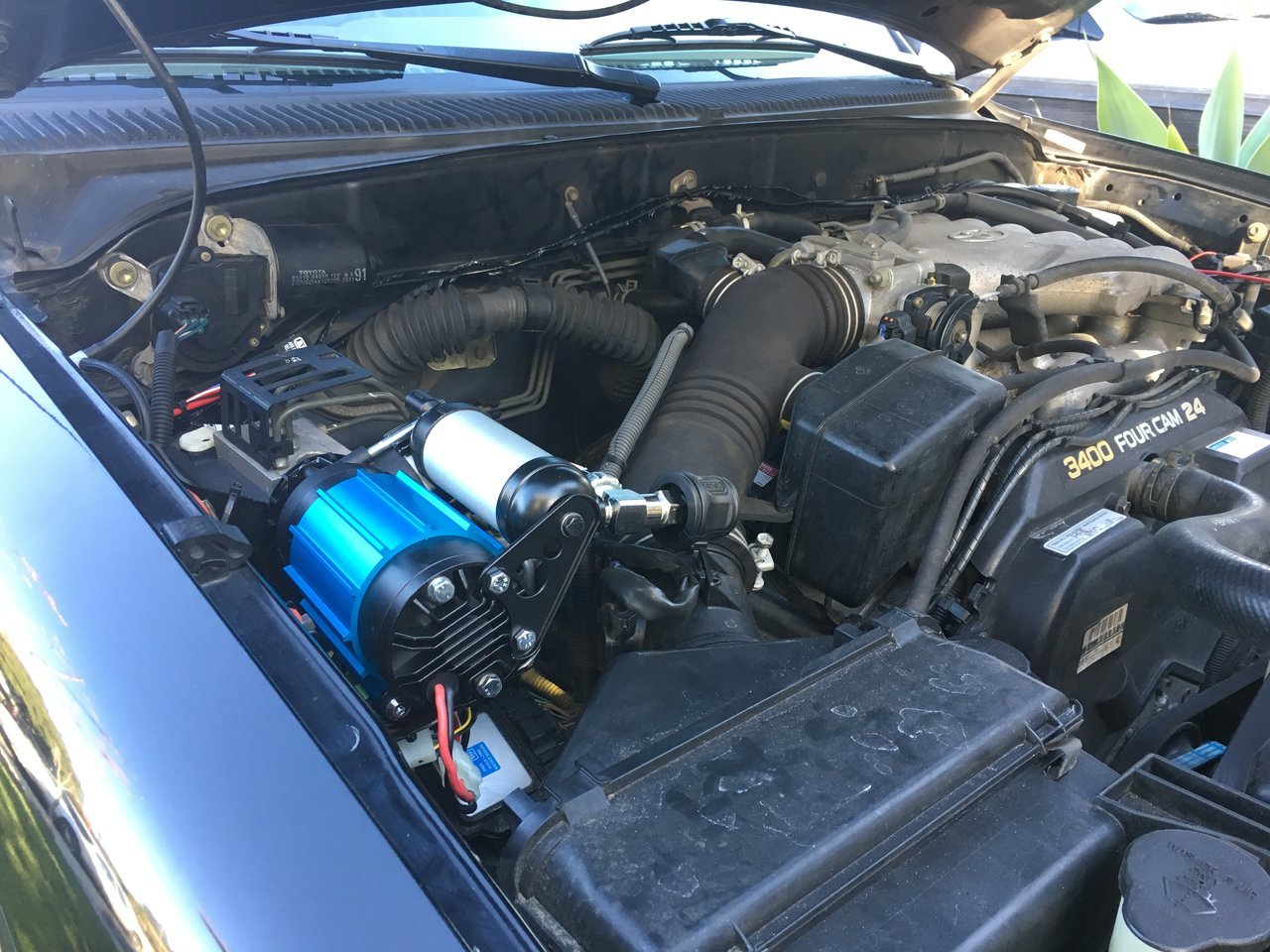

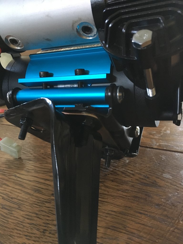

    We got bush! I mean on board air...which is nice...then this showed up
    So I got rid of this shit

    With the control box relocated I preloaded the winch and was ret to get in the dirt, but not before I sold theseIMG_4725.jpg

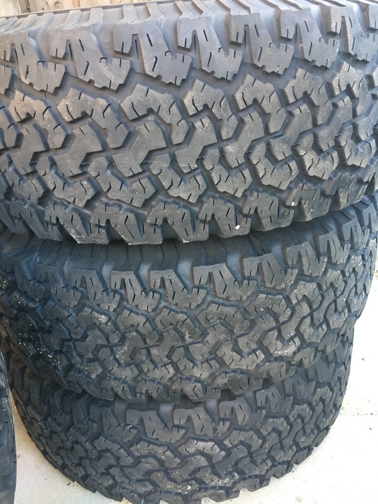

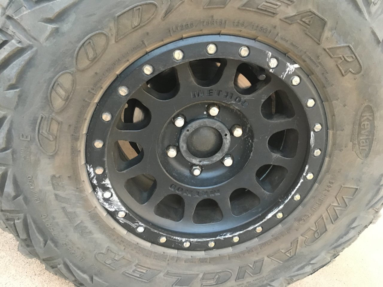

    And bought these...285/75 good year MTR
    You may notice somethings not right about the tread pattern
    :gossip:the tire reads inboard only on the outboard side of the tire:facepalm:
    I took them back after i got em dirty n had them put on the right way...the shop owner looked super pissed when I told him. Sure someone got yelled at. IMG_4741.jpg

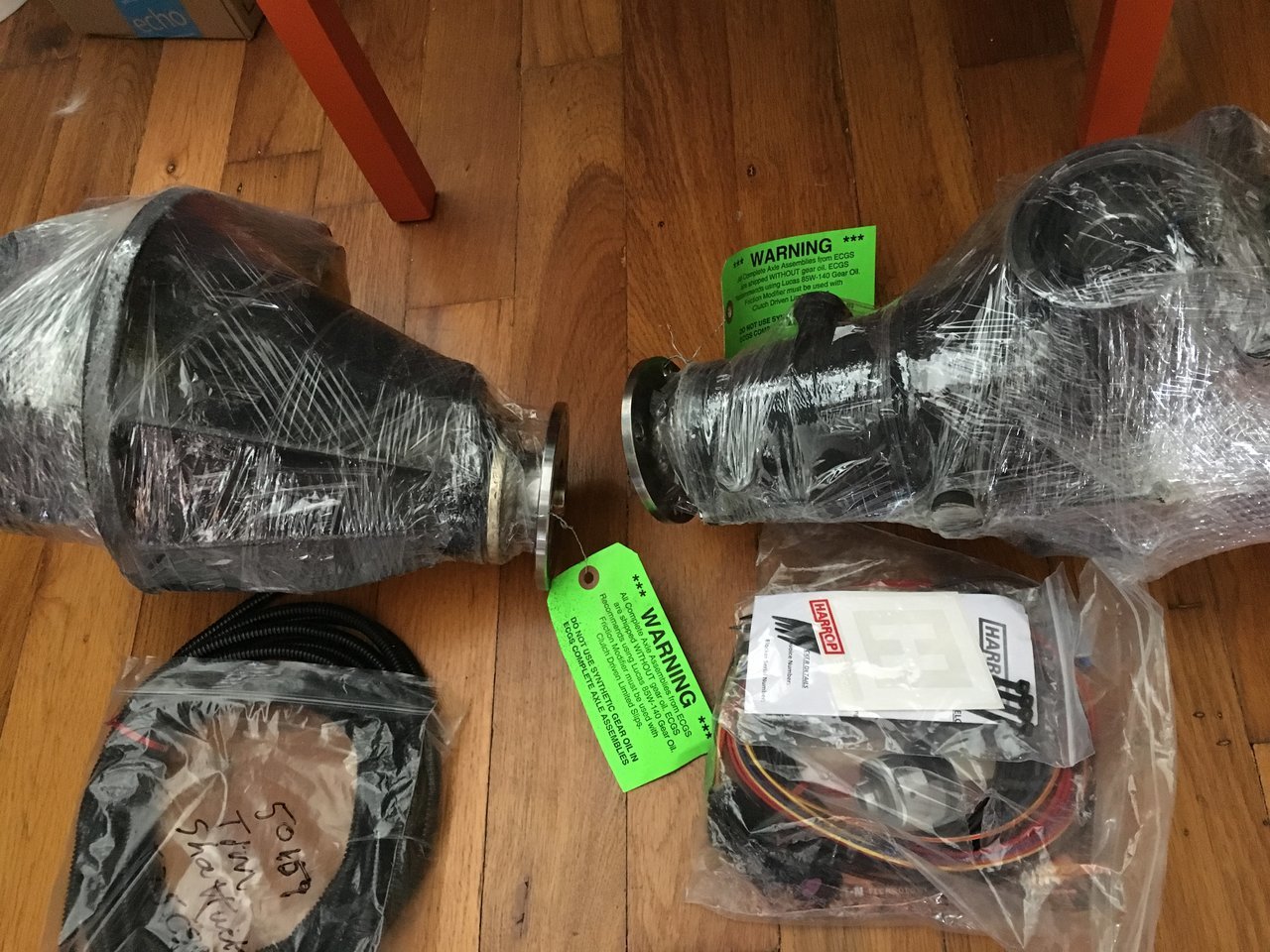

    After driving around on stock gears I realized something needed to change with my gears...i decided on the nitro 4.56 and figured if Im gonna open em up...lets throw a front locker in there...called up ward and got a front harrop eaton electromagnetic locker, called up @ECGS and they said they could instal it for me for a more than reasonable fee, I said yes and gave them my cc info. These guys are top notch and I highly recommend them! Ward @Cruiser Brothers is awesome too! Definitely good peeps with amazing customer service! So I waited n these showed up
    Super fn stoked! After being scared on an uneven driveway and being too much of a vagine...i was recommended to speak with justin at progears in san diego. Dude was super cool and since I had the gear oil n everything he swapped em in for $300...yotamasters in corona wanted over $500...then there was much rejoicing and after breaking em in, went wheelinIMG_4985.jpgIMG_5023.jpg DSC_1957.jpgDSC_1972.jpg DSC_1946.jpgDSC_2010.jpg DSC_2024.jpg

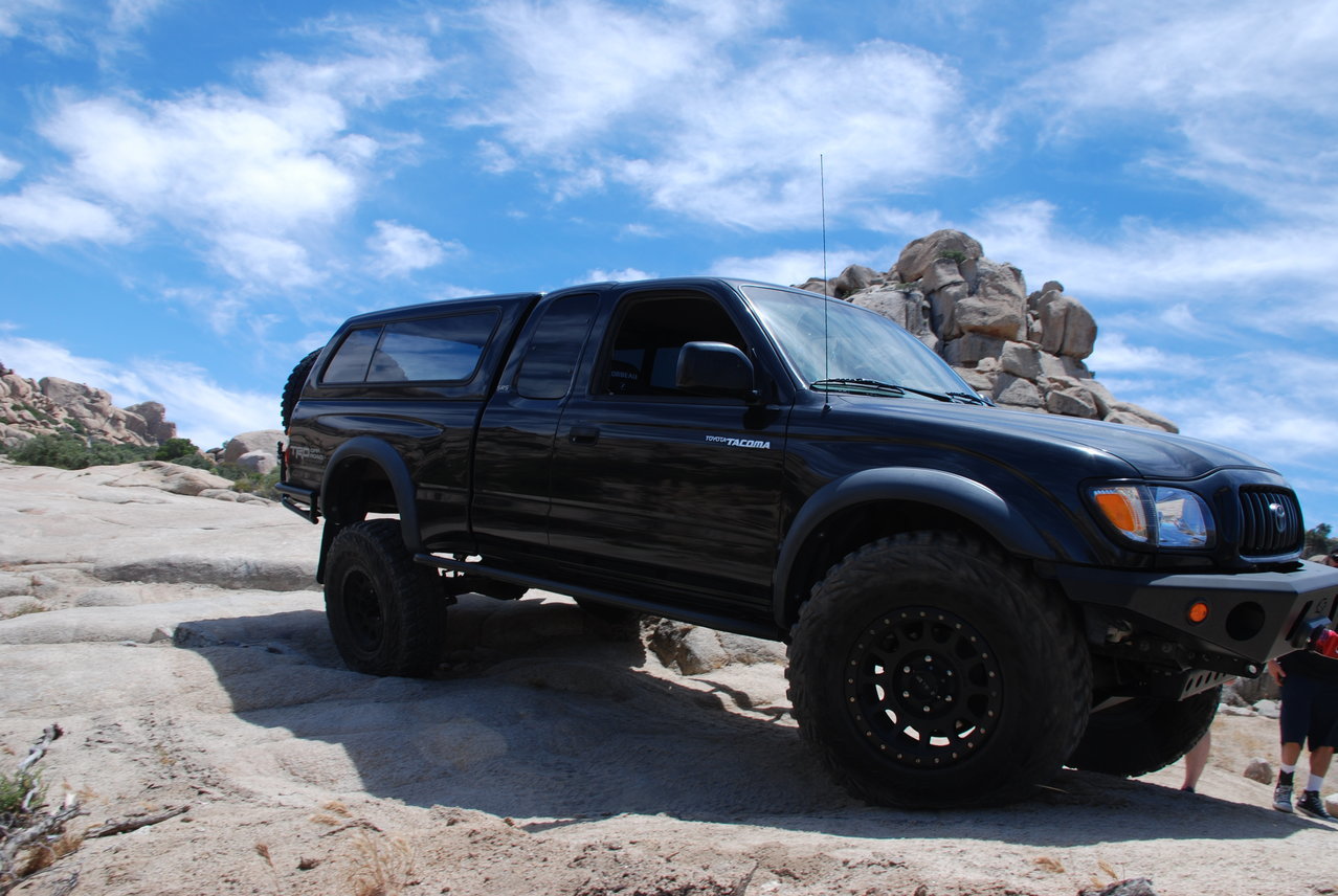

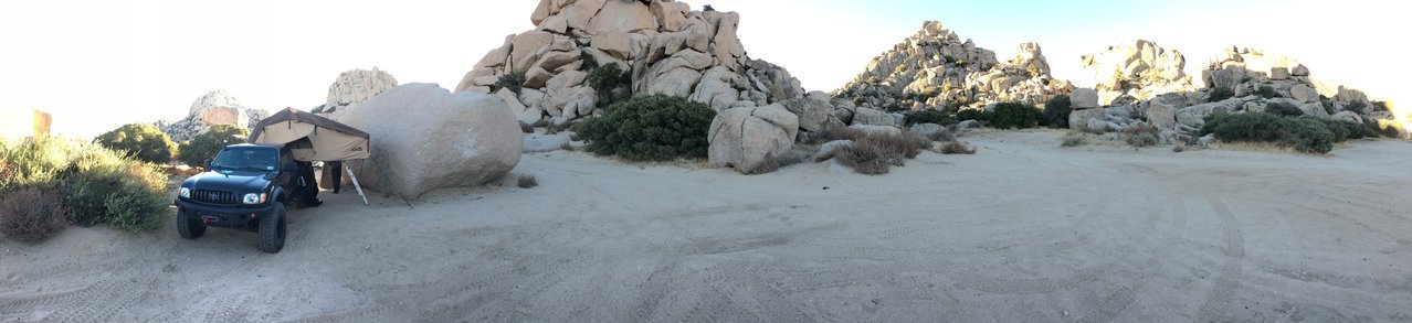

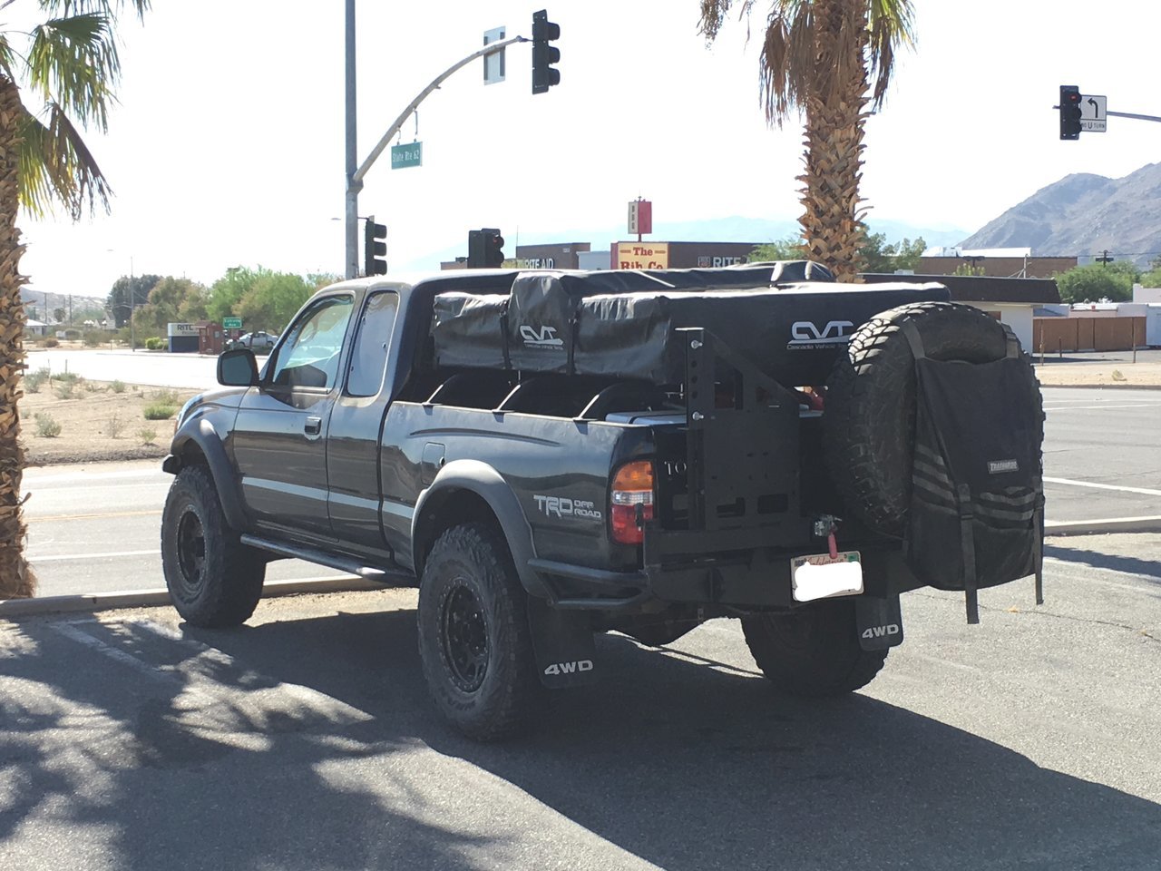

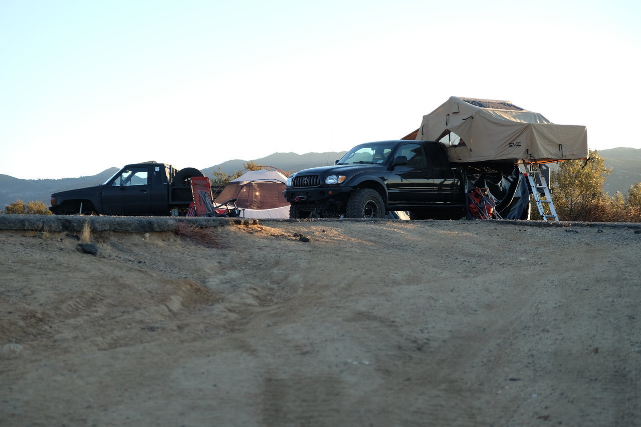

    This whole time I had my eyes on a cvt tent but my shell was only a year younger than my truck and would not support a rtt...i didnt really wanna spend the money on it at the time so I was gonna put it off then TW strikes again...Group buy! Shit I just bought a tent :annoyed:wait I just bought a tent:bananadance:
    Since I definitely couldnt afford a new shell and rack...I was thinking bed bars n started reading a lot of threads n other peoples builds...after fear of rolling and many questions later I asked @Blackdawg how he liked his bed bars n who made em. I was debating having a local shop do em, if I waited a month I coulda made em myself with @YotaGurlIAm at @YumaTRD place...oh well, glad I copied Monte's rig because those bed bars are sweet, a little bulky but legit. I wanted to go low profile and keep the weight from being too high up on the rig. Sorry for being a copy cat man...n then these showed upIMG_5223.jpg
    :bananadance: Lets go camping bitches! But it had to wait as I was moving and money was rapidly dwindling...about a month later got invited to Joshua Tree to check out the meteor shower and said I need to get the tent on, its too fn hot to sleep in the shell... @eccracer104 showed up n helped me take the shell off and install the bed bars n tent... IMG_5298.jpg IMG_5318.jpg IMG_5303.jpg
    Cant wait to really put it to use camping on the trail for multiple days

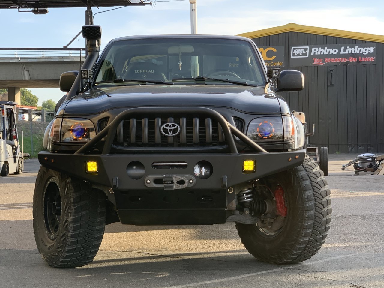

    After a few night trips I realized I needed some additional lights, and eventually maybe new headlights...projectors possibly...
    :boom:

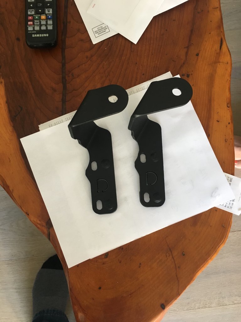

    So I found a sweetdeal again on Amazon and ordered these...
    And these...
    Unfortunately I got dd's instead of DP...:eek:
    Cbi quickly resolved the issue after many a joke, and a fender pulled back
    bang...ditch lights.

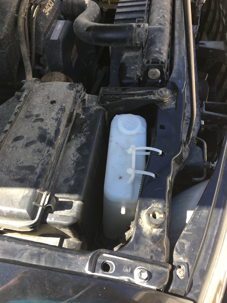

    Love em, and super simple to instal. I had been rubbing on my windshield washer reservoir and had enough. Bought an 89-95 yota windshield washer ressy and swapped....used a whole saw to cut out a spot for my sensor and put it in...gotta work on the mount but it held with no issues the next day on a pretty rough trail called bronco peak which I actually used my reservoir to clean my windows so I could see mo betta...

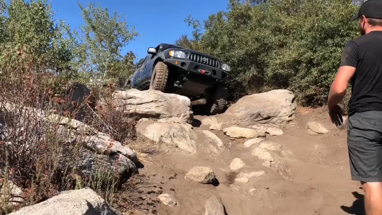

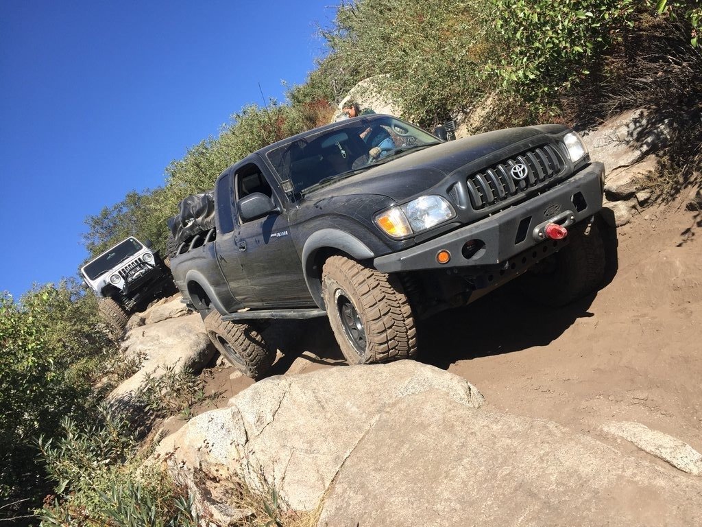

    Not my truck but was a sweet v notch we slid through... @desertjunkie760 showing me the way. And cause I got to winch him off this little pepple you see me on below
    All the armor was put to the test, and took the beating saving me from serious body damage, all my armor was schratched(ie what theyre meant for). The trail just ate up one of my method's center caps...good thing I had a spareIMG_5505.jpg
