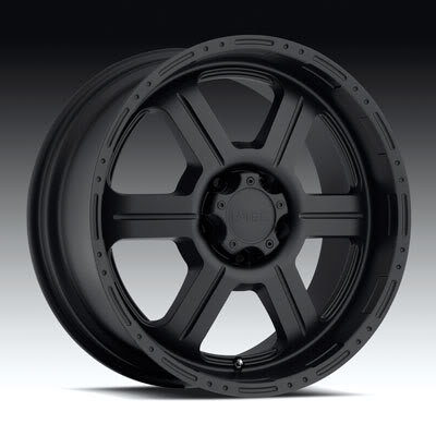

    V-Tec Offroad 326 Wheels (pics below -sorry for sizing - couldn't reduce)
    • black
    • 17x8.5
    • offset +18mm
    • Centerbore 106.2mm

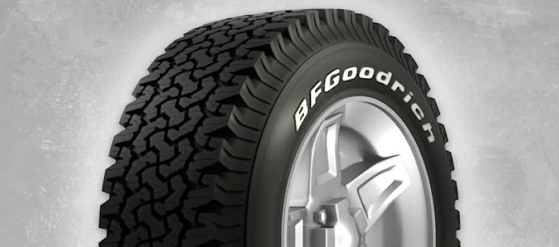

    BFG All Terrain KO Tires 285/70/17

    You will need wheel spacers. I'd find a different wheel with better specs.

    What specs would I need and what spacers? Thanks!

    On a 17x8.5 rim, you'd want backspacing around -6mm (as opposed to +18mm)
    That's a full inch less backspacing on a rim of identical width.
