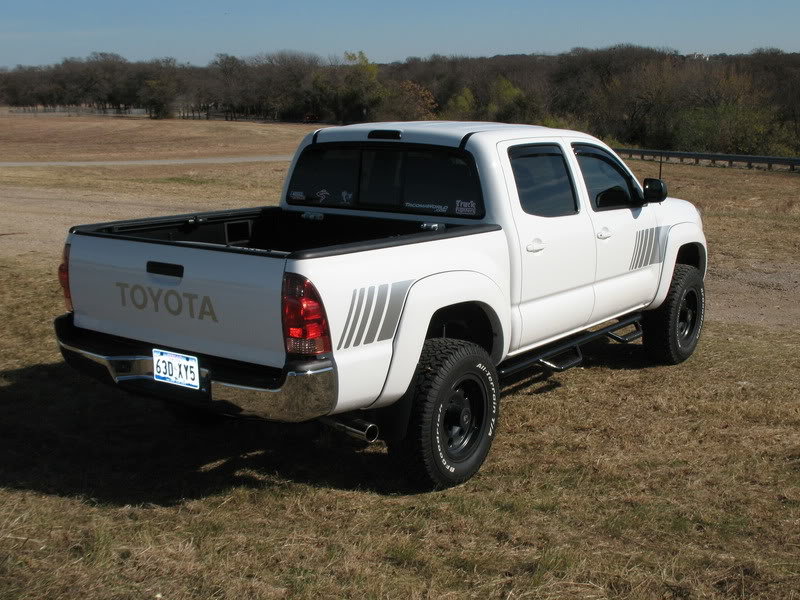

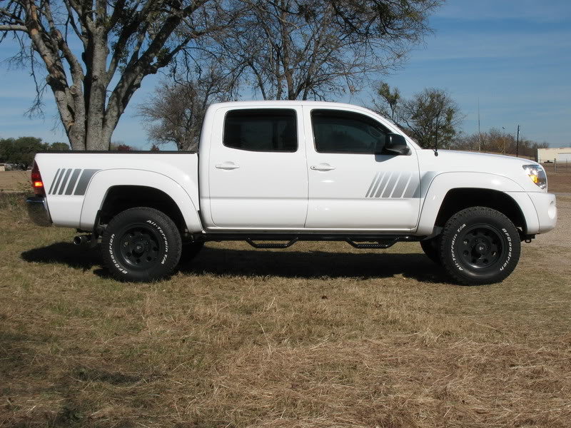

    i have 5100's set at 1.75" in front.
    TSB springs in rear that have settled too much for me, so i put in a 1" block a couple weeks ago to get the rake back (and keep the headlights from pointing skyward)

    n-fab
