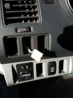

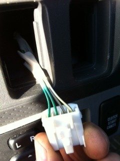

    Went to install a factory fog light switch in my 05 sr5 for future installation of fog lights and came across this plug behind the switch delete:
    are the trucks without fog lights wired for fog's? or is this plug for something else? I didn't trace the wires but i did double check under the hood and did not see any pig tails coming out of the head light harness :confused:
  2. Aug 28, 2012 at 4:18 PM
    Hossdawson
    Hossdawson Well-Known Member
    Jul 15, 2012
    #82679
    230
    Hoss
    Harrisburg, Pa
    2025 TRD Sport Underground
    My 09 was. Just needed the switch, lights, and a relay.
  3. Aug 28, 2012 at 4:41 PM
    nj636
    nj636 [OP] Hub Master General
    Feb 14, 2012
    #72804
    5,389
    Kev
    Jersey
    OME lift 4x sliders 4x skids
    Nice .. I guess i have to look a little better for the fog light pig tails??

  5. Sep 19, 2012 at 12:01 PM
    nj636
    Feb 14, 2012
    #72804
    5,389
    Kev
    Jersey
    my truck is not pre wired for fog lights. the pigtail i found is the wiring for the locker which my truck does not have :mad:
    i used a pick to get the blank out..
