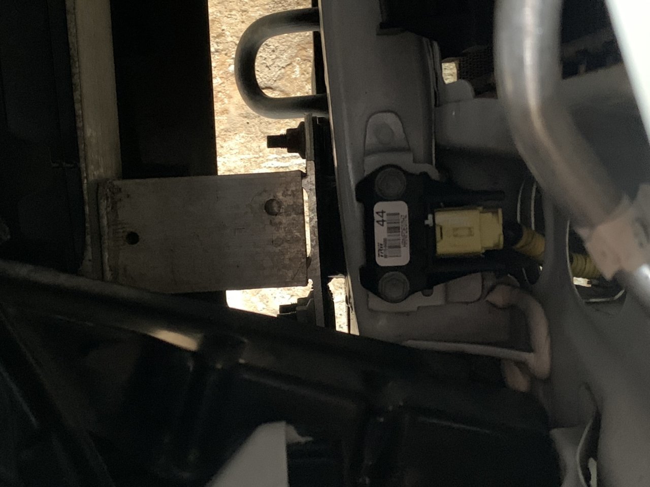

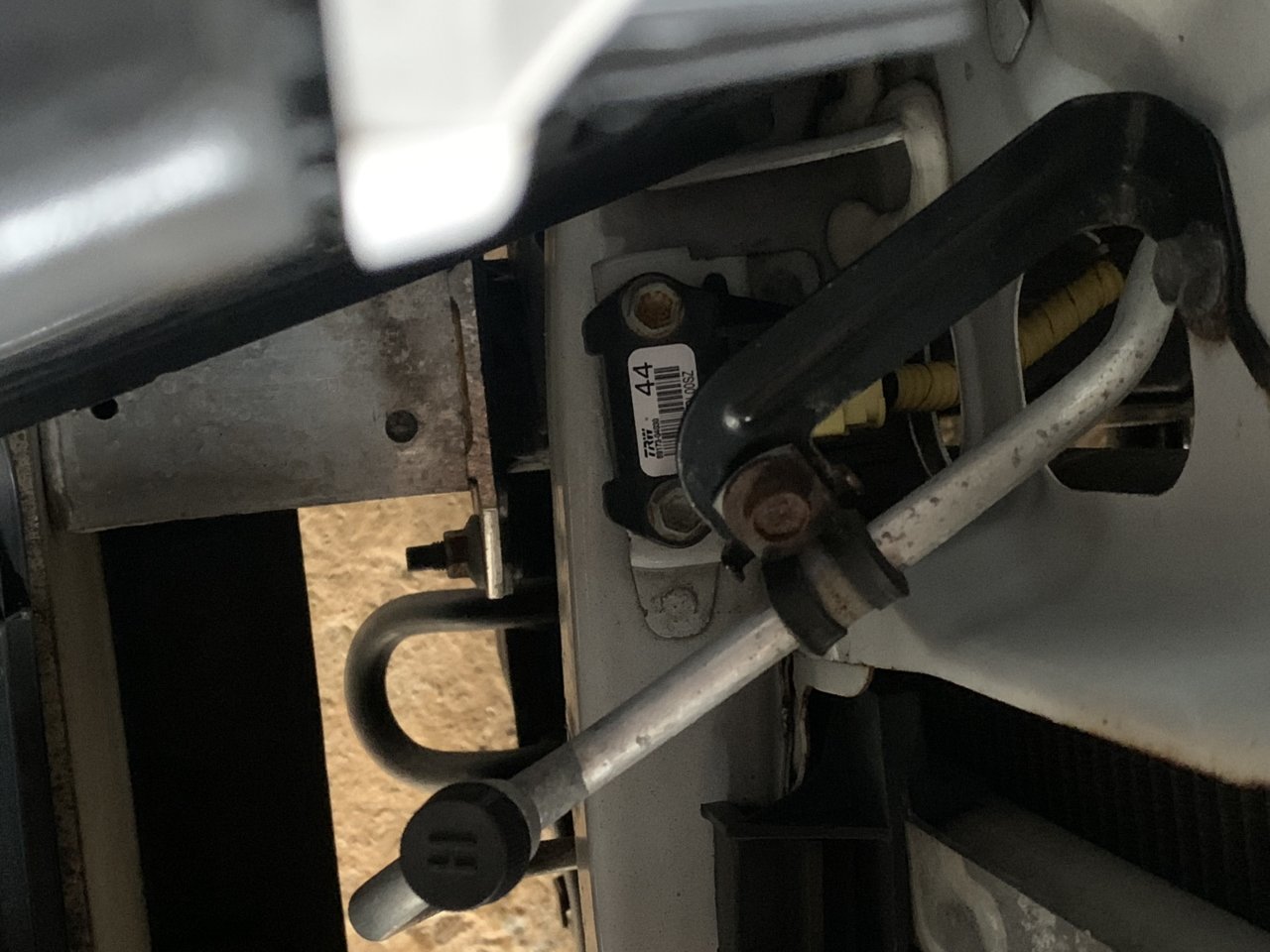

    Anyone know what these wires are for? They’re right behind the front bumper. Maybe fog lights? I know for some Tacoma’s the backup camera comes pre wired and you just add the camera, is this the same deal?

    Are you talking about the yellow connector? That’s plugged into your front crash sensors. That deploys your airbags in a frontal impact.

    Oh, thank you. I though they were just held in place there. There was two of them so I just assumed it was fog lights

    No problem. For a reference, usually anything with a yellow connector or in a yellow sheathing is airbag related.

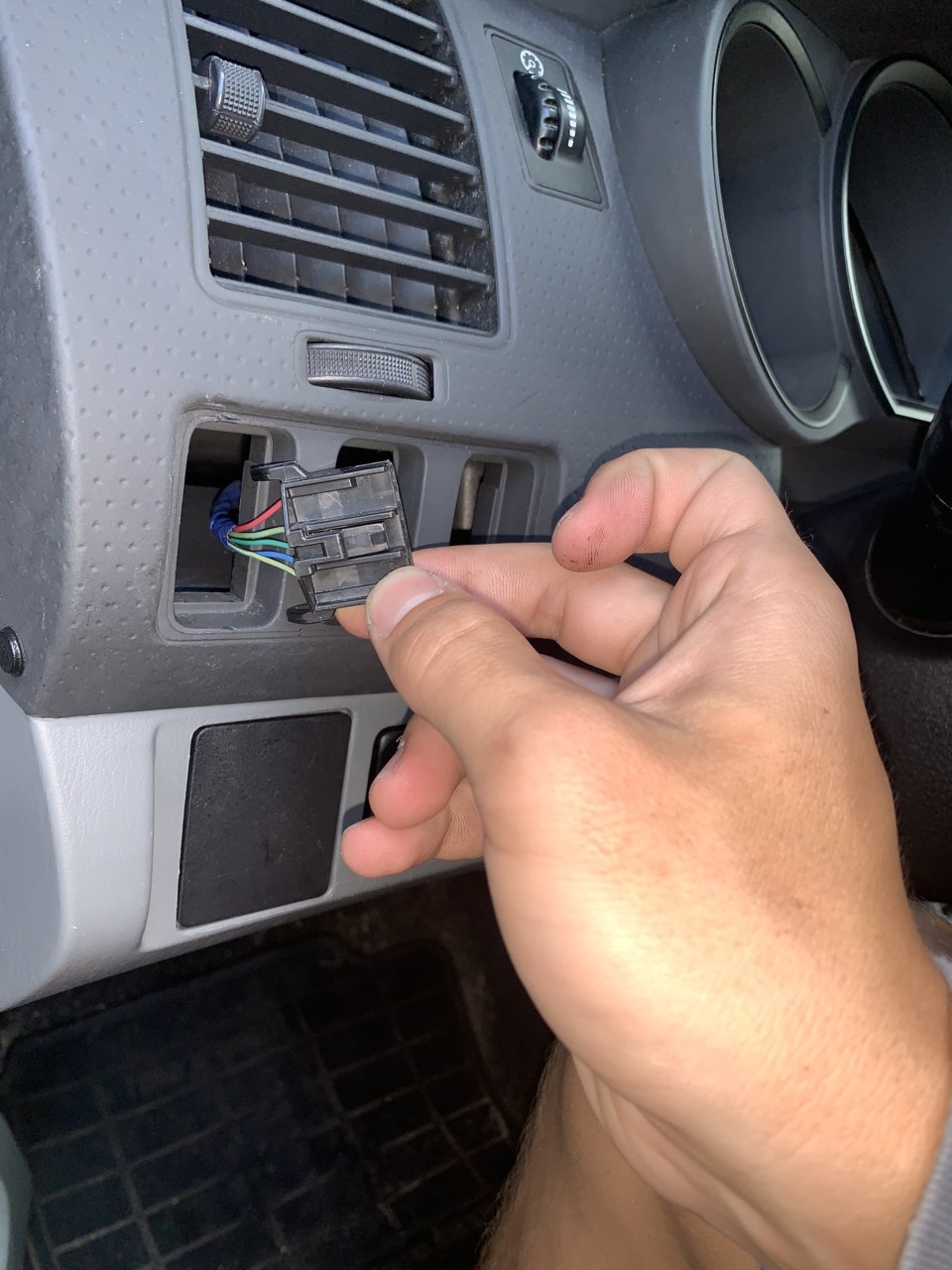

    Does anyone know what this wiring is for? I have a 2015 base tacoma, it seems like it should be for fog lights but i cant find any other wiring under the hood
