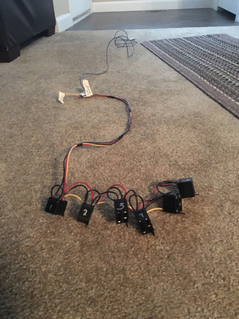

    Built my harness this afternoon thanks again for all the help.

    Looks good!
    Which of the terminals did you end up using?
