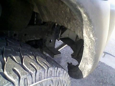

    Here's what I experienced when installing the new 285's: Had to do a fair amount of trimming to both the inner well and fenders. Also had to remove the front mud flaps. Found that a good utility knife cut through everything easily. I got out the recp. saw, but found it was not needed.

    Here's some picts of the trimming I had to do to my wheel wells-

    Im running 285-65X18 Nitto dunes. I run them at 45 psi. and I did alot more trimming on the front than that! I cut out that entire vent thingy thats on there and Im thinking about cutting a little more out.

    here are the pics of how much of the inner fender I had to cut out and I still have rubbing issues when wheelin.

    WOW, I thought I had to hack away a lot of plastic! you win!!:D
