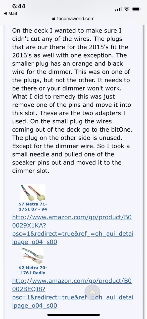

    I’ve ordered the Metra adapters. Isn’t there something you have to re pin? If so, can you explain what you did? Thanks.

    Cut and splice to the adapters. It's plug and play from there. At least that's what I did and it worked.

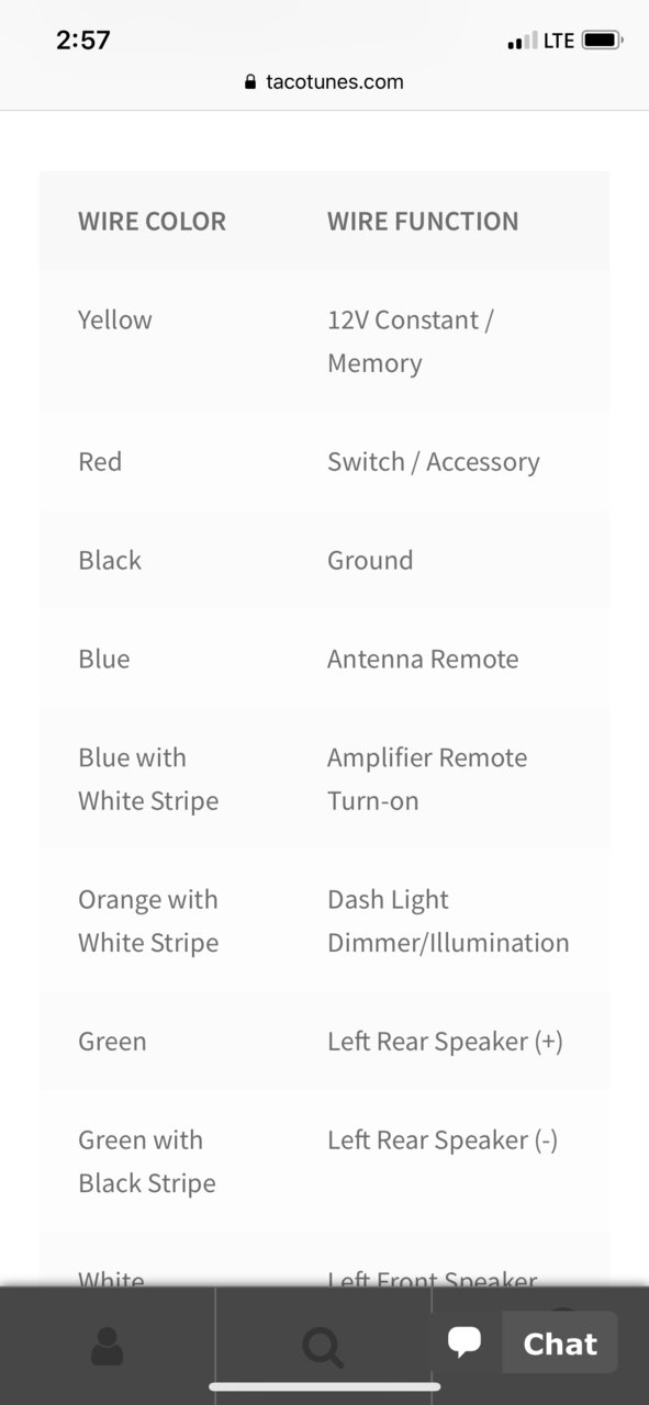

    Check this post. Care to see if your dimmer works for me?

    Dash lights and radio knobs both work. They don't shut completely off but I'm not sure they ever did ...

    Is that the orange wire in this harness?
    https://*********.com/wp-content/uploads/2016/06/Sound-Processor-Wiring-6-Pin-NON-JBL.jpg

    Too late it's installed. Not sure

    Did you create the harness or the Best Buy installer you mentioned in another thread? I’m only asking because maybe he pinned the harness if he made it. If you did it and didn’t use it, I’d rather prefer your method than switching pins around.
