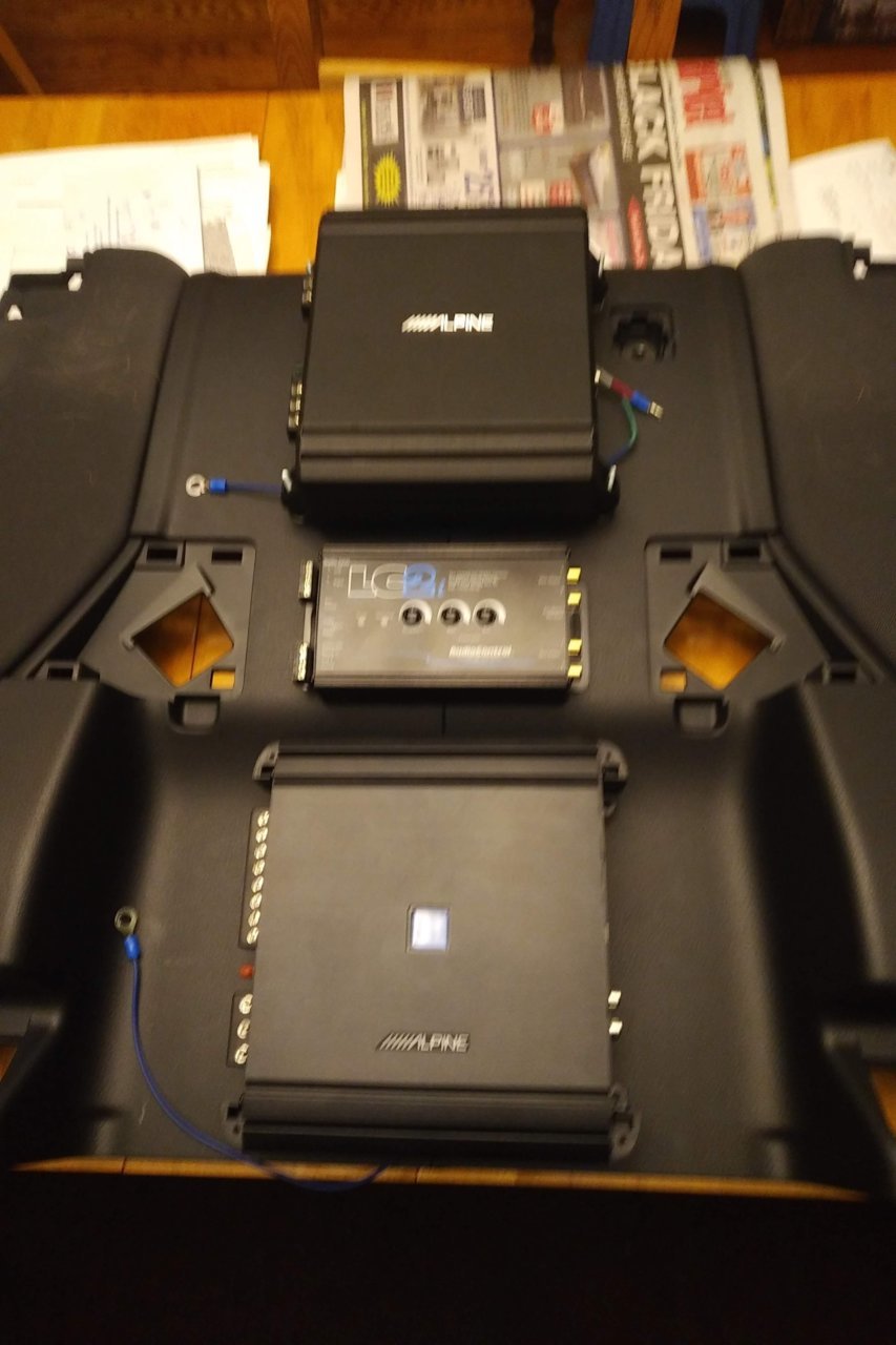

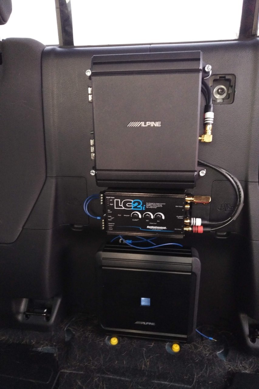

    Your not wrong. On that note, this is what I've been working on. Not wires yet, just mounted so far. Infinity speakers installed the year before all around. Will have a pair of Infinity 6.5" subs installed under the jump seats(not built yet).

    The top Alpine amp is for the 2x 6.5" Infinity subs rated at 150w @ 4ohms. The lower Alpine 4x channel amp is rated at 50w @4ohms. I will be powering all 4 speakers the same using the front channel and the rear channel will power a set of Bose tweeters mounted in the upper corners of the rear panel. The sound processor will split the audio so I get low level audio to the 4x channel a MP and a sub channel to the sub amp. I know this might seam extreme but I appreciate good quality tunes. This has been a slow project for sure. Was hoping to finish up this year but it has been delayed due to other priorities. To answer your question, I might have about $1500 wrapped up in all the stereo equipment but I prefer to do this mod myself instead of paying someone to do it. I do acknowledge that this build is beyond the context of this thread but I though I should explain where I'm coming from.

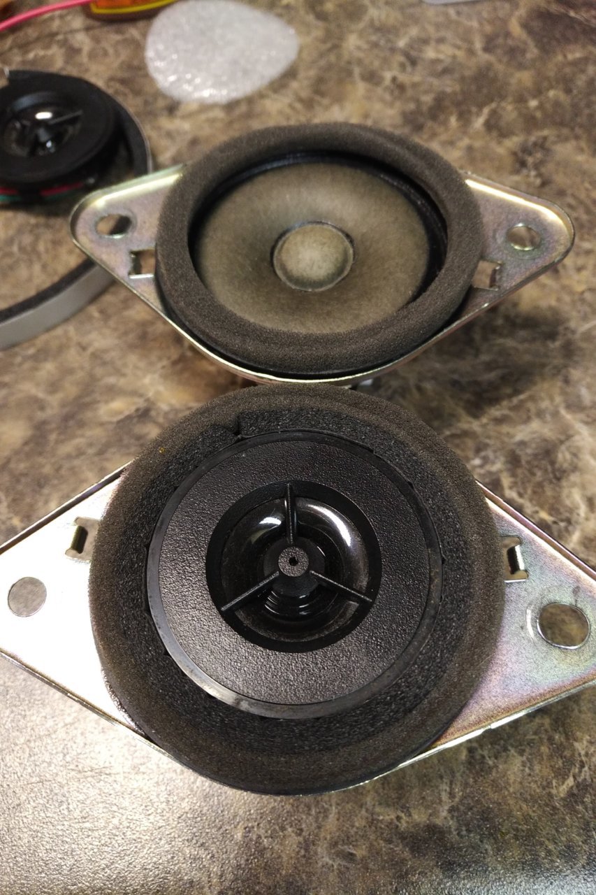

    In compliance with this thread, this is the front tweeter mod I did last year. Installed Bose tweeters in the OEM tweeter cage.
