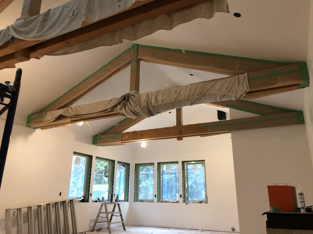

    Drywall all primed
    I'll paint this week and then we can think about interior electrical and plumbing finishes

    This building is not a timber frame , and could only mildly be considered a hybrid. My timber connections are not traditional joinery and in fact when you pare down whats going on structurally with the timber 'trusses' , they aren't even a truss. The only elements that are doing any structural work are the bottom chord 4x12's and the 6x6 post . The timber rafter element of the truss is essentially decorative and just there so the assembly looks like a truss . The conventional 2x12 rafters span from a 3 ply 2x12 ridge beam up in the rafter plane supported on the 6x6 posts out to the exterior walls .

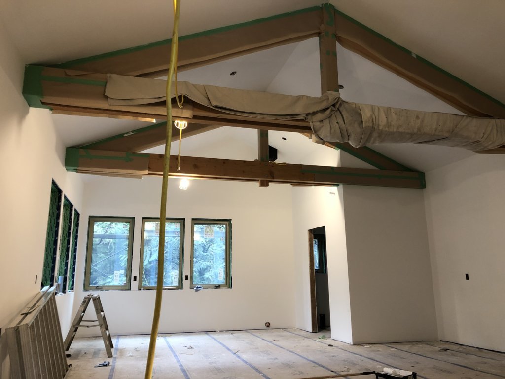

    Just finished up all the painting
    Took a picture but it looks exactly like the priming picture above , you get the idea
    My lights arrived at my electrician's shop today , maybe next week I can get those guys back and have all the electrical finishing completed
    Next up for me I need to make a vanity box for the bathroom so my plumber can finish up then inside is complete as far as services go

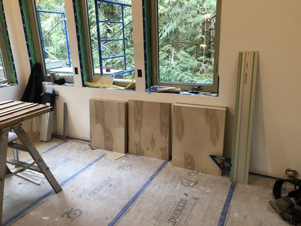

    Today I picked up some 3/4" Birch C2 plywood and started cutting the components for the lower cabinets in the bathroom for the sink and the cabinet that will house the small compressor and hydronic heating manifold .

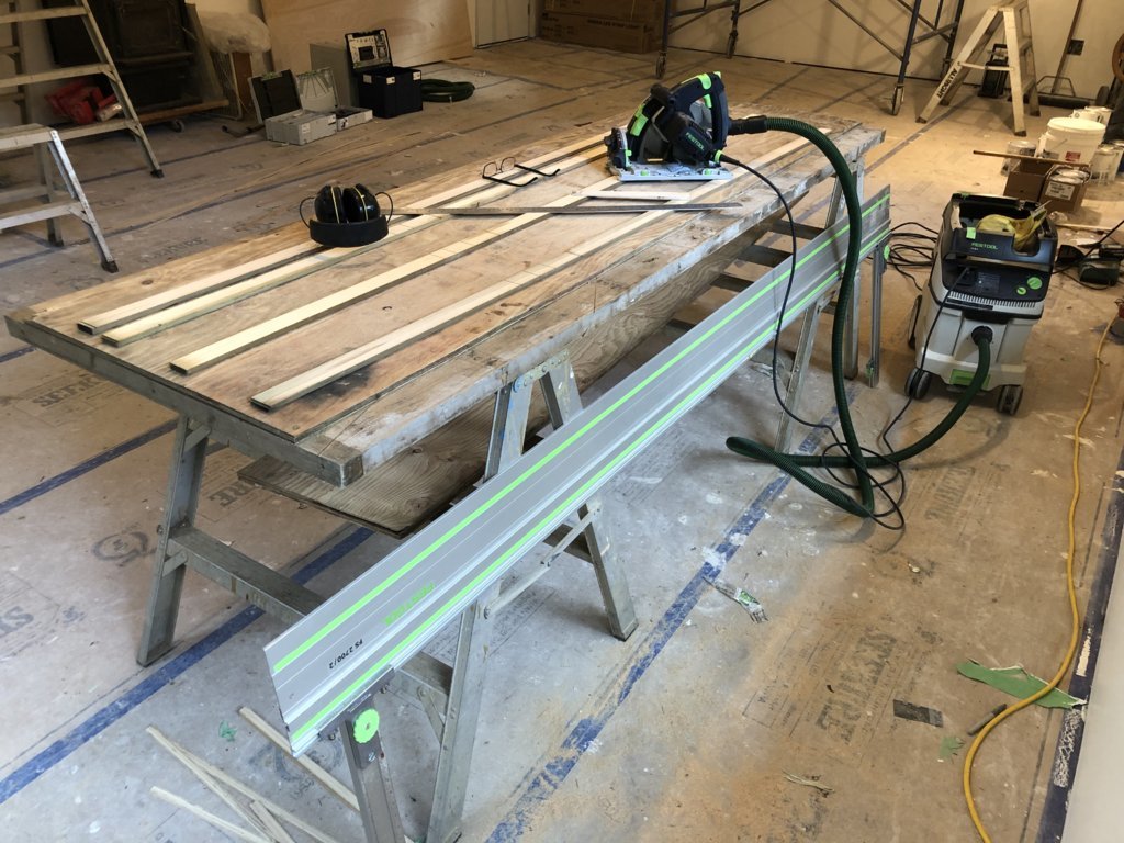

    I decided to try to build it all without a tablesaw so I'm going full TS55 track saw attack , 105" track with parallel guides for ripping and 52" track with the TSO GR16 rail square for crosscutting
    Got sides , tops and bottoms cut , tomorrow I'll finish cutting the rest of the parts and start assembly

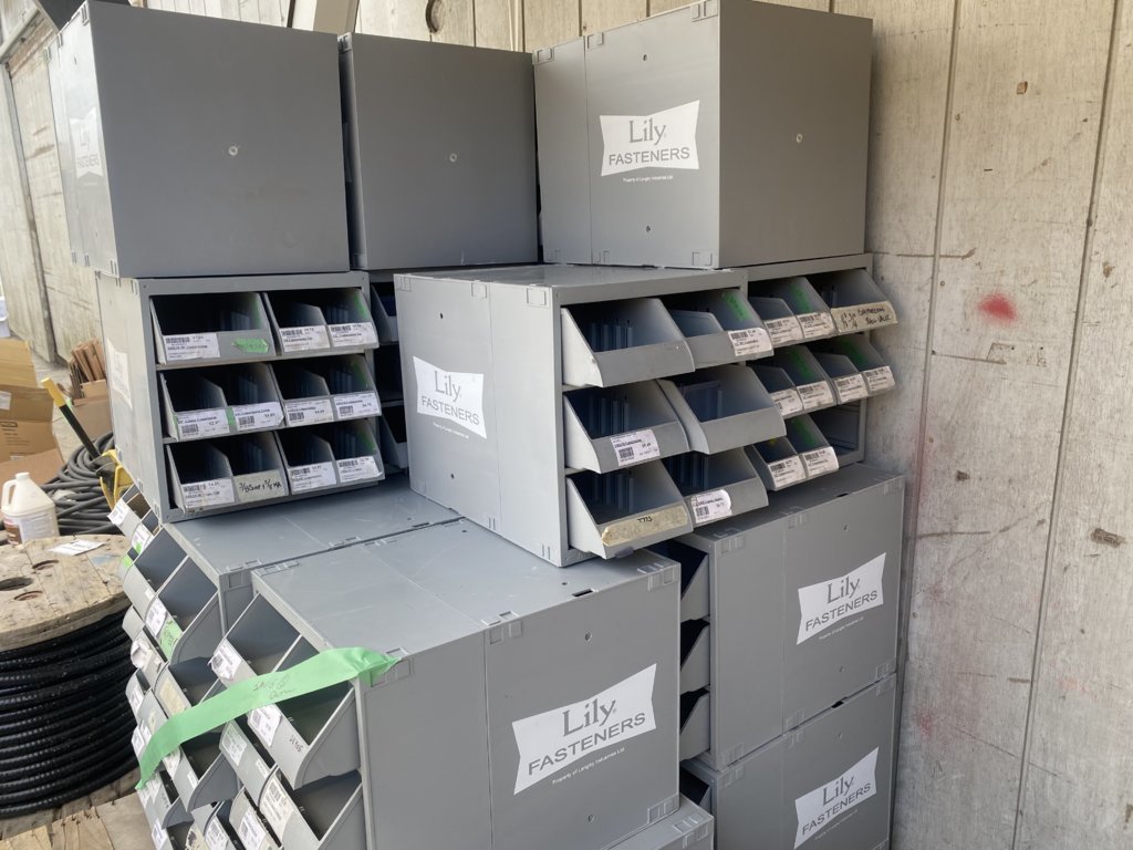

    Other thing that happened today is the tool guy / assistant manager at my local lumber supply knows I'm building a shop and they are changing their store around a bit and he texted me today and asked if I wanted all these metal case / plastic bin fastener cases ..... for free
    Slashaar, AKSig88, Jester243 and 15 others like this.

    SCORE!!!!!

    '96 access cab 3.4 5 spd manual 4X4
    Shop is shrinking even before it's finished! When does the auxiliary storage build part start?:annoyed:

    BONUS! :woot:

    Already built! Has covered outdoor space + a container.

    its still the same size as when I framed it

    What's your opinion on panel saws?

    I honestly think they are a dodo now with the advent of track saws / guide rail squares
