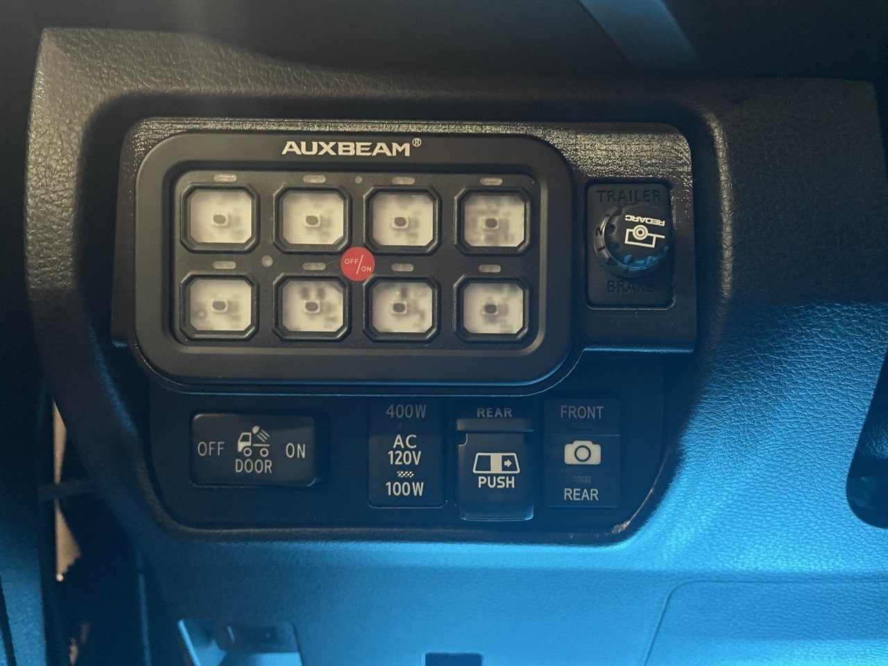

    Redarc controller. Simple install!

    Thanks for the link on the controller switch. That is clean.
