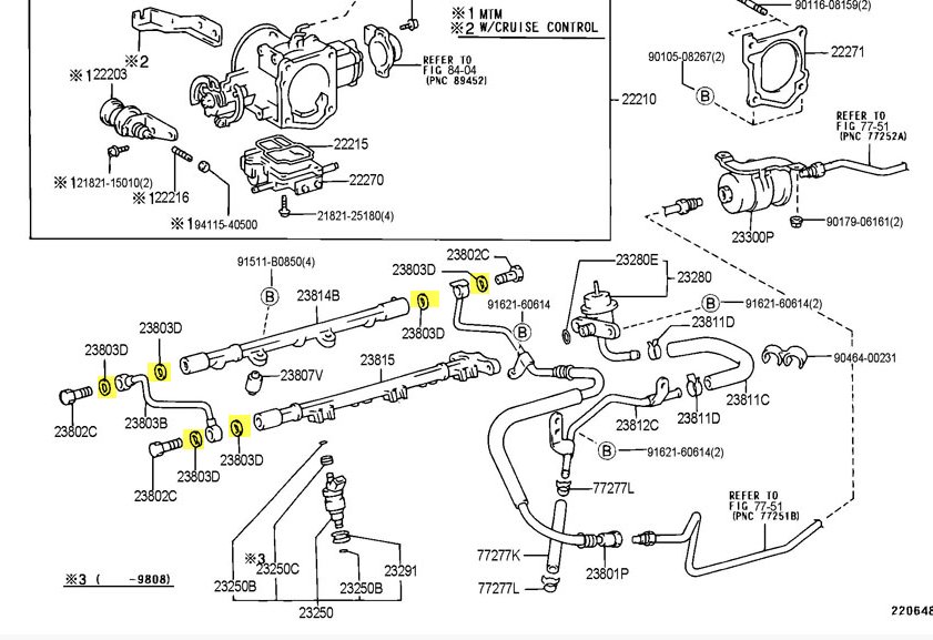

    Hey guys. In the near future, I plan on sending my injectors to motorwestperformance or witchhunter to be flow tested / cleaned.
    This is for a 2003 3.4L
    I know I need the thee items under "Replacement parts I know I need" but I'm not 100% sure if the other parts listed are replaced or do I need to order?
    Am I missing anything??

    Replacement Parts I know I need:
    1. Gasket, Throttle Body 22271-62050 $5.01
    2. Intake Manifold Gasket x 2 17176-62040 $10.15
    3. Fuel rail gaskets x 6 90430-12026 $1.36
    Are these replaced when sent to be cleaned or do I need to order:
    1. Insulator, Injector Vibration x 6 23291-20010 $6.25
    2. Ring, O (Fuel Injector) x 12 90301-07024 $2.61
    3. Ring, O (Fuel Pressure Regulator) x 1 90301-07024 $2.61

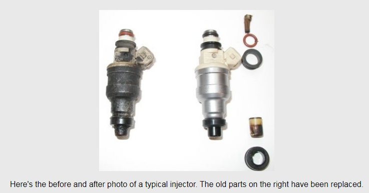

    Below photo from www.witchhunter.com

    I just recently sent my injectors off to https://www.rcfuelinjection.com/ highly recommended them they were awesome. I'm not affiliated with them just a customer. They replaced all the parts on the injectors I didn't need to order anything except replacing intake gaskets which I just reused old ones. Made a crazy difference. Turns out my best injector was only at half flow with 3 dripping....

    Yes, replace the O-ring that's labeled "23280E" and is located at the rear of the driver's side fuel rail.
    And you don't need the parts in the second half of your list (ask the rebuilder just to be sure though).
    Have fun tightening up banjo bolt 23802C at the rear of the passenger side fuel rail! When I did this job it was a real PITA disconnecting the wiring harness cover and moving it far enough to the rear to put a torque wrench on the bolt, and torquing it, without cracking or breaking the cover.
    Be sure to look at this video before starting the job.
    Good luck, the job is not as bad as one might think, but it requires a fair bit of patience. ;)

    They also sent me a before and after flow analysis and a bag with all my old parts they replaced.
