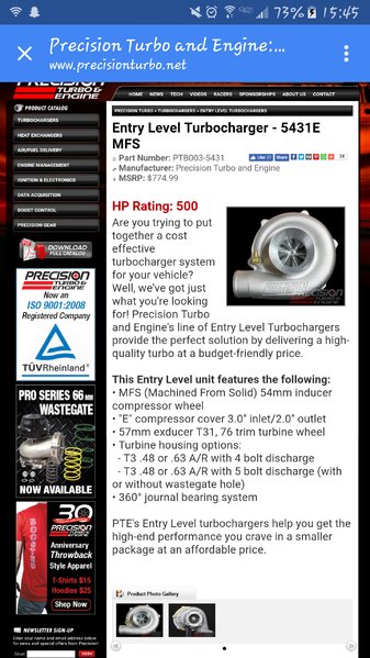

    My list and the turbo I'm thinking of.
