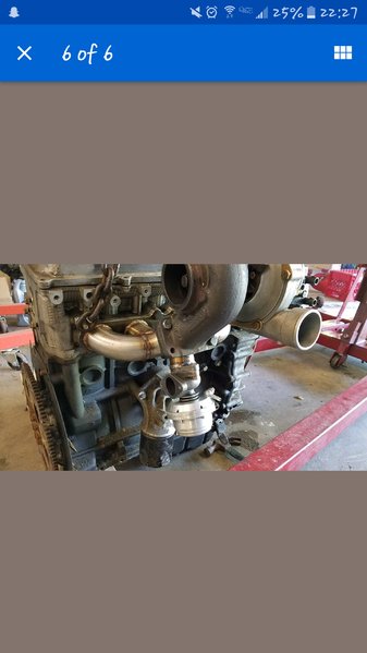

    I was looking around on Google and I found an eBay account that makes manifolds. It is pretty much a log style but made of tubing. You have the option of other wastegate sizes and flanges....would a log tubular style be better than a cast log style? @boostedka @MadTaco461 @yota243 @Torspd
    Also, precision 5431 or a borgwarner with similar better specs...I think it's a s200 or something?

    Bw s256 turbo with 3 in glass pack dumped pre axle raptor liner bed and top rails and fenderflares and rocker panels. Hunter side steps. Plasti-dipped upper fenders and emblems. satin black spray paint here and there inside and out. 5100's set to 1.75" up front . C channel front bumper. Maxxis bighorn 255/85/16
    Dang i got tagged in a good group haha.
    Id say pros of the tubing are gonna be a little better flow, lighter, easier to heat wrap, and they look better and also even if not wrapped are going to hold less heat in the engine bay than the cast
    The pros of the cast are well maybe cost and the list is gettin short after that.
    I dunno how much performance difference there will be in low boost but the morebu plan to crank out the more apparent it will be...

    If you are shooting for low to mid boost, a cast manifold will do just fine. The Tube style header you posted above, works the exact same as a cast log manifold. If you want to go from mid to high boost and reduce lag, you'll want a longer tube header, that directs the flow straight into the collector. Like this:
    Fun fact, this is one of LCEs headers for the 3rz. Both will work, this one will probably provide more overall control of your boost.

    I've saw that one and contemplated it, but I'm trying to keep it on the cheaper side....
    I was originally going with lce log mani, then boostedka led me to Treadstone but I noticed how close the turbo was to the body. This guy twists the flange as far up as possible and keeps +-2" for room from the engine itself

    The log will definitely still work! You'll get all the boosty goodness you desire from it, I promise haha

    Who makes that manifold? It looks similar to a KO Racing mani. Have you checked out their site? Kris sells just the manifold by itself for around $400 I believe
