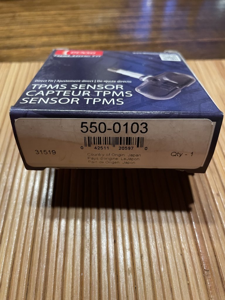

    Were these the ones? I had the same issue.

    Those are the ones I bought.

    Same issue here.
