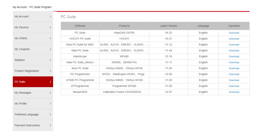

    They show a Maxi PC Suite for MAC so I guess you can use it on a macbook.

    It gives you 5 uses without activating but after that it locks until it is registered and activated via USB cable.
