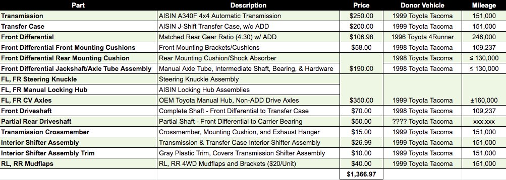

    So that $1500 was before selling the old parts off??
    Damn, I assumed that was after you sold off the old stuff, so your net cost was $1500.
    damn.

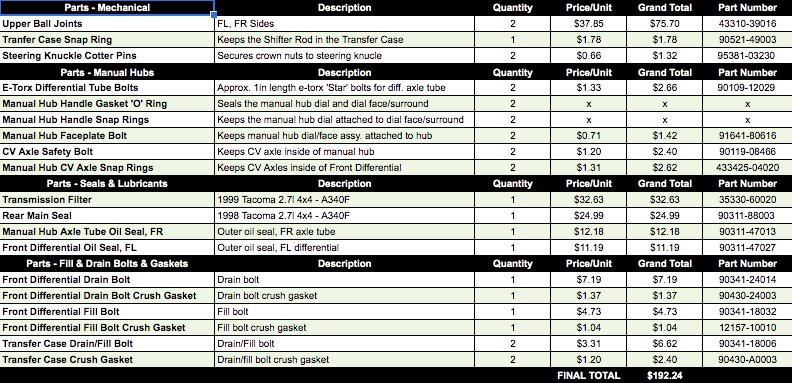

    $1,500 is before I sold off my old parts. Here's my expense sheets if y'all don't believe me. I only spent ~$950
    This is WITH new OEM axle seals, gaskets, drain and fill plugs, snaprings, and rebuilt manual hubs.

    Converted to 4WD DD VW MK6 TDI
    Can be done for less thatn 1500. I think mine was 1200 and I fucked up the front bearings so that was like a 200 set back haha. So around 1K. I did the bare minimum though.
    Just the main components. A little maintenance nothing crazy.
