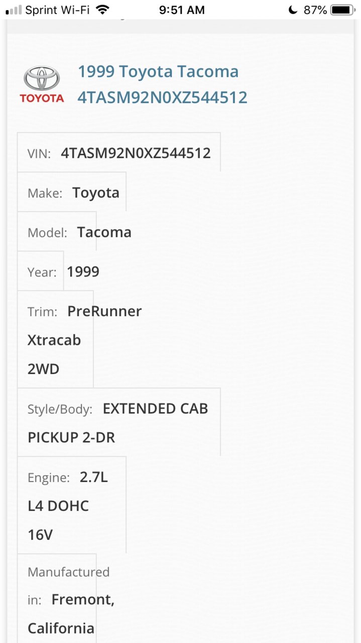

    hello all. Up until yesterday I was under the impression that PreRunners were two wheel drive. I have a 99 Tacoma (or Prerunner) but it is in fact, without a doubt, a 4x4. My title lists it as a PreRunner, the VIN indicates it’s a 2 wheel drive PreRunner. See photo. All the glass is etched w/ VIN # too. Everything looks original, I suppose the entire body could have been dropped on a 4x4 frame but if it was done they sure did a fine job. Just tossing it out there, looking for insight. Thank youAE241C9B-958C-4CB9-A87A-531A3EF0EACA.jpg

    PreRunners are built on the 4x4 frame. You can convert it to 4x4 very easily.
    My truck is a converted PreRunner 4x4. I did it myself, along with many other people on this forum.
    Can you take some pictures of the VIN sticker and the transmission shifter? ADD or Manual Hubs?

    Prerunner Tacomas are 2wd built on the 4x4 frame. Both have 6 lugs. My guess is someone converted. Many people have done that on here. It is 99% bolt up if you use the ADD hubs and 100% if you go manual hubs

    The only trucks that left the factory designated PreRunner that are 4x4 have been converted - usually by locating/procuring/installing the 4WD components; Transfer case, front diff, 4WD selector, front driveshaft, CV axles and 4WD spindles (plus a few other items).
    It's not a complicated process. There are a number of us here on TW that have accomplished this...
