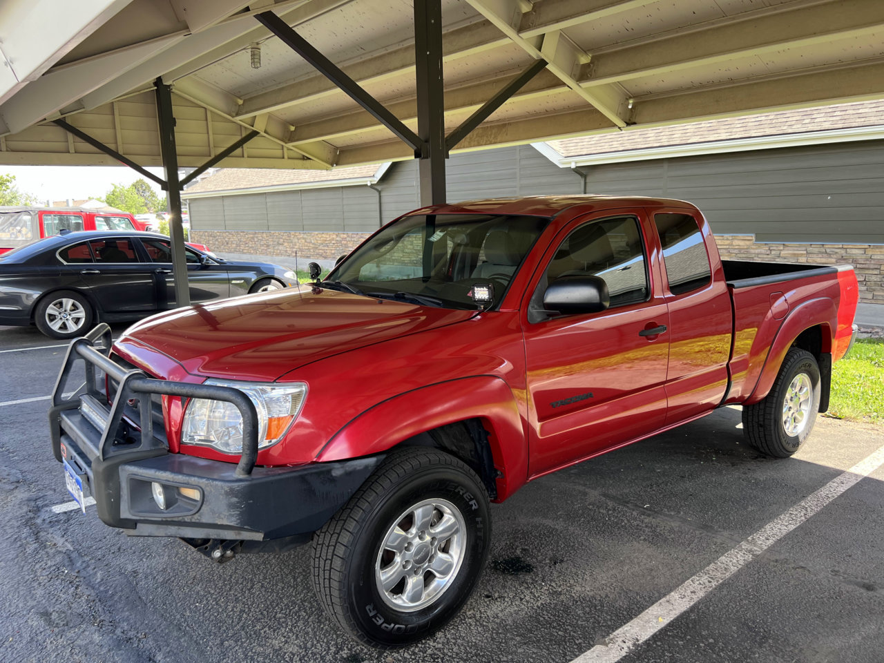

    I have a 2010 PreRunner 2.7L 5 speed Access Cab SR5
    The day I bought her in 2015 (~97,127mi):
    Present Day (198,545mi):
    (Pic is from June 2022.)
    Bought Mia in California at 97,127mi for $17,577.89. Paid her off on 07FEB20 (10 months early). I traded my old JK (boo) for her. I bought a PreRunner originally so I wouldn't be tempted to sink thousands of dollars into her like I did to the Jeep (thanks, guys). I also bought a PreRunner not knowing I was going to PCS to Colorado, so winters are fun.
    The current plan is to pay her off and then get to work on converting to 4x4.

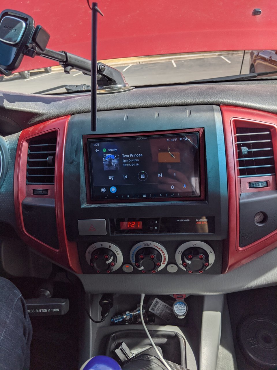

    Alpine ILX-W650/Radio Surround/AJT Knobs/12 Ball
