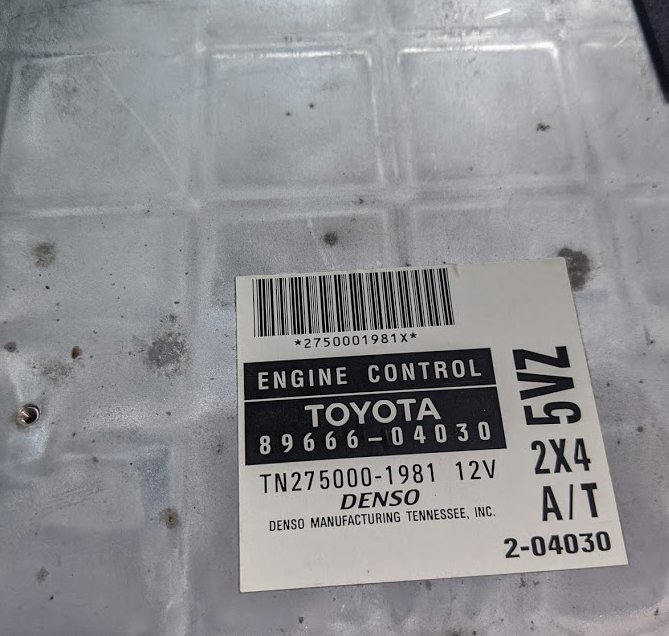

    For future reference - some posts talk about the need to replace your 2WD ECM with a 4x4 ECM, some say its not necessary. Still trying to determine if it will be needed for a ADD/Jshift (non 2-4 selector), I don't think so but still researching.
    2002 PreRunner DC, 6cyl, Auto
    Stock 2x4 ECM (TPN #89666-04030) located behind glove box. For reference, the 4x4 ECM is TPN# 89666-04021.
    If you need to pull it for whatever reason, use this as a reference (very simple process)

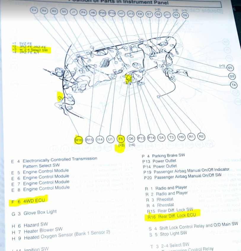

    This is different from the 4WD ECU which would be located above the Airbag Sensor Control Module just forward of the shift console. The PreRunner does not have the 4WD ECU. If you had 4WD stock from the factory with the 2-4 pushbutton selector, you had the 4WD ECU in this location and a 4x4 ECM behind the glove box.
    @nzbrock mentions this here:
    The TRD PreRunner (at least 2002) had a separate ECU for the Rear Diff Locker. It is located behind the driver's side kick panel.
