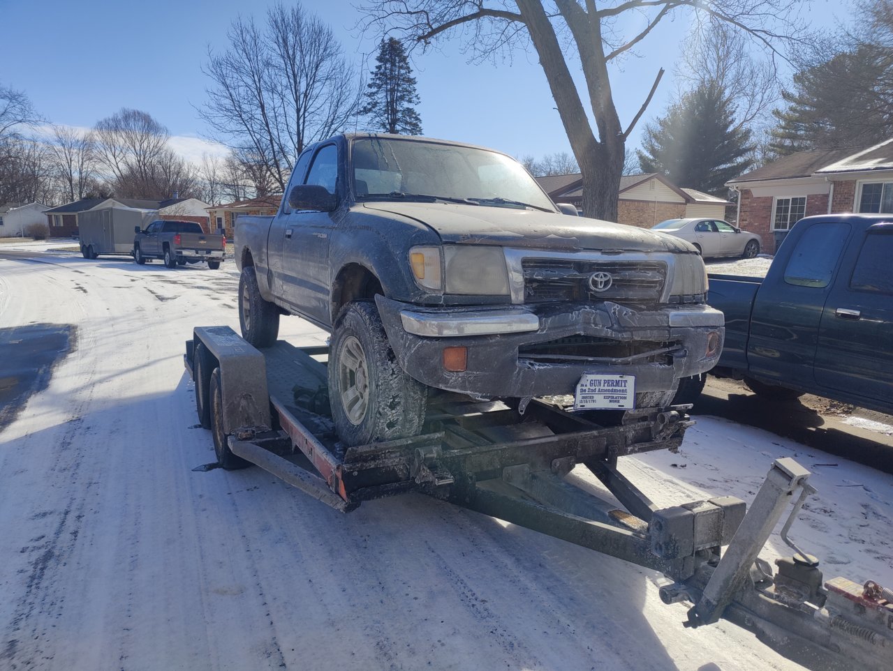

  20. Jan 30, 2022 at 6:28 PM
    #160
    97evergreen
    97evergreen Member
    Jan 30, 2021
    #354557
    5
    Jean
    97 Evergreen Tacoma 4x4 Manual
    Truck it's pretty stock no modifications currently
    I'm currently in the same process.. I have a 02 prerunner single cab, short bed rust free and clean.. I had been wanting to do build a daily truck but also 4x4 since we get lot of snow up north.. after 2 years finally found a donor 00 Tacoma manual 4x4 frame it's beyond repair and only got it for 1100..
