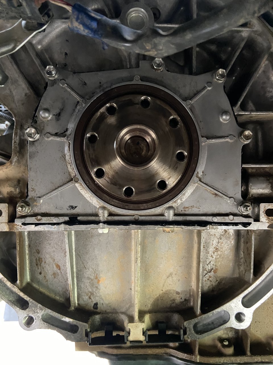

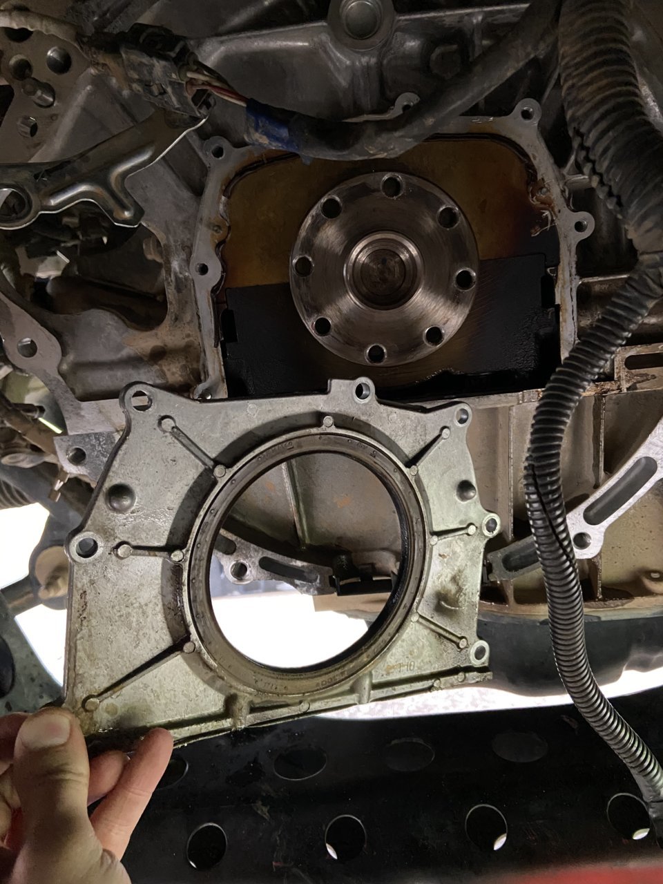

  10. Mar 19, 2021 at 2:44 PM
    #230
    pdaddy
    pdaddy WeLl-KnOwN mEmBeR
    Sep 10, 2019
    #304930
    2,640
    Preston
    Central AL
    ‘13 DCSB Converted Prerunner 4wd
    100% replace the rear main seal, only time you’ll ever get a chance. Pretty easy I just did mine a few minutes ago actually. Took off the mounting plate and gave it a brand new FIPG seal too. The old gasket was looking pretty bad at 185K miles
  11. Mar 19, 2021 at 3:58 PM

    Im not familiar with this deal. Where is it exactly?
  13. Mar 19, 2021 at 4:26 PM
    #233
    pdaddy
    Sep 10, 2019
    #304930
    2,640
    Preston
    Central AL
    This thing. Found it much easier to pop out the old seal and put a new one in this way. About 9 bolts
  14. Mar 19, 2021 at 4:36 PM
    #234
    jowybyo
    jowybyo Well-Known Member
    Nov 19, 2013
    #116863
    6,092
    Joe
    Baltimore, MD
    '14 MGM DCSB Postrunner 4wd Conversion, Debadged
    Ah cool. I probably should have done the same thing. It was kind of a pain to put the R.M.S. in even with a seal driver.

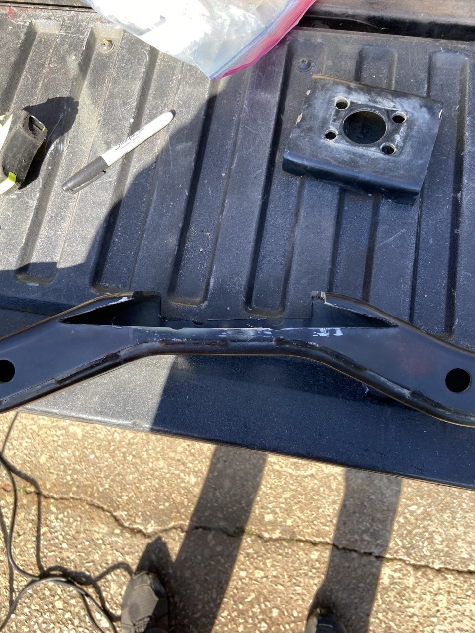

  20. Mar 20, 2021 at 5:48 PM
    #240
    pdaddy
    Sep 10, 2019
    #304930
    2,640
    Preston
    Central AL
    I partially fabbed up my crossmember today, measurements made it about 2 inches lower and 1 inch forward than stock. This seem about right? What about you @ilubtimmyhos?
    ilubtimmyhos[OP] and Ricardo13x like this.
