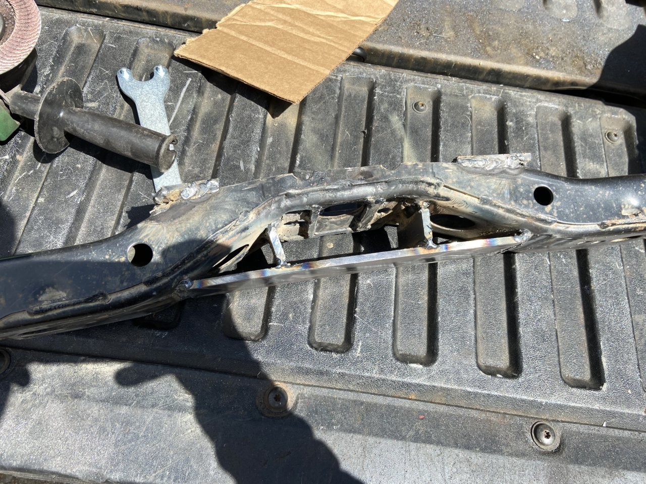

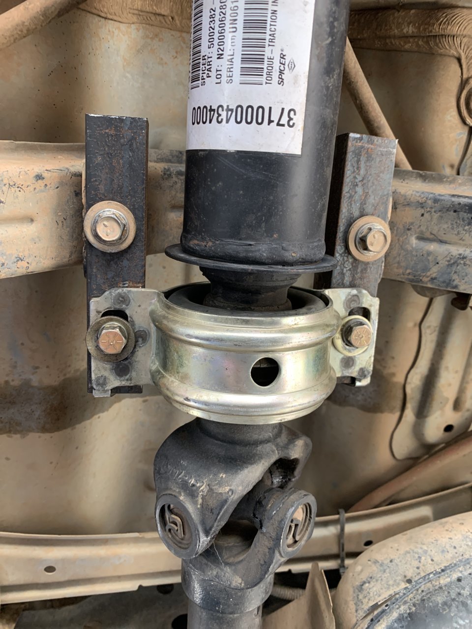

    If you don’t know already, starting with the trans will allow you easier access to the torque converter nuts behind the starter. I’m glad I did it without the front diff in the way, it would have been a pain! I bought a 4x4 driveshaft. It had an upgraded IEDLS carrier bearing and I’ll use angle iron to extend the mounting holes a few inches. Should facilitate a slight drop too which should help on vibrations if I was going to have any

    She strong but ain’t that pretty:rofl:

    That’s what I plan on doing. I’m using this one until I get my prerunner shaft modified to fit. I’ll keep this and the angle iron as a backup

    That's what I had planned for mine but mine wasn't that much off from the cross memeber. Mine fit at the end of the slot on the carrier bearing.( I did use a ac driveshaft tho maybe that has something to do with it)

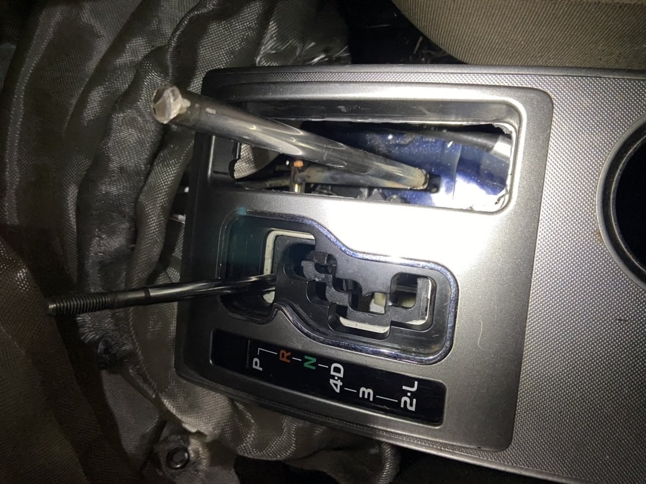

    Nice I’m doing the driveshaft tomorrow. Working on shifter now, do you think this is enough room to shift in every gear? And yes I welded inside my cab fight me
