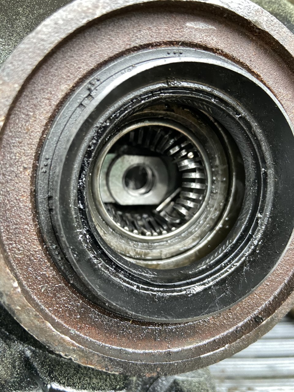

  13. Mar 28, 2021 at 4:57 PM
    #313
    MA_TACO
    MA_TACO Well-Known Member
    Jan 28, 2018
    #242689
    670
    Wesley Chapel, FL
    Remove that seal and hit the bearing with WD40 and some heat(propane torch). You might need to rent a slide hammer and use the pilot bearing attachment and pop that thing out.

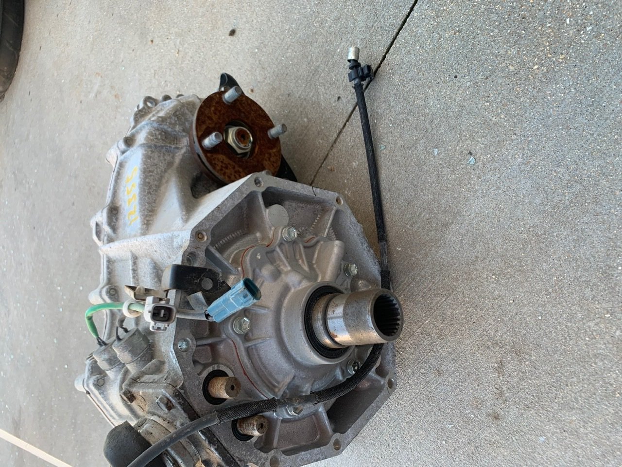

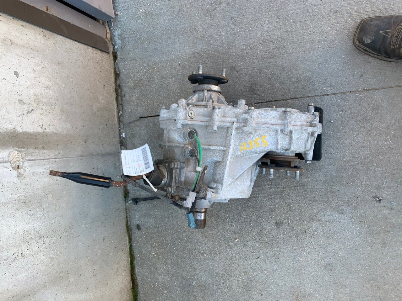

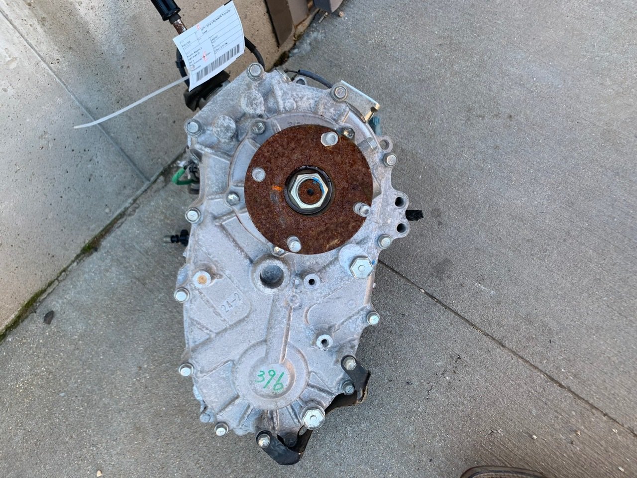

  15. Mar 29, 2021 at 5:39 PM
    #315
    Ricardo13x
    Ricardo13x YT: @UrbanOpsOffRoad IG: @urban.ops.offroad
    Feb 9, 2020
    #318785
    2,950
    Upland, CA.
    05 OR DCSB ProRunner(4x4 conv.), Chevy 63”s, NWF EcoCrawler, 35”s
    Random stuff. Oh! and converted to non ADD 4x4.
    Just as you mentioned. VF2A out of a 2016 4Runner trail edition. Coming this way already. Thanks.
