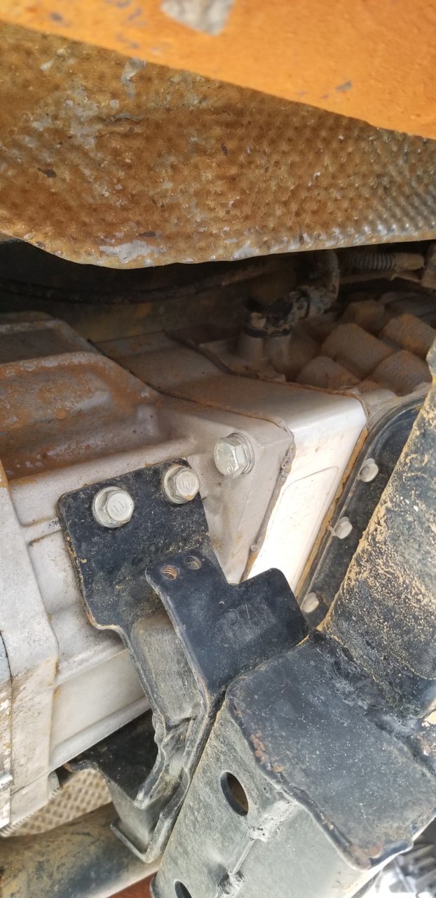

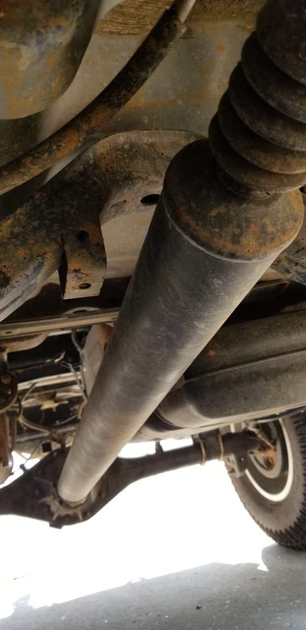

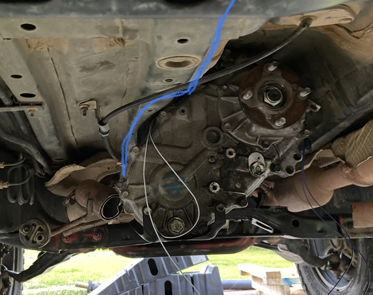

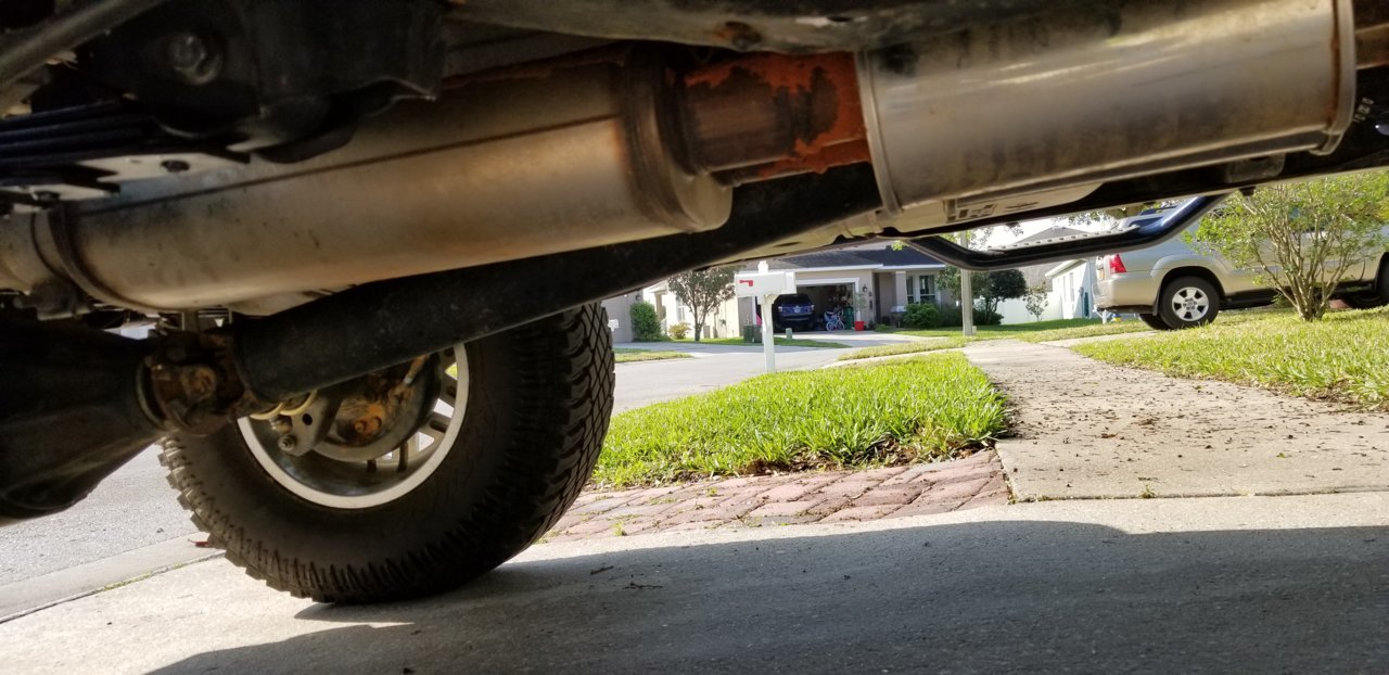

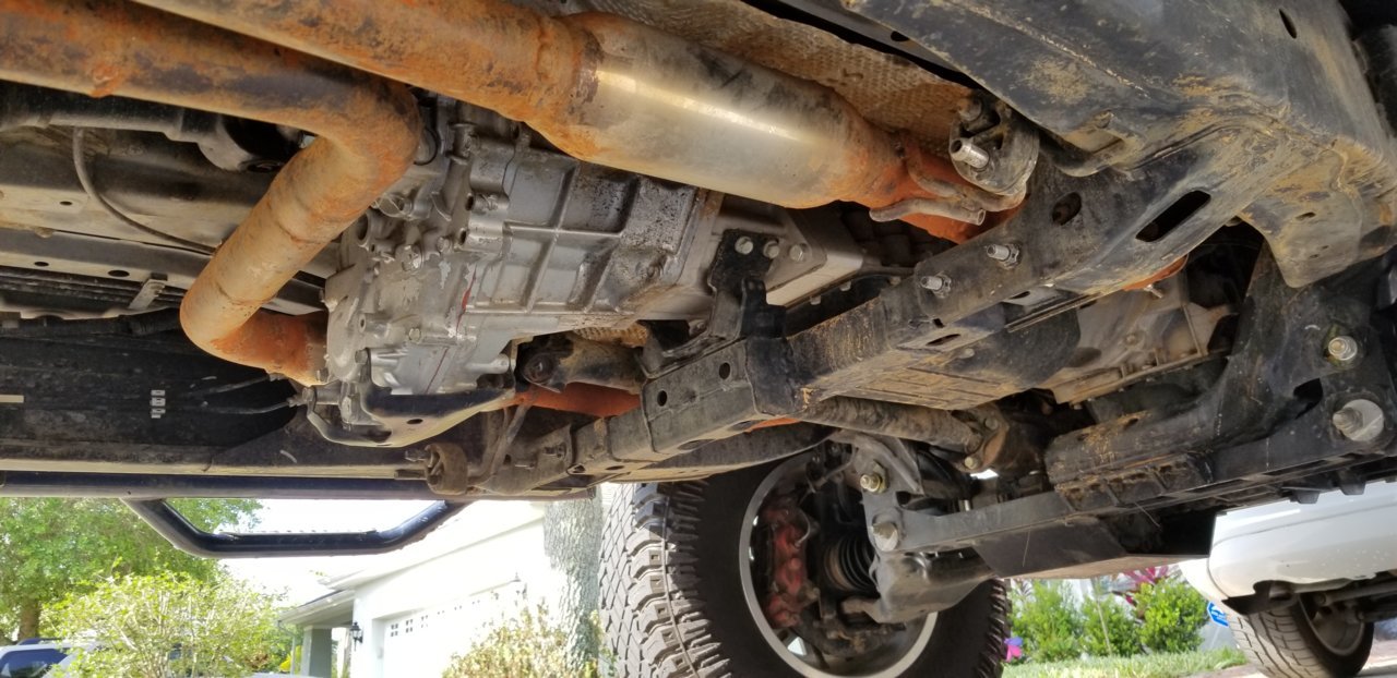

    The clearance is not that bad. The driveshaft only hangs down at the point of where the center bearing about 1.5 inches. Here's a few pics. 20210330_094256.jpg 20210330_094356.jpg
    And a pic of that inchworm adapter and transfer case.

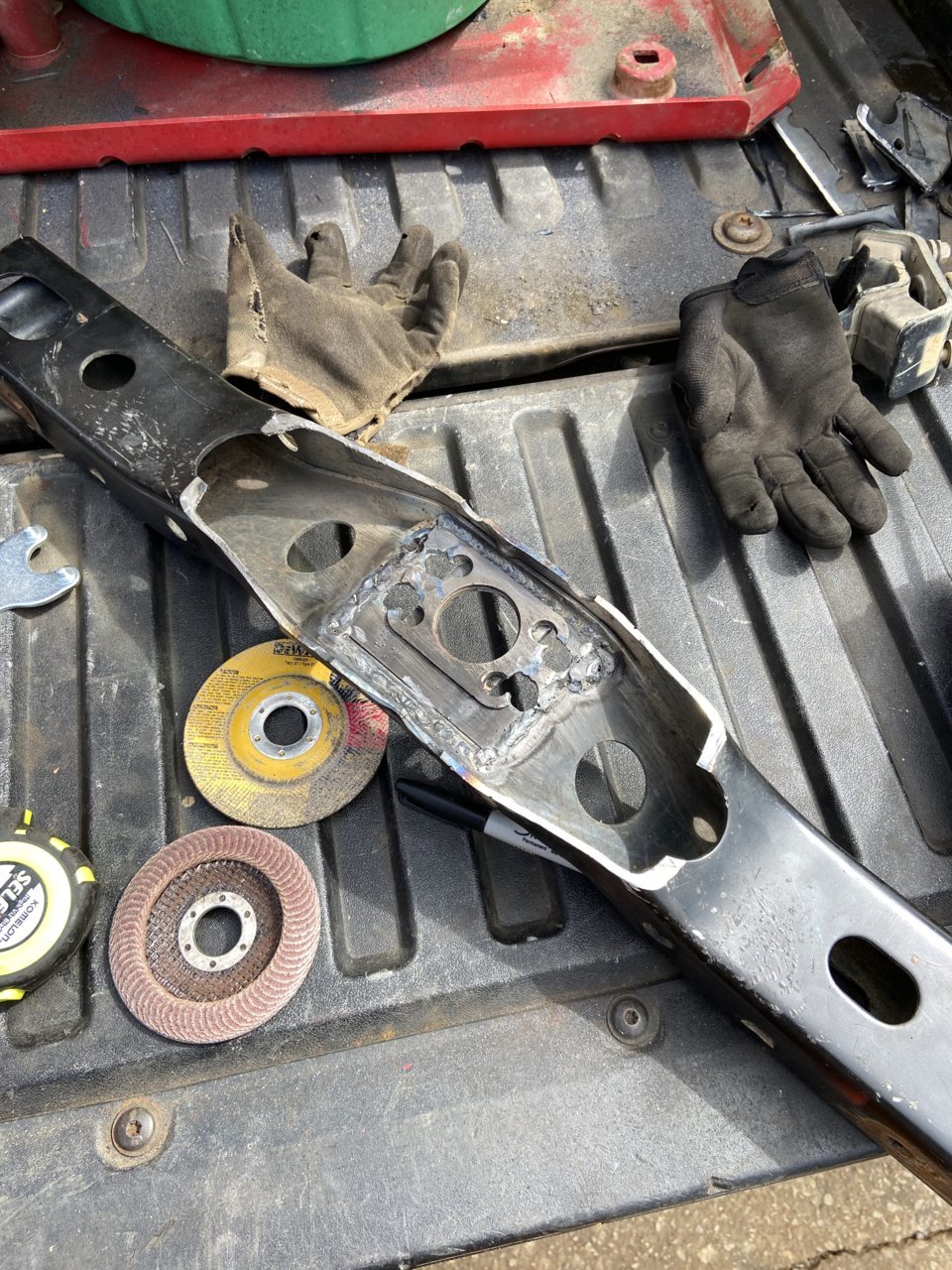

    Just double checking before I make a mess. When modifying the A750E(prerunner) cross member mounting holes to fit the A750F(4x4) should be and inch forward(towards the engine) and no change in height. Am I correct? Thank you.

    There’s a lot of variances between years and models, seems like everyone ends up having different measurements. I ended up doing it about an inch forward and had to come down about 2 inches. I didn’t really meausure precisely, just start cutting about 2 inches down and turned out pretty good. My new mount is almost flush with the bottom, maybe an 1/8 inch higher than bottom. 2013 DCSB v6.
    upload_2021-3-31_21-47-42.jpgpp

    Gotcha, mine is an 05 DCSB. Is there any good indicator to know if the weight of the transmission is not putting the engine on an angle? My plan was to mark the arms of the transmission jack before removing the A750E(prerunner) and match the marks when the A750F(4x4) and with that I’ll be matching the angle and start cutting and going to town on the cross member

    That was something I had no idea about. I tested it out with a jack, there’s still plenty of room to droop down but also it’s not stuffed up touching the floor. Kinda hard to describe but it just feels right. Here’s how far away mine is from the floor

    thats what mine is like, you should be good to go. The Curve of the trans tunnels is the same through all models iirc

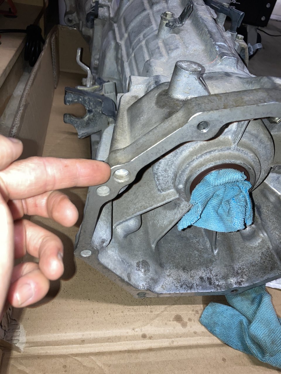

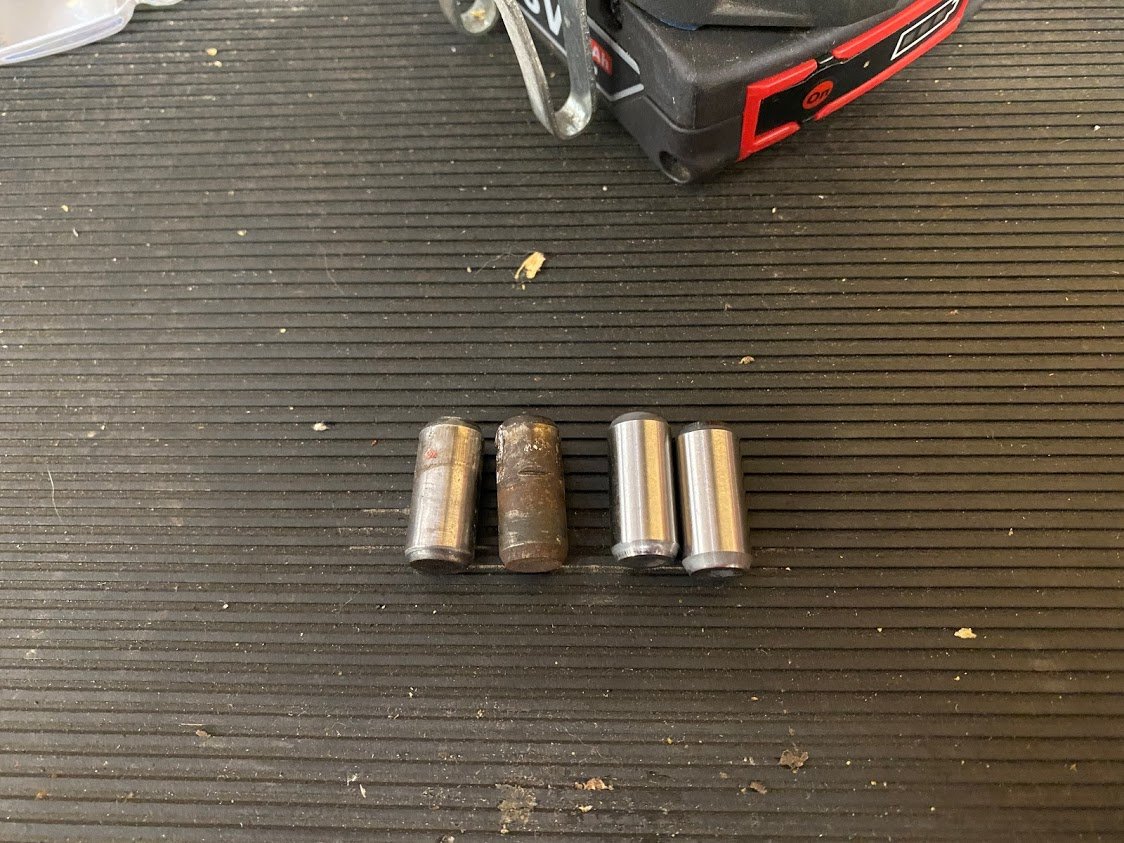

    image.jpg Sup fellas, just double checking this is the right part number( 9025011003) for this small pin I am missing before I submit the order. Thanks
    *the one on the other side is in place.

    The PN is indeed 90250-10113, I had to replace both of mine due to them being seized, note that they are the same PN whether auto or manual transmission.

    thanks for confirming the PN. I was about to attach the trx case to the transmission and I was like wow. Missing the pin here. Videos of the conversion will be rolling once the conversion is completed

    Make sure you put some anti-seize on the new ones, and leave them in the freezer overnight for easier install.
