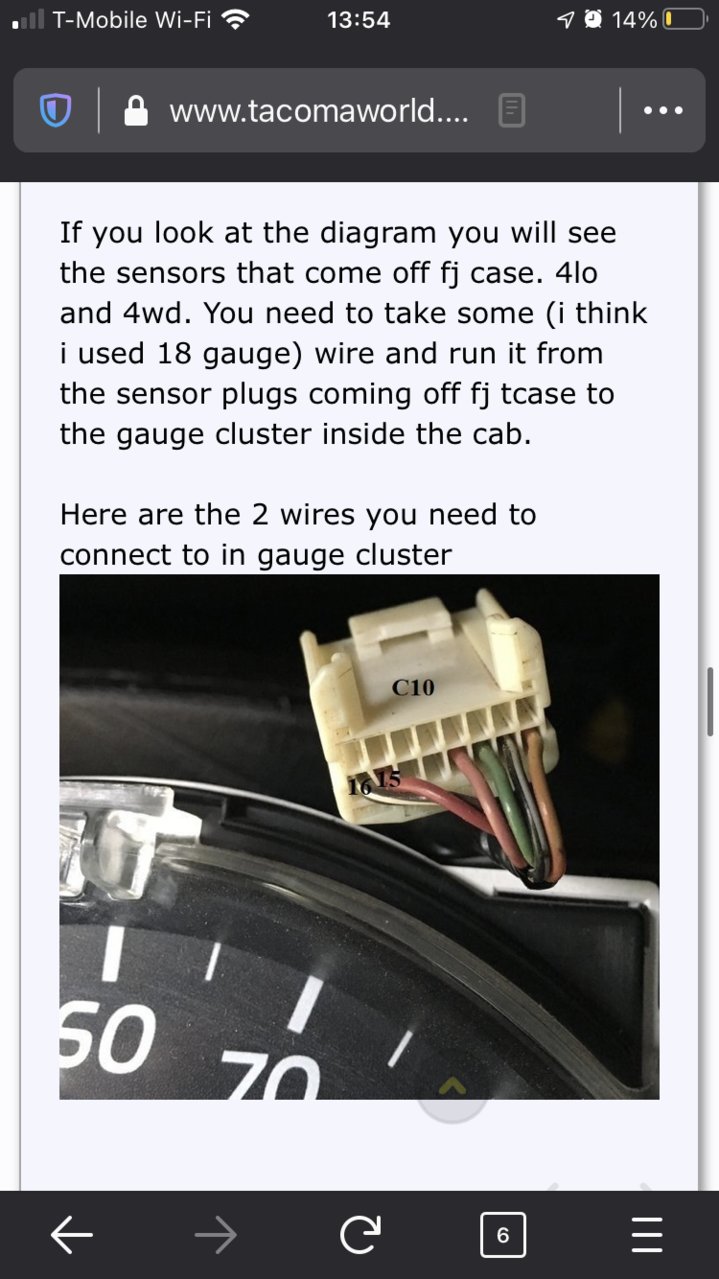

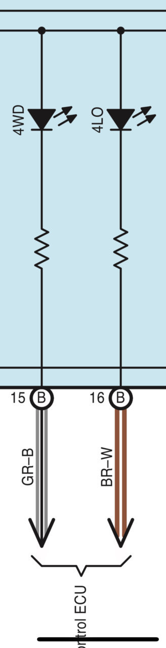

    just to double check, the switches on the transfer case(4H, 4L, and N) provide the ground for the circuit am I correct? Now the 4H is 16 and 4L is 15 or the other way around?2B63CC7D-0F62-49FF-B133-F0C2D4D9C4D8.jpg

    yes they provide ground. Other way around, 4H is 15 and 4L is 16

    This is the image I was looking around for. As always thanks for all the help and sharing the yota knowledge man.

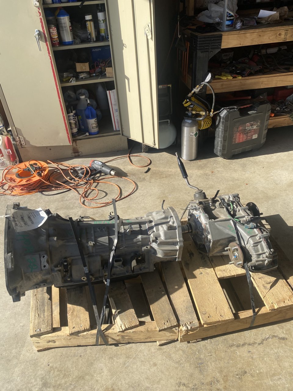

    Supper stoked I was able to pick up my transmission for the conversion with the help of@whatstcp
