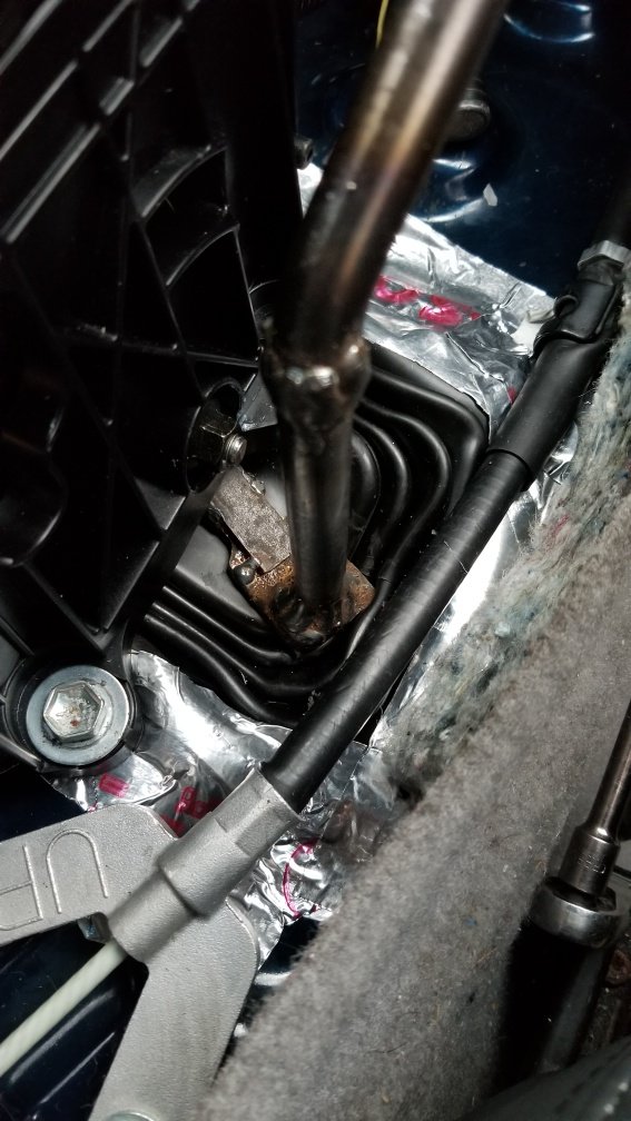

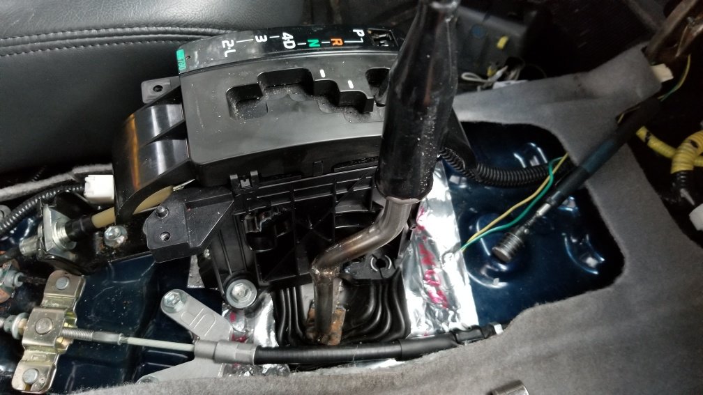

    These are the only 2 that I took. The tc shifter comes out right under the shifter assembly so I fabbed up something to bring up to the side of it and up out of the coin slot. Shifter assembly lost one of its mounting points but 3 bolts to hold it on was good enough.

    What did you use to seal the floor? Im thinking im going to use some aluminum plate and sound deadening material.

    I used a shifter boot from autozone and sealed the edges with what we call in mechanics world "Dum Dum" which is that black sticky rope used for windshields then covered it with aluminum AC duct tape.

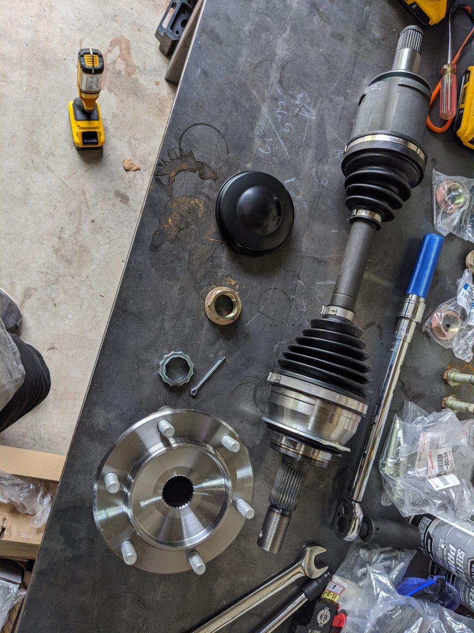

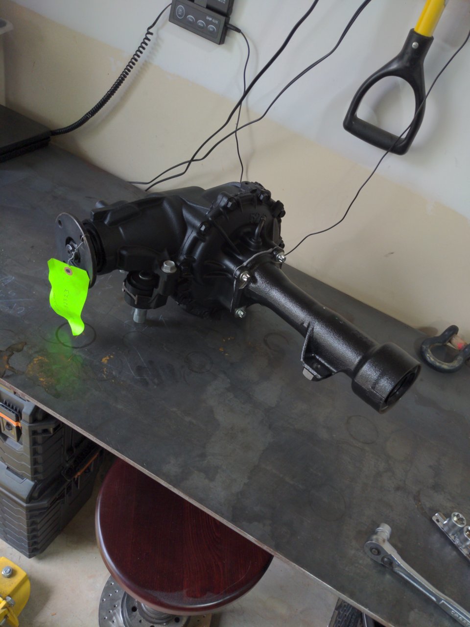

    Hubs and CVs officially ordered, built front diff ordered from ECGS, and all other parts are at my house. Just need to scoop the rear DS from a buddy and I should be good to go!
    Edit: And order fluids

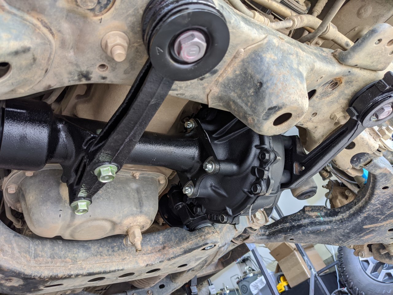

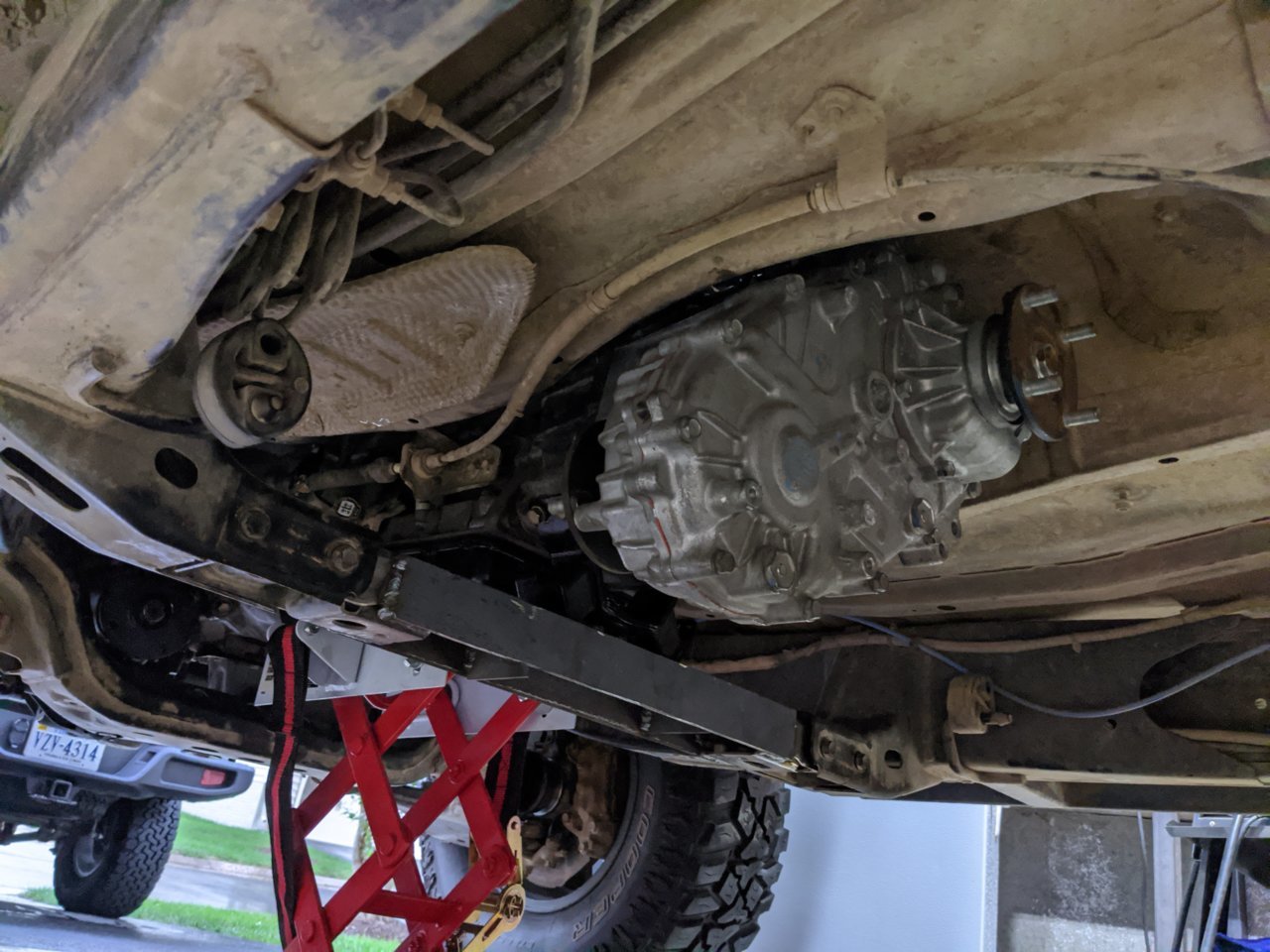

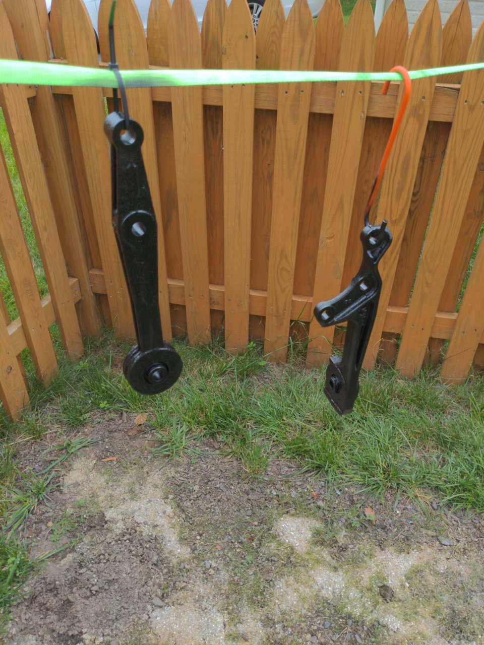

    It's happening!image-20200803_100248.jpg image-20200803_111929.jpg IMG_20200803_125454.jpg IMG_20200803_130646.jpg
