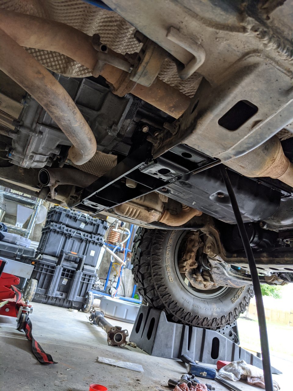

    Truck is at the shop for the exhaust reroute and drove there with nocheck engine lights! Now that's a successful conversion.IMG_20200816_144909.jpg IMG_20200816_152816.jpg

    Where'd you take it, and if you don't mind, what's the likely damage? I know @Mojo Jojo was looking for shops up in NOVA.

    Took it to Hi-Flow in Manassas. I'll report back with cost

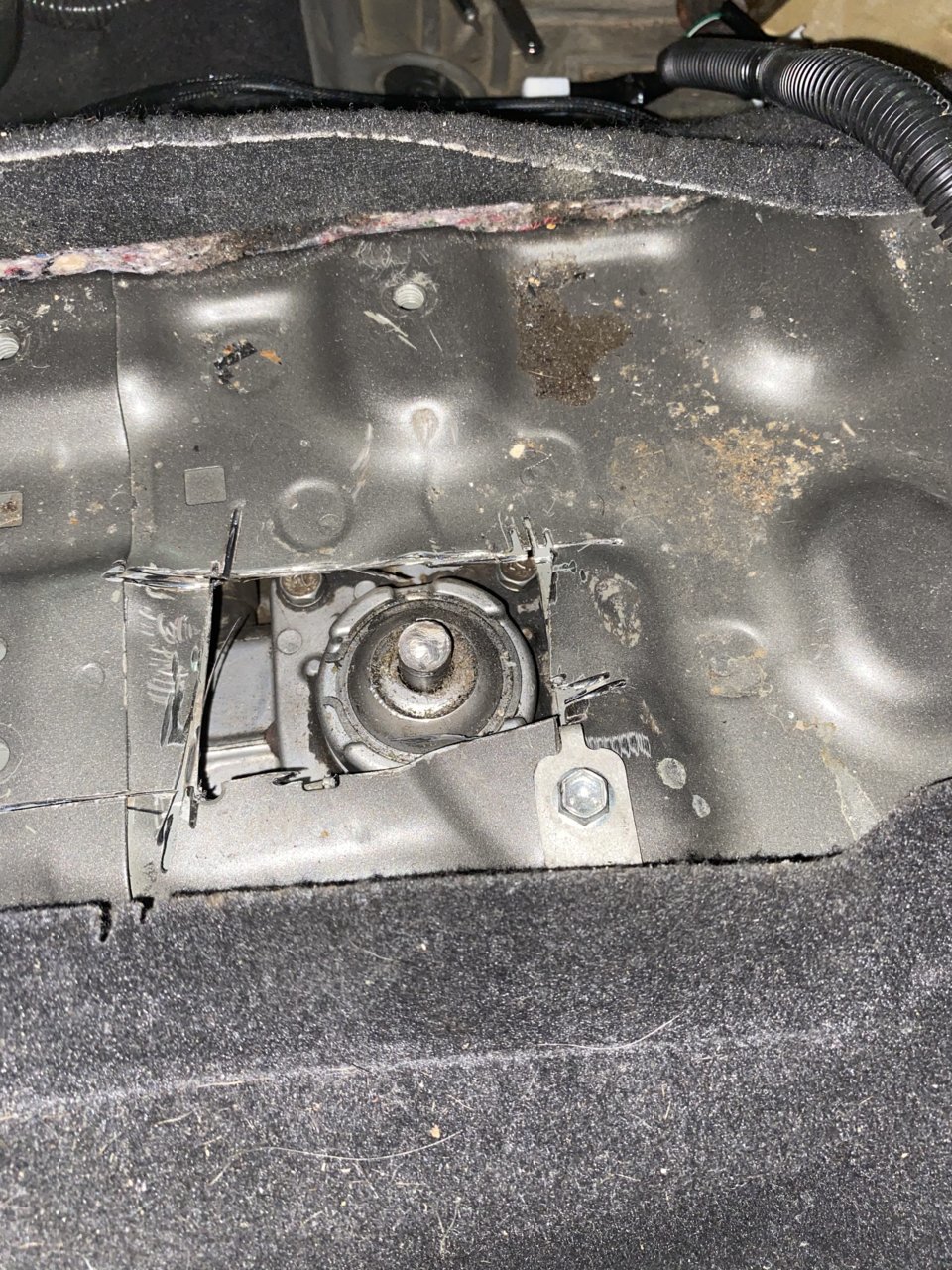

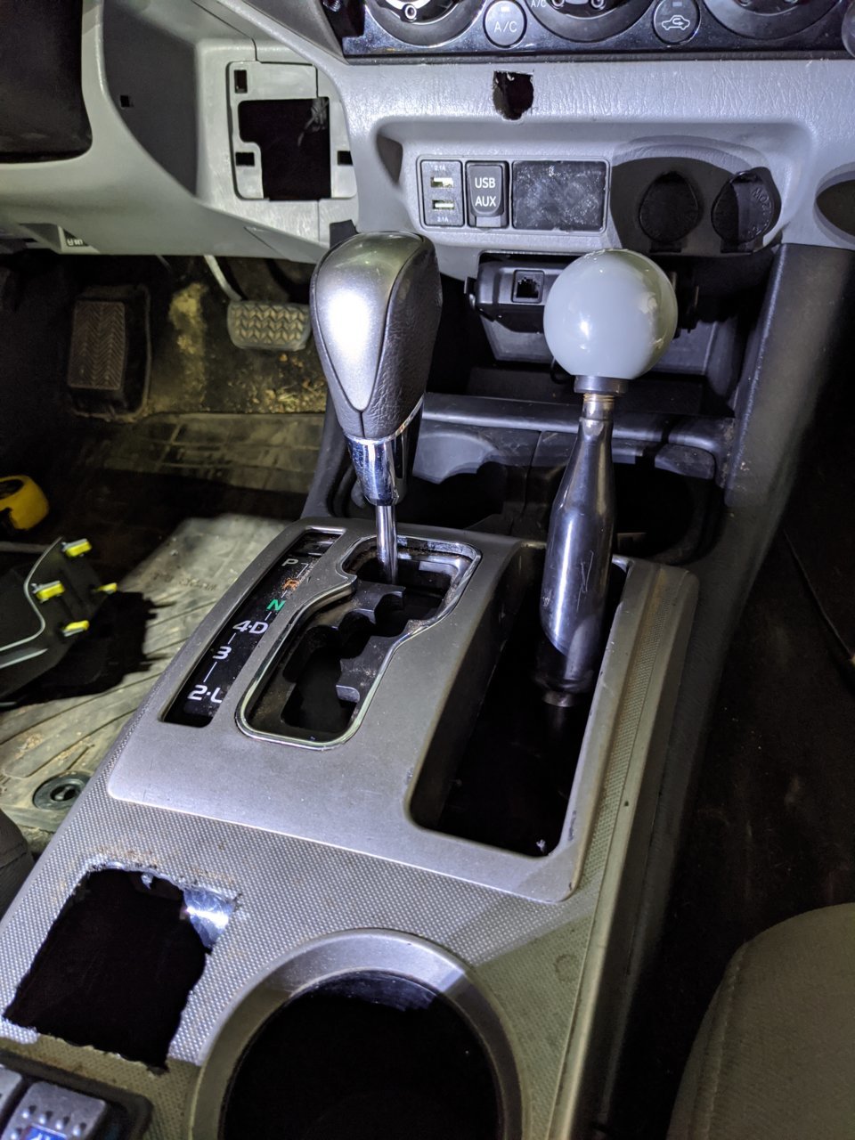

    got a pic of the shifter without the cover? Im still trying to get mine in the right spot. I also have no codes! :cheers:

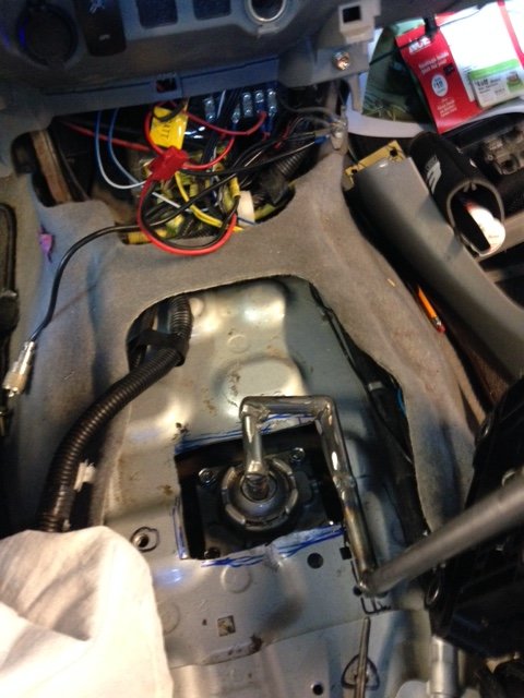

    I cut mine pretty short. My shifter has been a bitch with my crappy welder lol.[​IMG][​IMG]

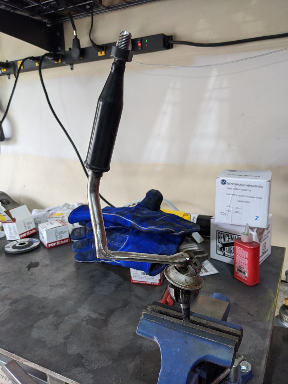

    This is what it looks like. I ended up removing the isolator and shortening it because it was interfering with the tranny shifter. Pic is before the last mod but angles are the same.IMG_20200816_121842.jpg

    what size wrench is that? Is the from the pic you posted above it looks like there would be interference getting into 4lo

    It was a 13 because the closed side of the wrench fit almost perfectly around the shaft. 4lo goes in no problem. if I angled it anymore forward it probably wouldn't though

    My shifter is 1/2" cold roll bent, welded and shaped to fit. I also cut the hole in the floor large enough to get the shifter out from the cab without issues.

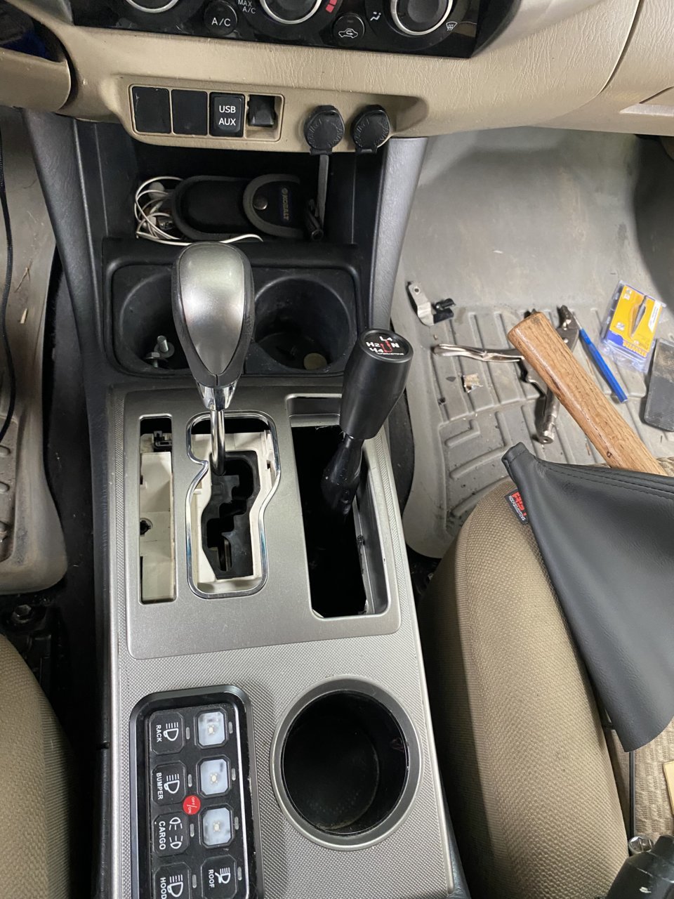

    I didn't have to do any welding for my FJ swap. I just cut a little more plastic. Doesn't look as clean, but it was weld free.
