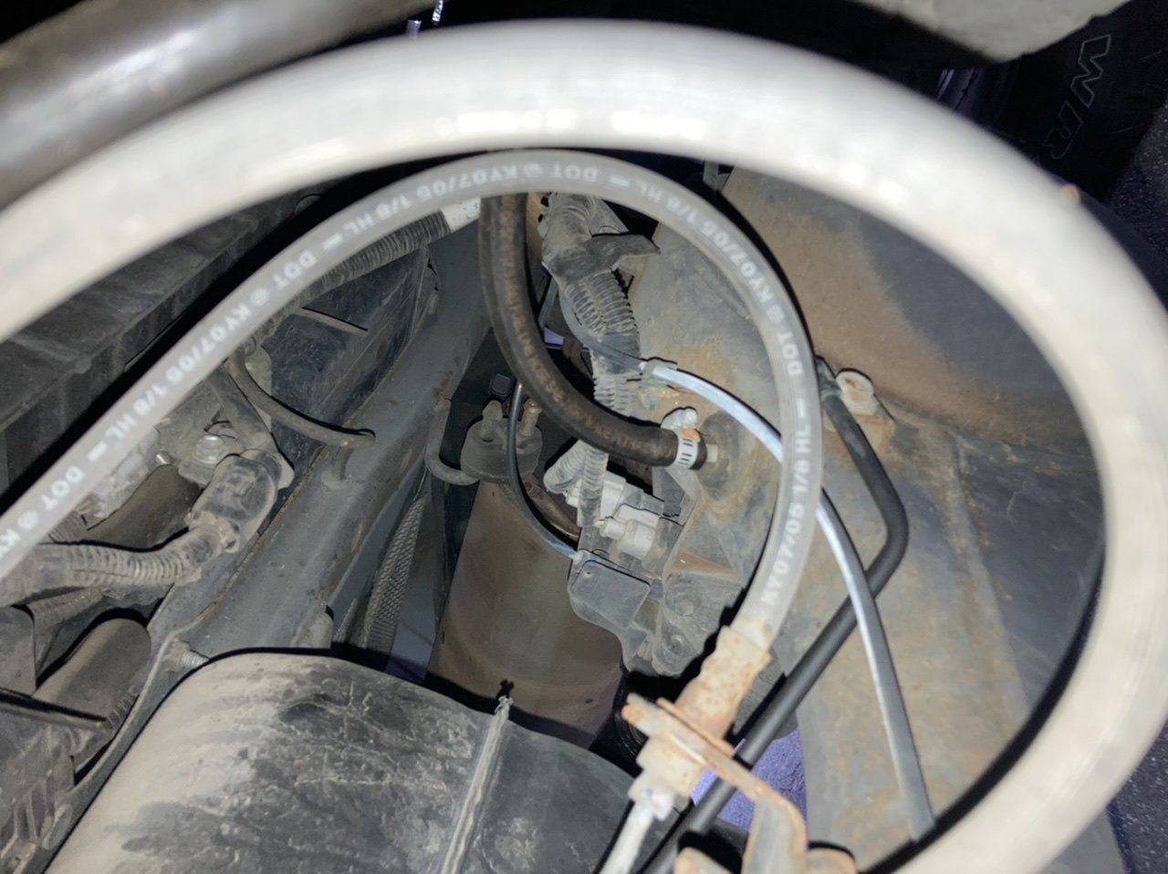

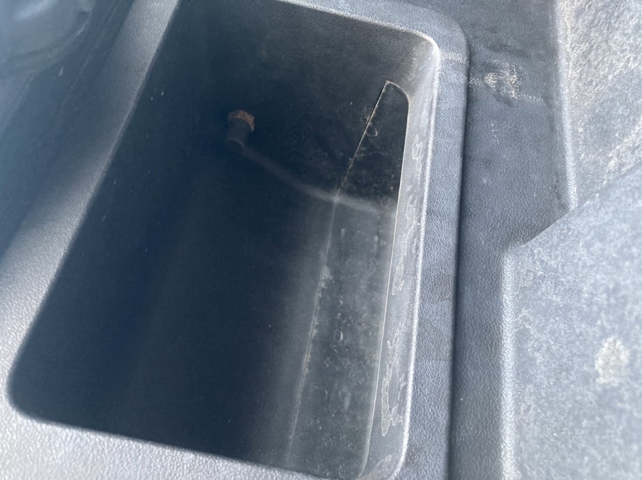

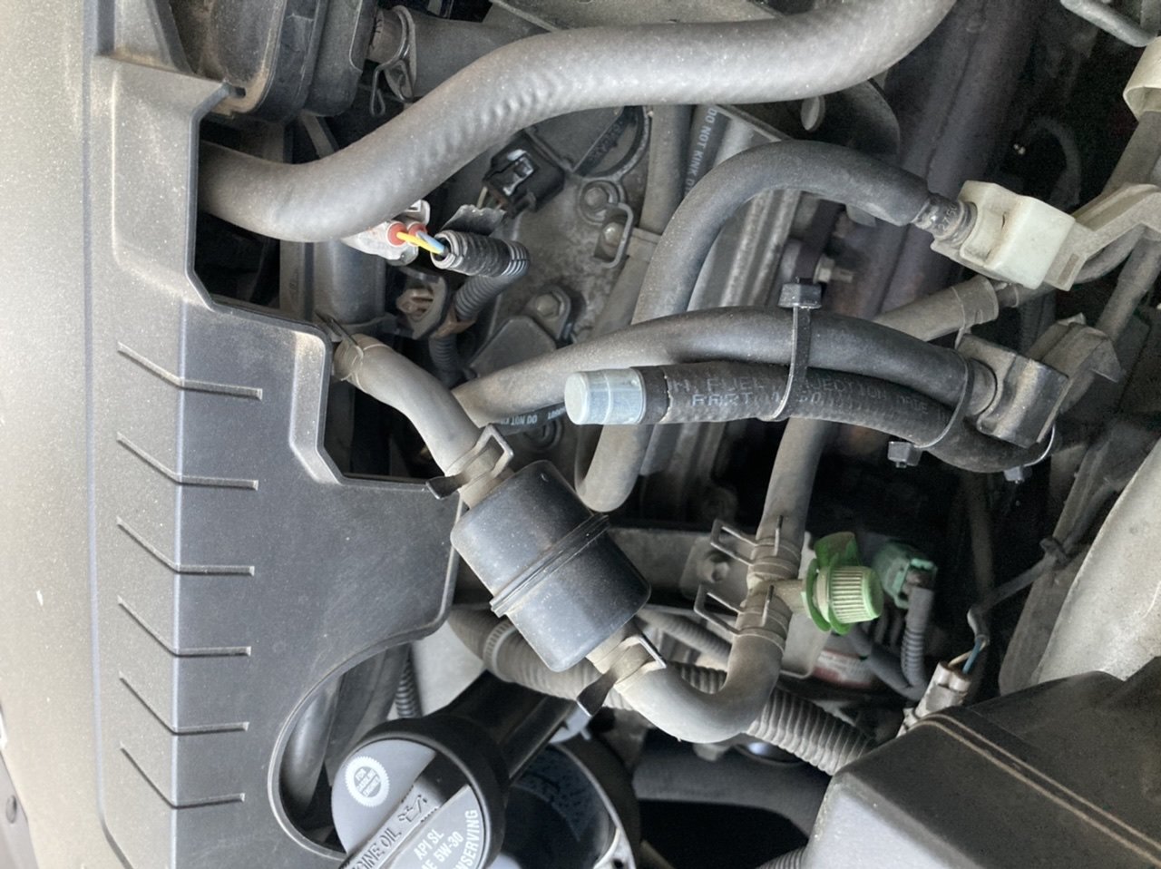

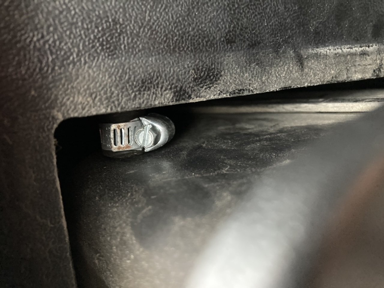

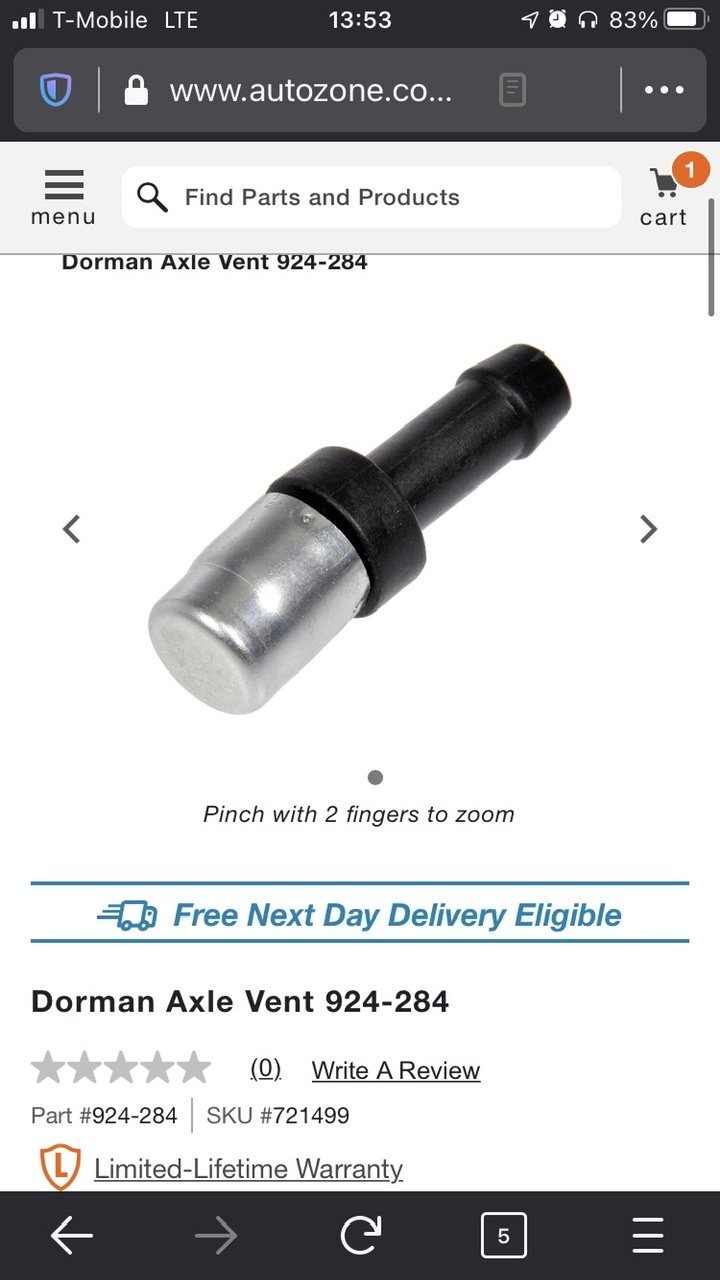

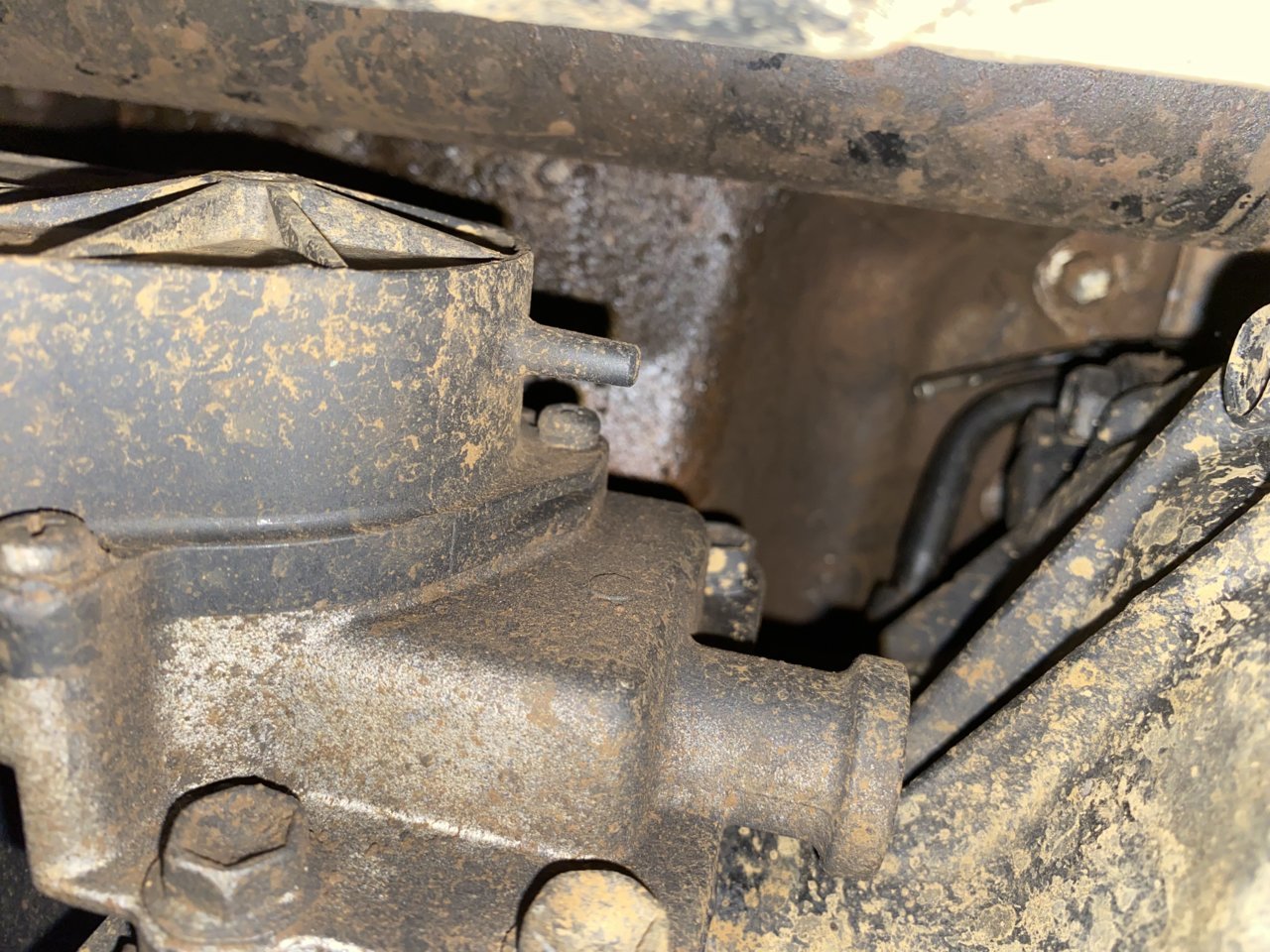

    D44CD05F-810A-4253-81AB-7B3E7964FD63.jpg Cheers, here are the pictures of my vents and a video that shows part no’s, hose diameter and clamps.
    https://youtu.be/l8WGZK1alsE
    1- view of the rear diff. Vent
    2- front diff vent.
    3- transmission vent(transfer case vent can’t be seen but it’s right by where I did the circular marking)
    the dorman vent I used is the following
    And as you can tell my engine has some extra help.
    jawmes[OP] likes this.

    I would like to add that I re-used the rear axle one since it has threads and I drilled a hole small enough to self thread it in place. As well, I re-used the ones on the transfer case and transmission, and tail section of the transmission that I left by the transfer case one (the ones that can’t be seen on the pictures)
