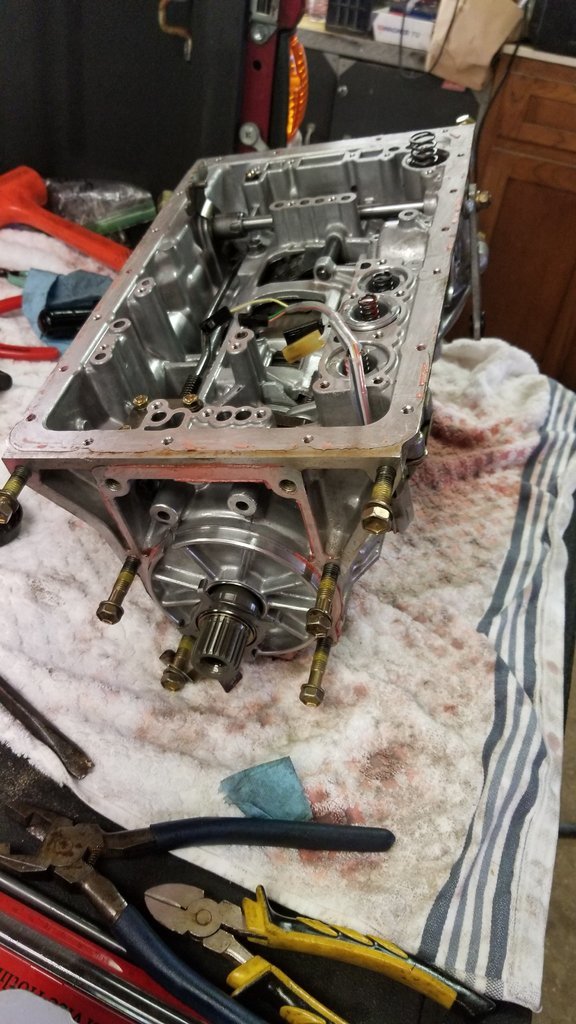

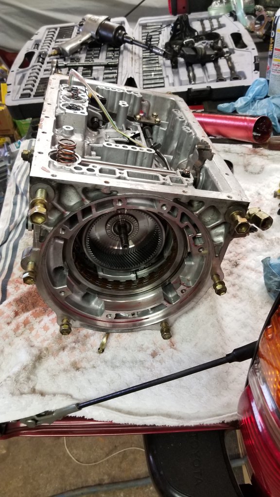

    I decided to take apart a trans from a 99 to get the output shaft. I plan on taking the trans out of my truck today and swapping it. I also plan on getting my driveshaft cut and balanced instead of getting a replacement, it'll be cheaper.

    Awesome! You'll be 4WD in no time. How was it taking the trans apart?

    It was fairly simple it took me about an hour and a 1/2. I just hope the assembly goes by smoothly. I found some manual hubs for $200 locally.

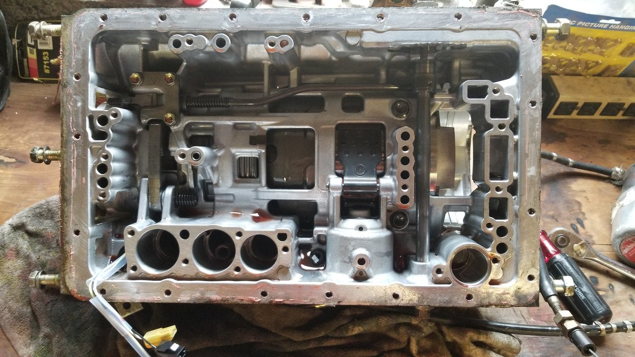

    There she is with the 4x4 output shaft. Too much work but well worth saving the money

    Shit looks so complicated...

    Not to bad, as long as you remember where everything goes and how it went.

    Nice job. With the 03-04 transmissions, swapping the output shaft is the way to go.
