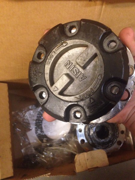

    -Manual hub assemblies (if not included with spindles)

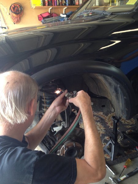

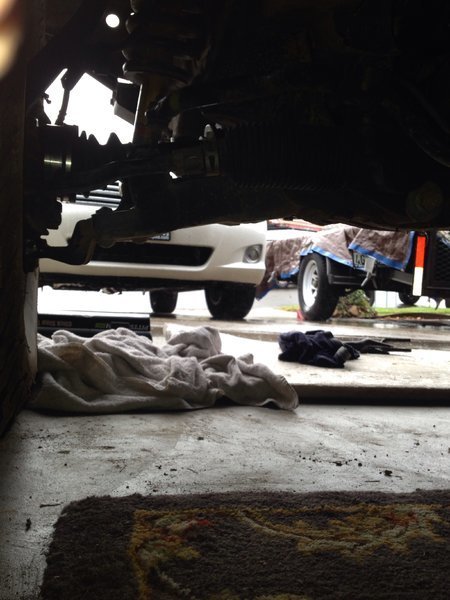

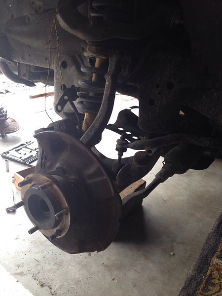

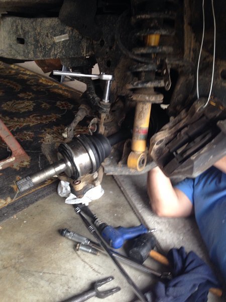

    The first thing I did was install all the front end parts (spindles, diff, axles, hubs). Getting the old ball joints out of the upper control arms was a huge pain in the ass because it was seized in there and required a torch to heat up the UCA enough to free the ball joint, along with a pneumatic air hammer
    IMG_2579.jpg IMG_2581.jpg IMG_2580.jpg IMG_2582.jpg IMG_2583.jpg IMG_2585.jpg
    Overall the front end install was pretty straight forwards, I wouldn't plan on re using your ball joints on the 2WD spindles I destroyed mine trying to get them out. When the diff and axles are installed and you're putting your axles in your spindles, don't put the hub assembly on yet because there is a little c-clip that goes onto the axle that locks it to the spindle, and is located under the hub assembly. I didn't know that and was wondering why there was so much play in the axles.

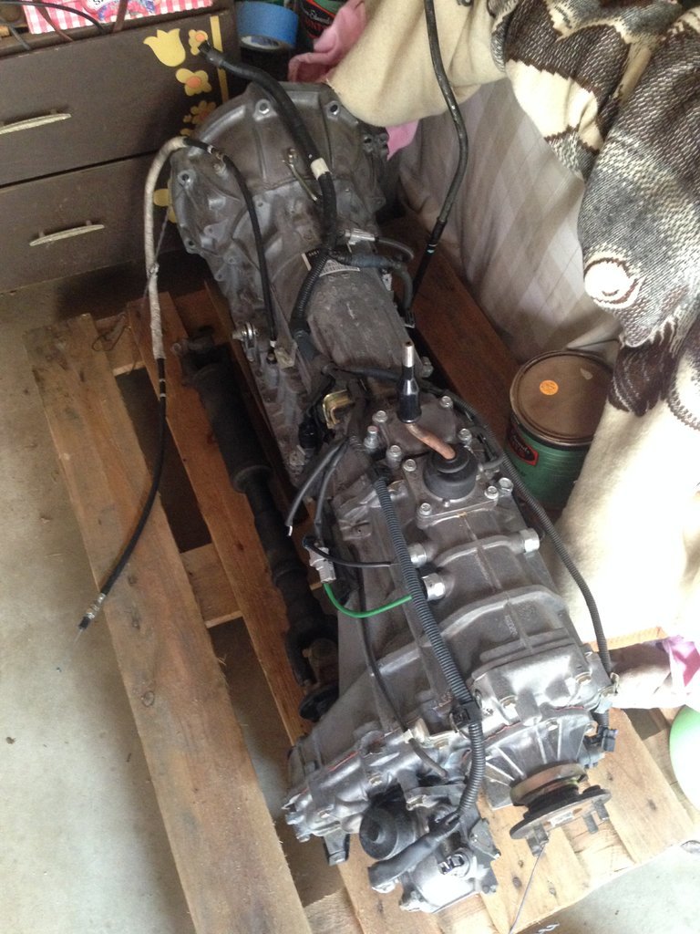

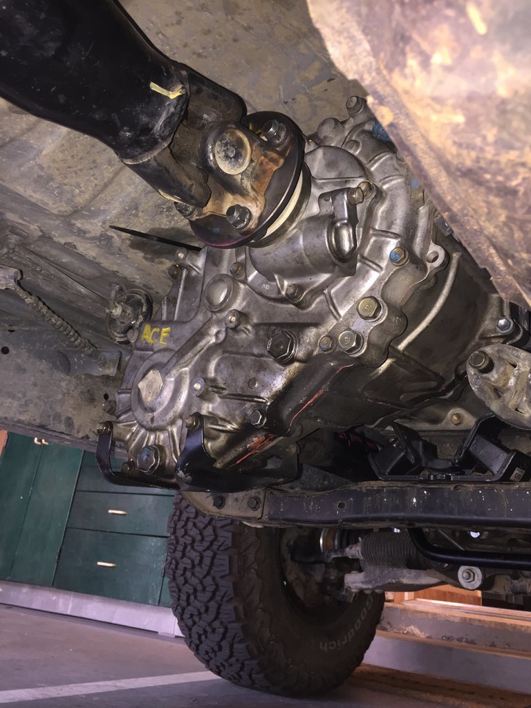

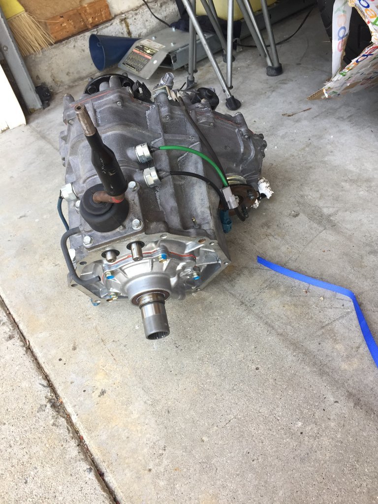

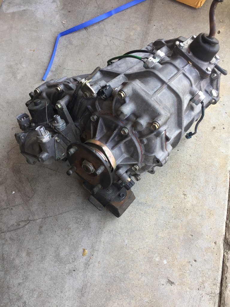

    Now that the front end was all done, it was time for the transmission, transfer case, driveshafts, and interior. I scored an A340F transmission from a Japanese parts importer that only had 60k miles on it, but it was off a Limited 4Runner so it had the special transfer case with the AWD and center diff locker so it wouldn't work for my swap so I had to purchase a standard j shift which bolted right up.
    4Runner t case:

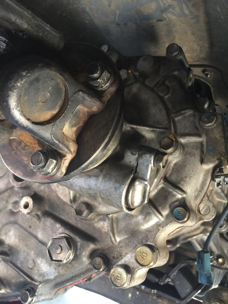

    Note the actuator located on the back of the t case. Here is the t case that's currently on my truck:
    Notice there is no actuator.

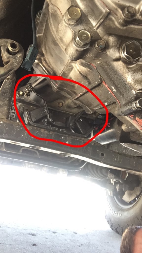

    I was still able to use the 4Runner transmission, just had to be paired with a standard j shift. Another thing to note (if you use a 4Runner transmission) is that the speed sensor on the 4Runner transmission is different than on a tacoma transmission and will need to be modified to work (I haven't figured it out yet, and currently have a non functioning speedometer). Other than that, everything between the 2WD and the 4WD trannies should be the same.
    I didn't have the tools or the knowledge to install swap out the transmissions so I had it done by a local shop. The dude who installed it said it went smooth and wasn't complicated at all.

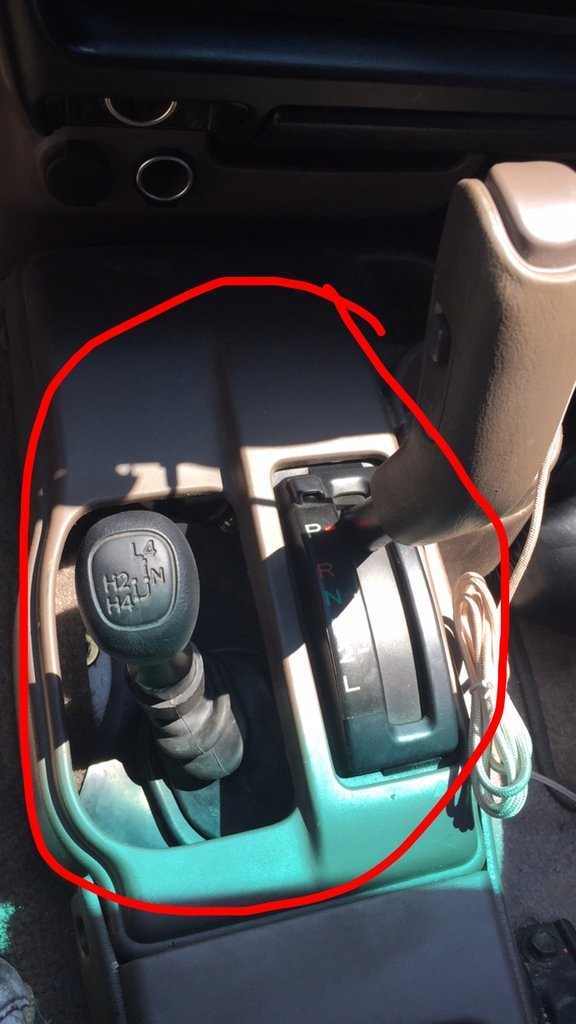

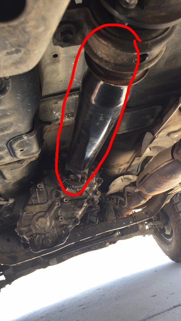

    Pics of parts needed:
    Transmission and transfer case
    Front driveshaft
    Front section of rear driveshaft
    4x4 Transmission mount
    Interior shifter housing

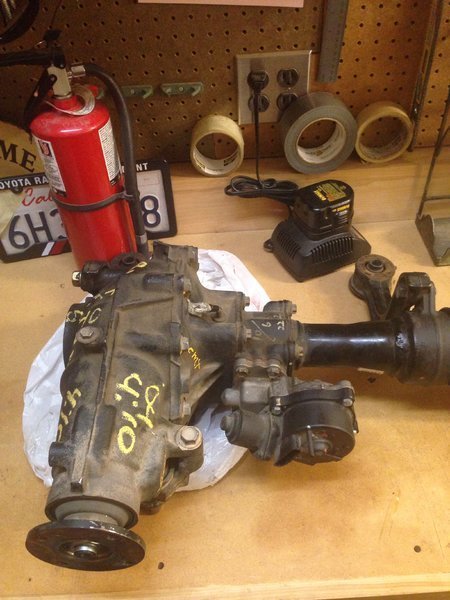

    Front differential (with gears matching rear diff). The diff I used has the ADD system, but is permanently engaged in 4WD

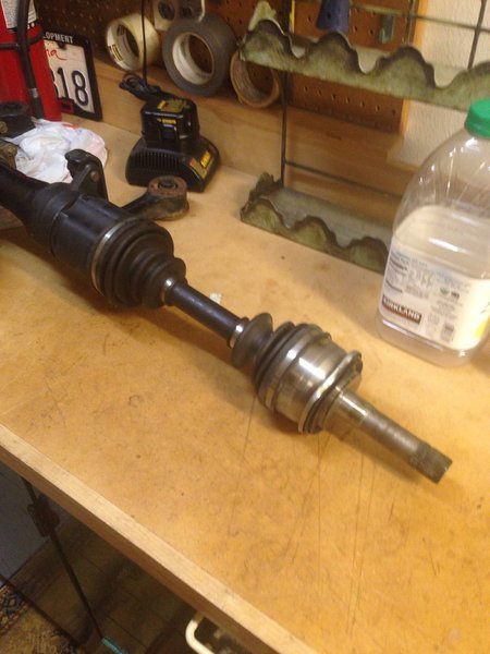

    Passenger/driver CV axles
    4WD spindles

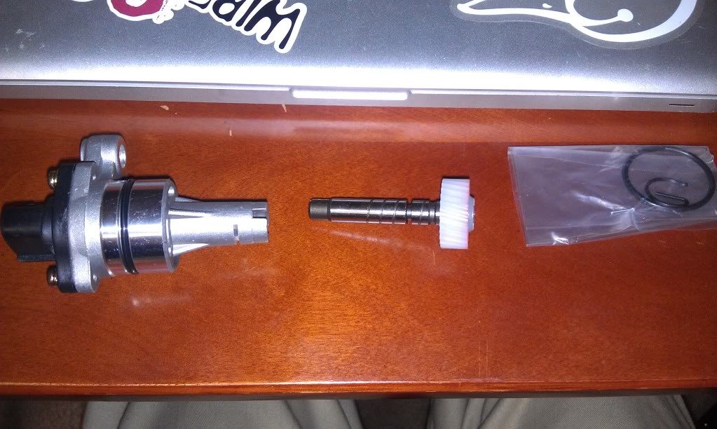

    Remove the VSS unit (speed sensor) and you'll see a nylon gear. Chances are you need a larger gear as the teeth aren't currently meshing.
    I lucked out through TTORA (Hytenor) and I was able to score a few different gears from him, find the one I needed and send him back the ones I didn't use... Here's the thread

    Is the VSS on the back of the transfer case?

    Yes

    So this little piece just unbolts?

    I replaced mine, can't remember the part number but with 33s it was dead on. I ordered the 28 tooth count

    Yes. I have manual hubs and my diff is ADD. the ADD actuator on the diff can be permanently locked into 4WD by using a little collar to hold the actuator in 4WD, essentially making it a manual diff. You need to make sure you know for a fact what gears are in your truck, if you get the wrong diff youll fry your transfer case pretty quick
