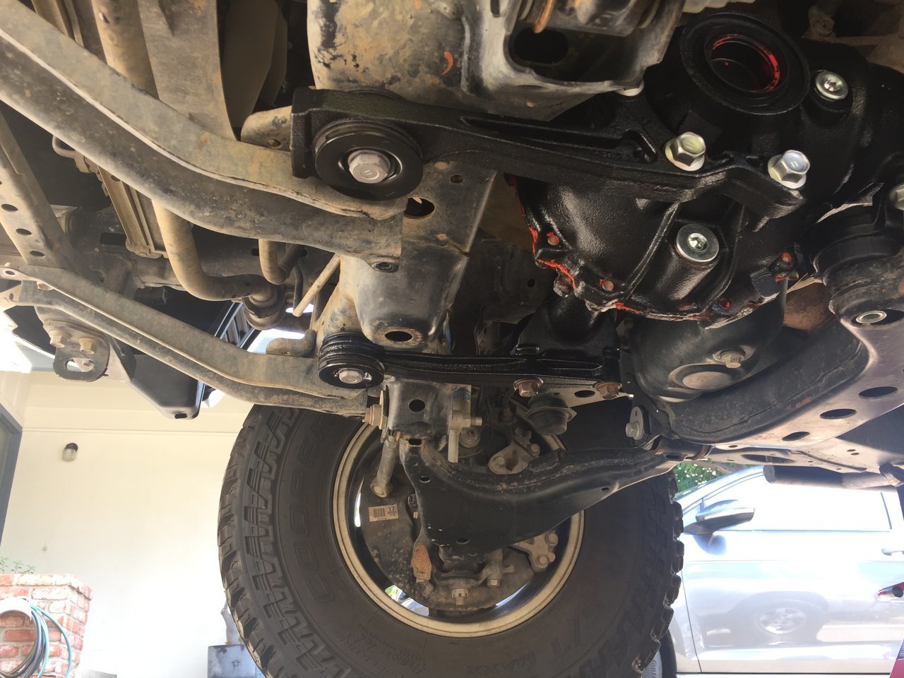

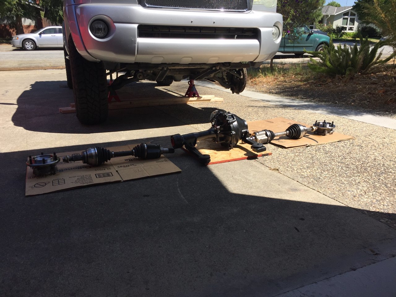

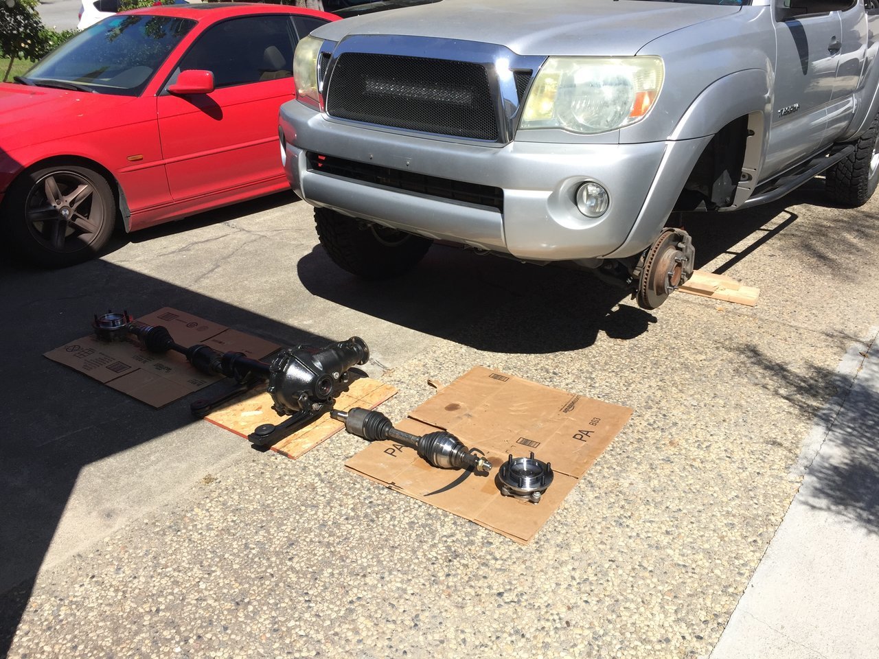

    I will be using this for a pic dump of my 4x4 swap in my prerunner. Since I realized this was possible I researched as much as I could to gather info on it so if anyone else wants to know the process I will try to make this as comprehensive as possible. I am starting out with a 6 speed and using an FJ t case along with a non-ADD front diff out of a 4runner. By doing this I eliminate all of the electronics with the tcase and diff and dont have any 4wd ecu to deal with.IMG_3291.jpg

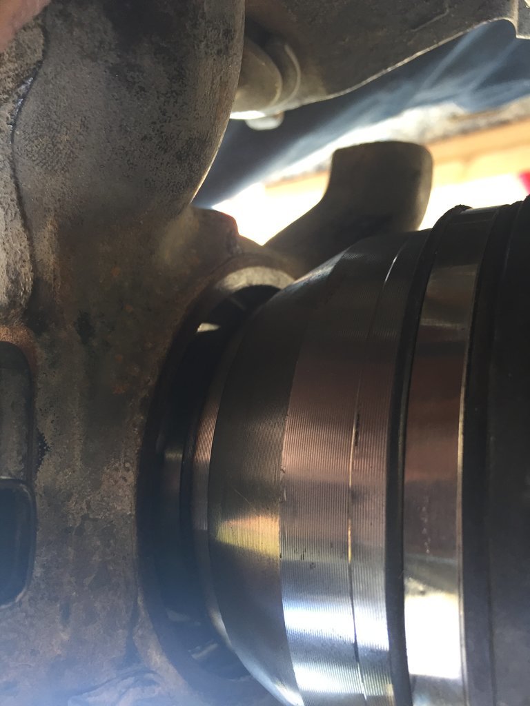

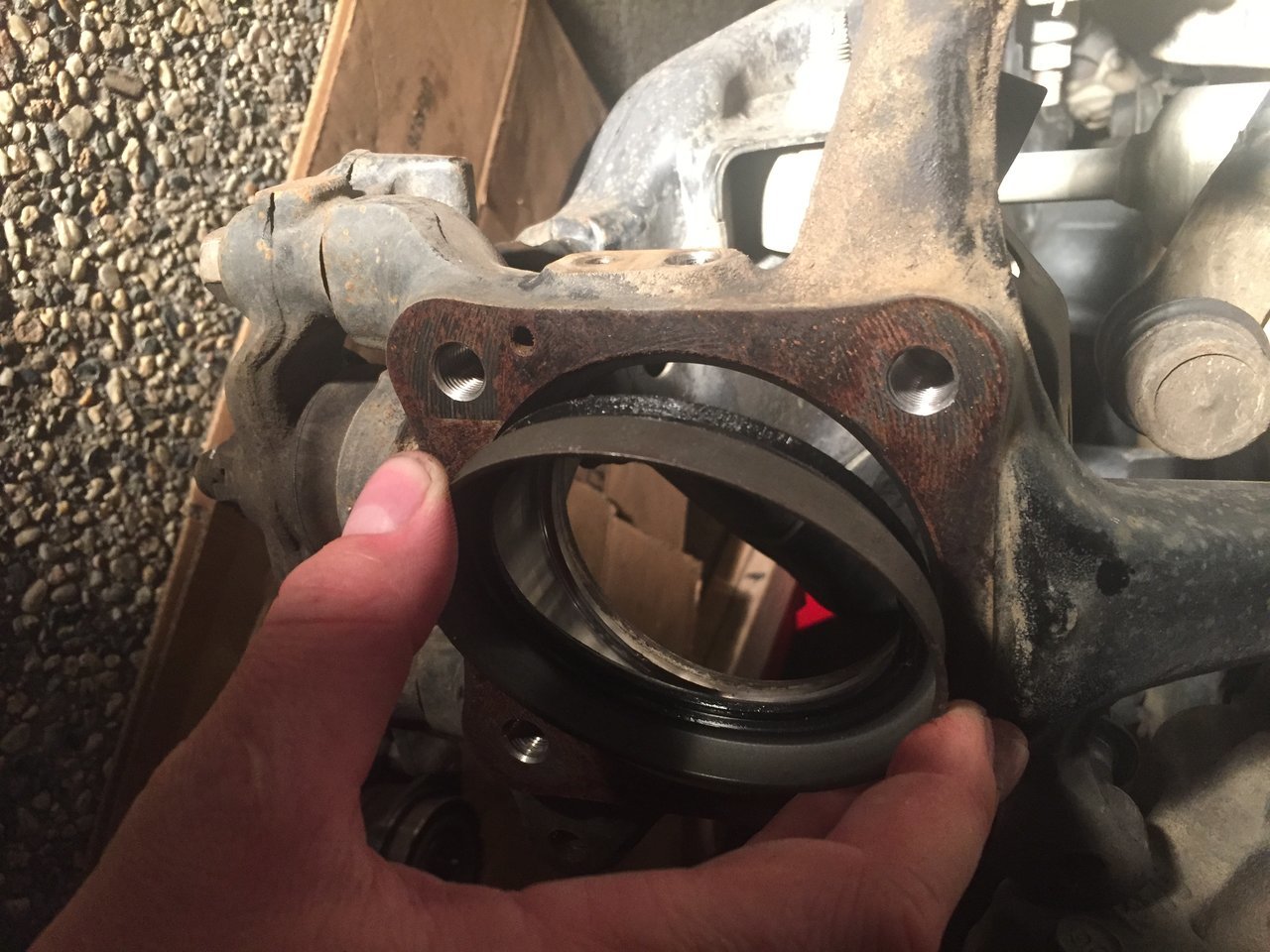

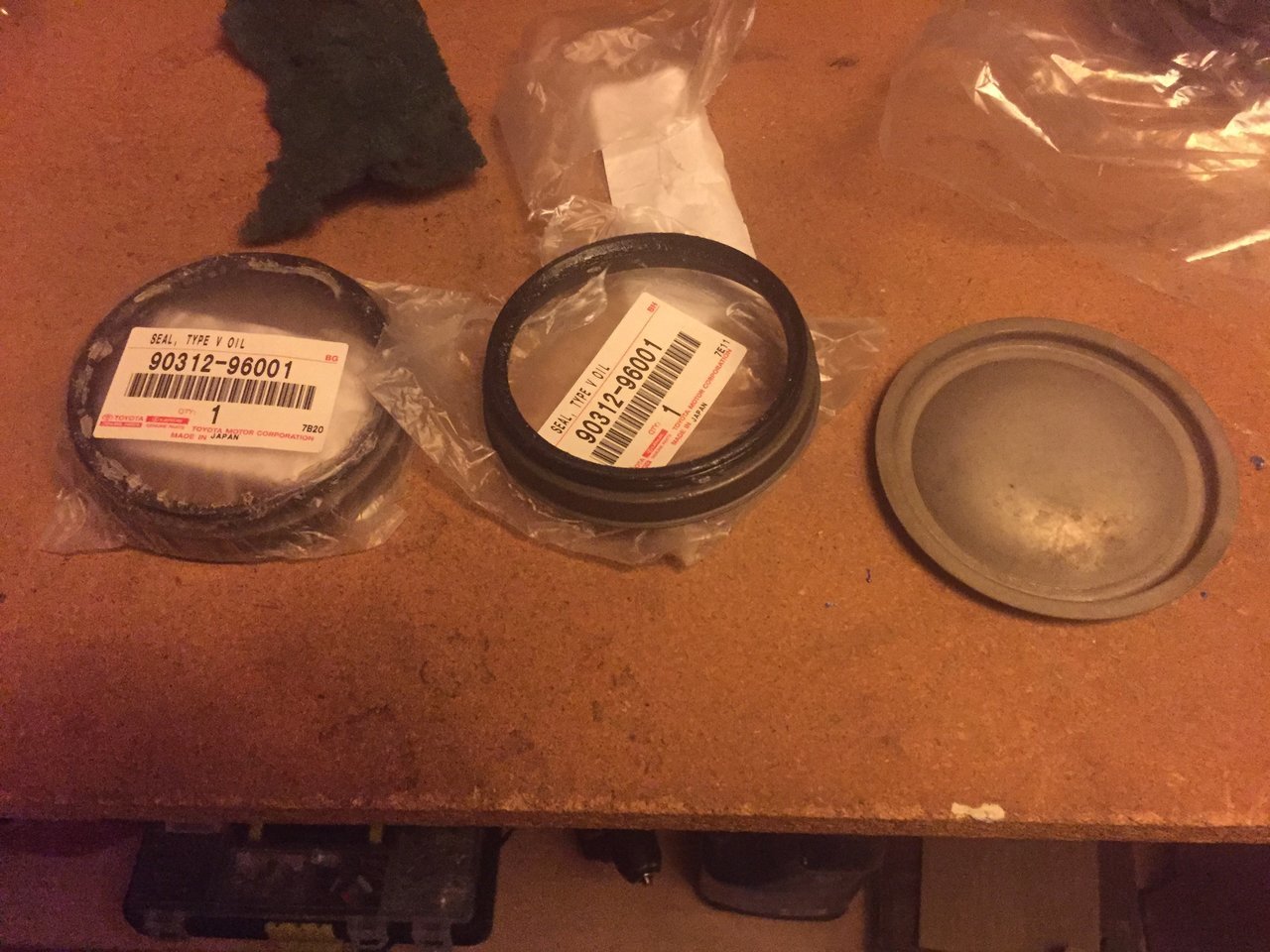

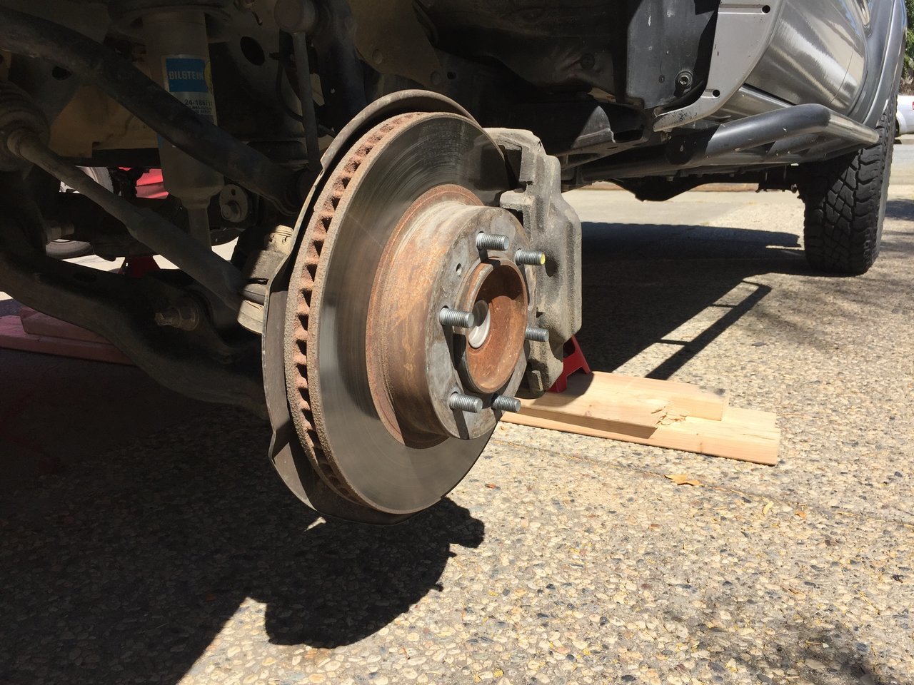

    Quick question, does anyone know if your 4x4 spindles are a smooth bore all the way thru? I am trying to press in the dust caps on the back side and they dont even seem close??

    From what I remember the prerunner spindles should be the same as the 4x4? the only difference being the dust caps for the different hub designs?

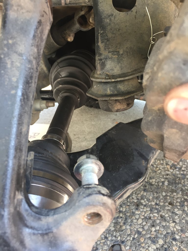

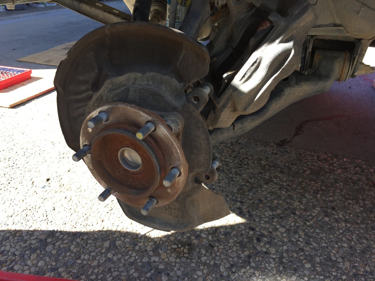

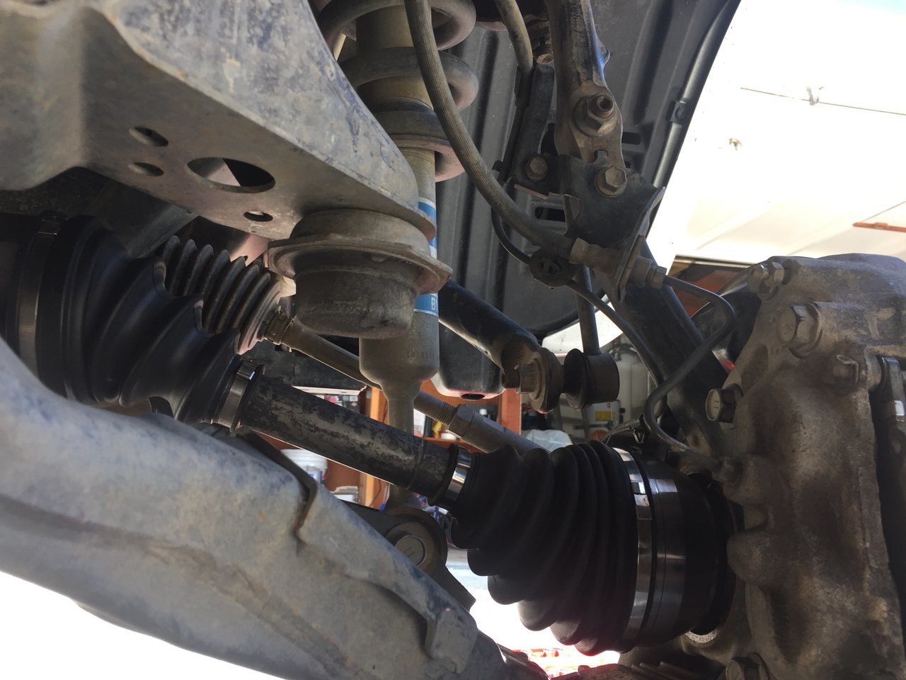

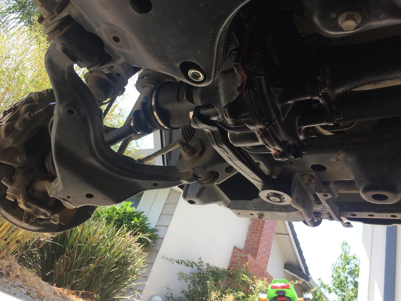

    More progress:
    The front driveline is on and everything is all buttoned up.

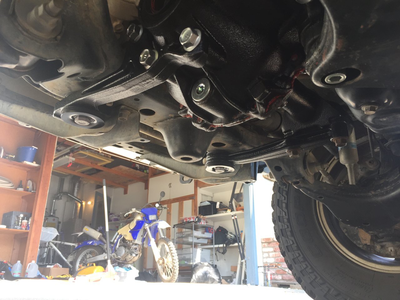

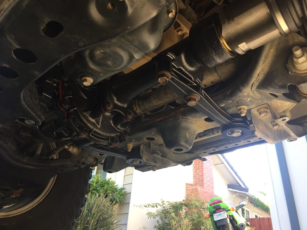

    First thing was mounting the diff and getting all the fasteners snugged up, having everything relatively clean helped a ton. I know that my chassis had all the 4x4 mounting locations but never fully believed it until the diff was sitting up there..
    New 4x4 hubs and wheel bearings
    Axle clearances
    The only thing that I had issues with was the dust caps on the spindles the ones I got were not close to pressing in and I guess I did have the ones that go on the CV housings so I will need to order those and pull it apart and put it all back together. luckily everything is clean and fresh so it shouldnt take to long the second time around.
