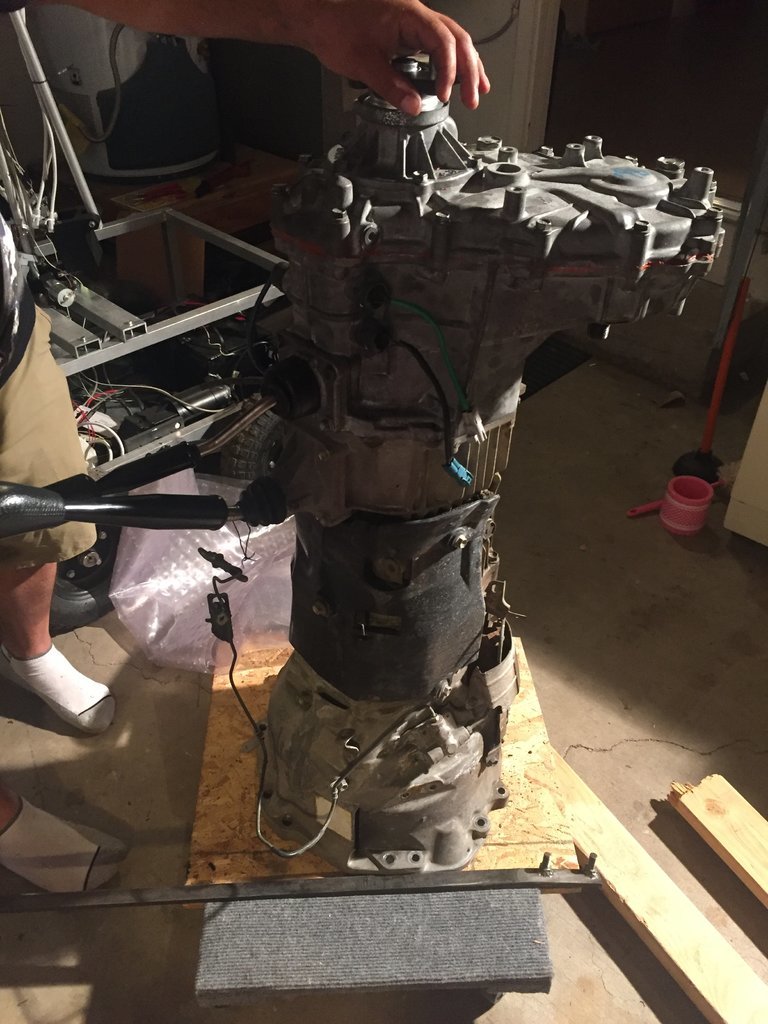

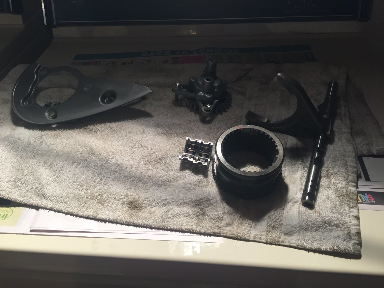

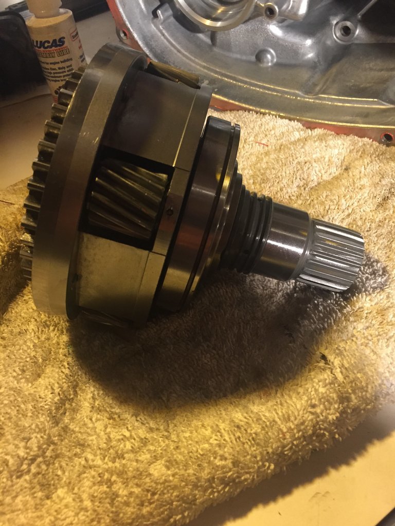

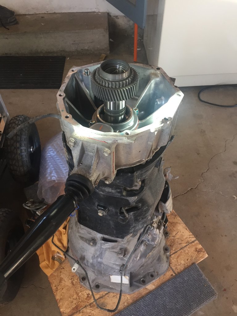

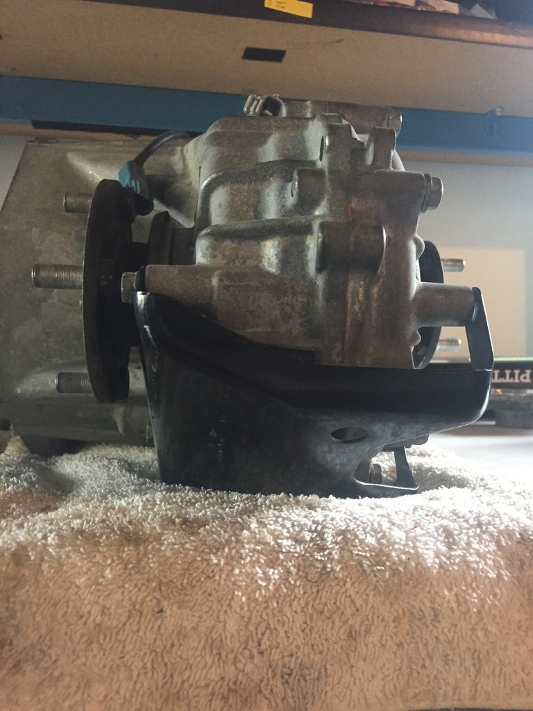

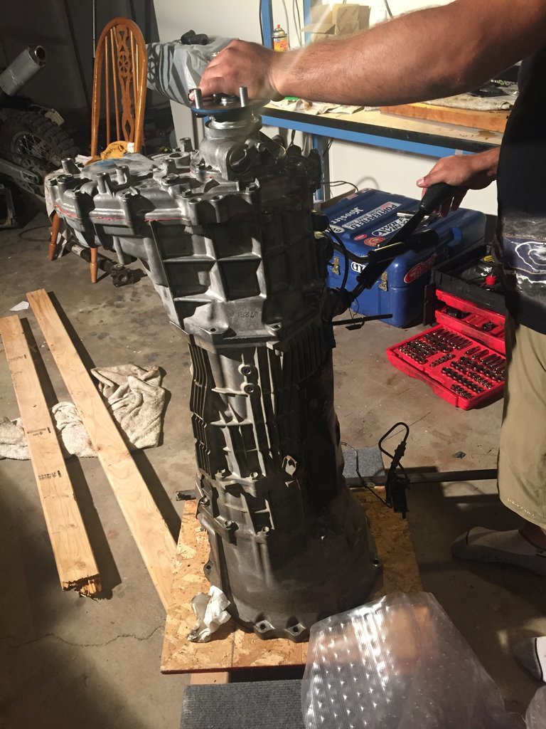

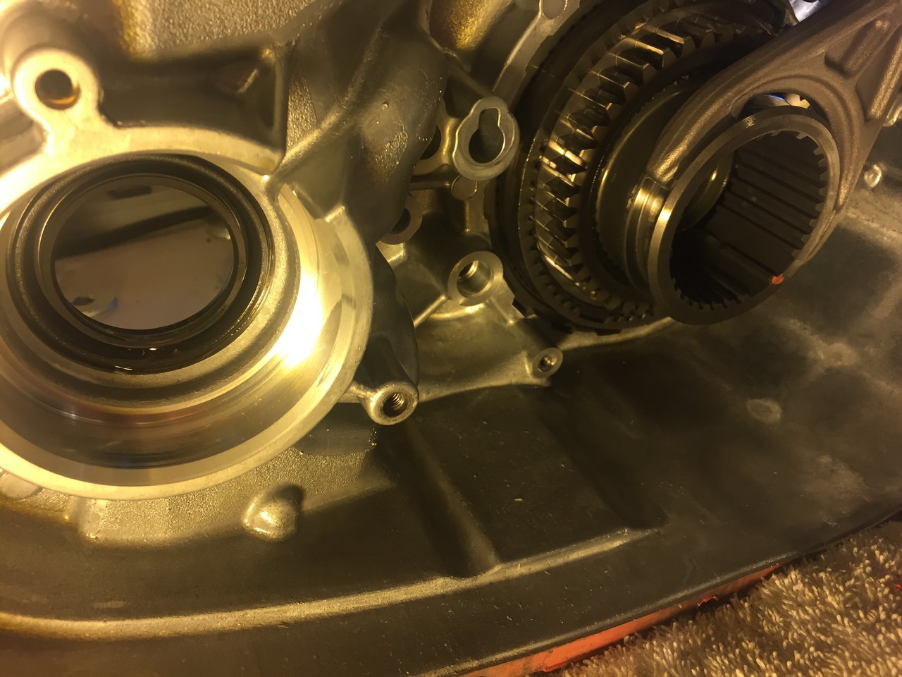

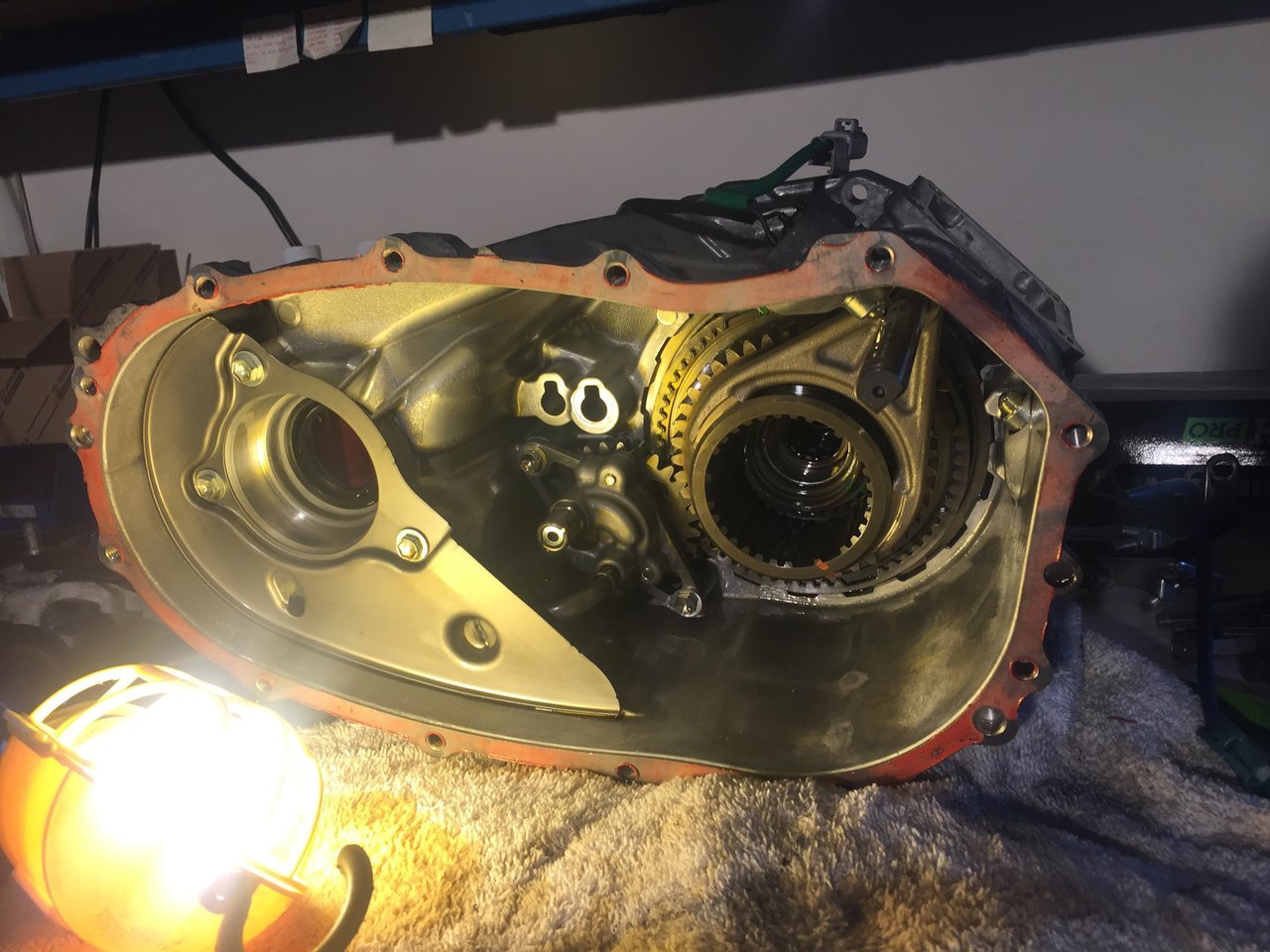

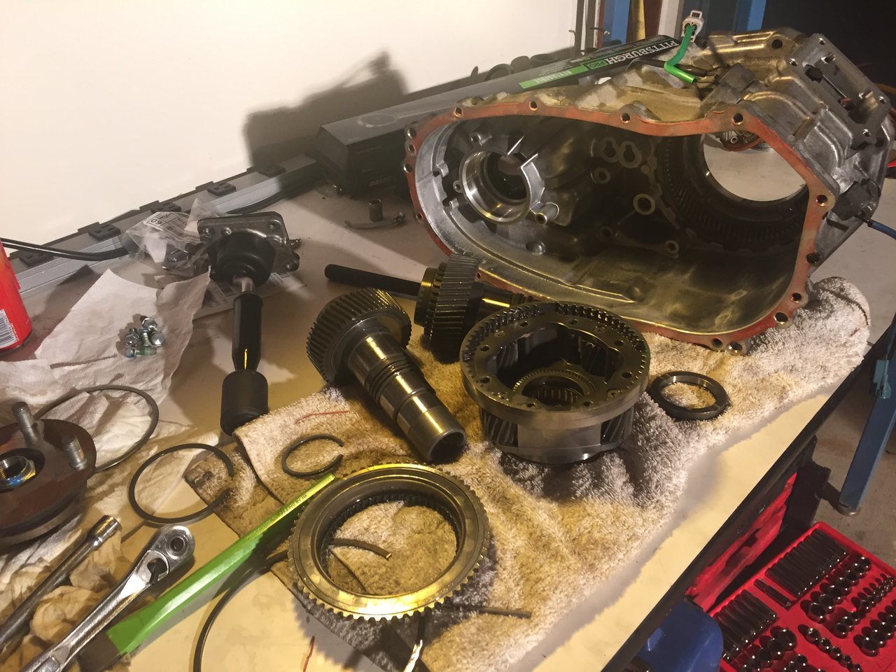

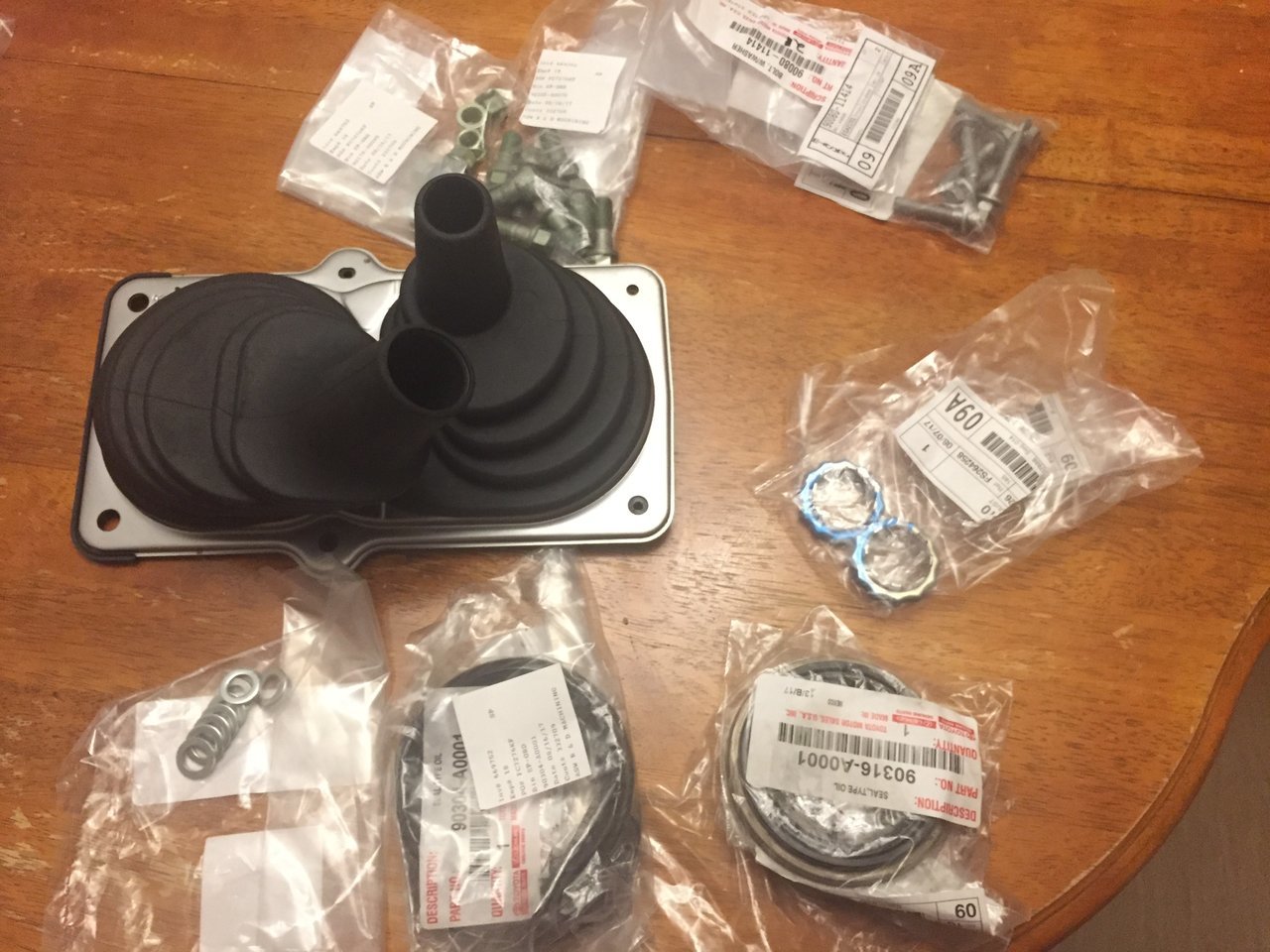

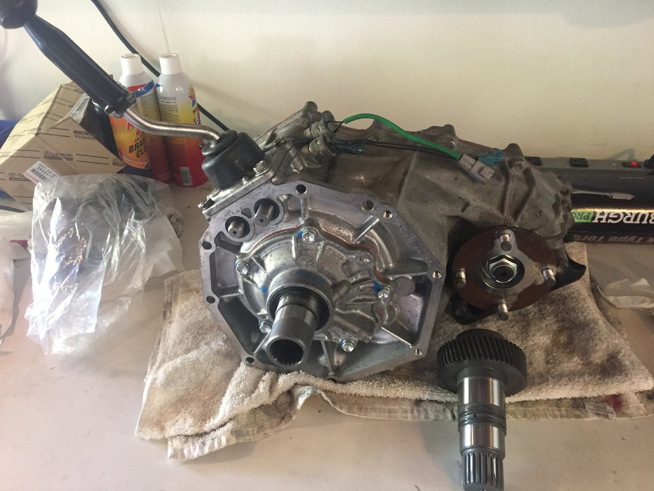

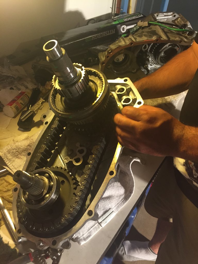

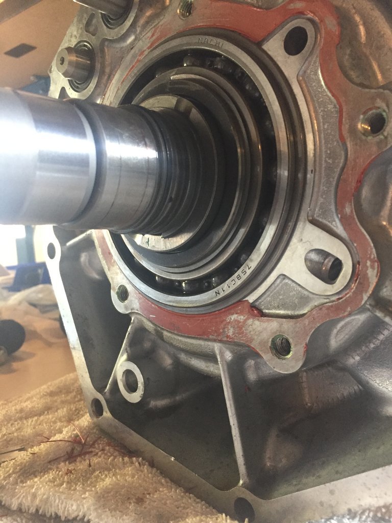

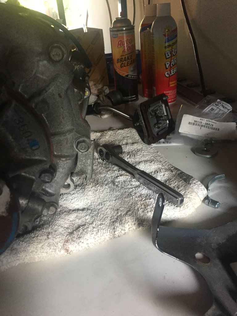

    Finished up the transfer case the other night. It was pretty cool taking it apart and seeing how everything worked
    Thats the shaft that needs to live inside the tcase
    Manual v auto input shafts
    input shaft cover and front pinion flange were the first things which needed to come off
    split the case to get to the oil pump and planetary gear set
    oil pump out
    gear set finally removed along with both input shafts
    operating room aka washing machine..
    All buttoned up, the huge snap rings suck if you dont have the right pliers, which I didn't..
    getting everything ready on the side of the case, I ended up greasing the 3 little keys which the 4x4 engagement gear slides over otherwise there was no way they were going to hold themselves in there while sliding the big ring gear over them and putting the cases back together
    final test fit/sanity check. everything ended up going back together and shifted smooth and buttery thru the 2wd,4wd,4lo. the levers contact each other in a few positions so I will need to address that. in 2wd I wont be able to get into 5th or 6th. I have a URD short shifter on the way but im going to have the cut the t case shifter to angle it more passenger and potentially forward depending on how it looks when its bolted up to the truck.
