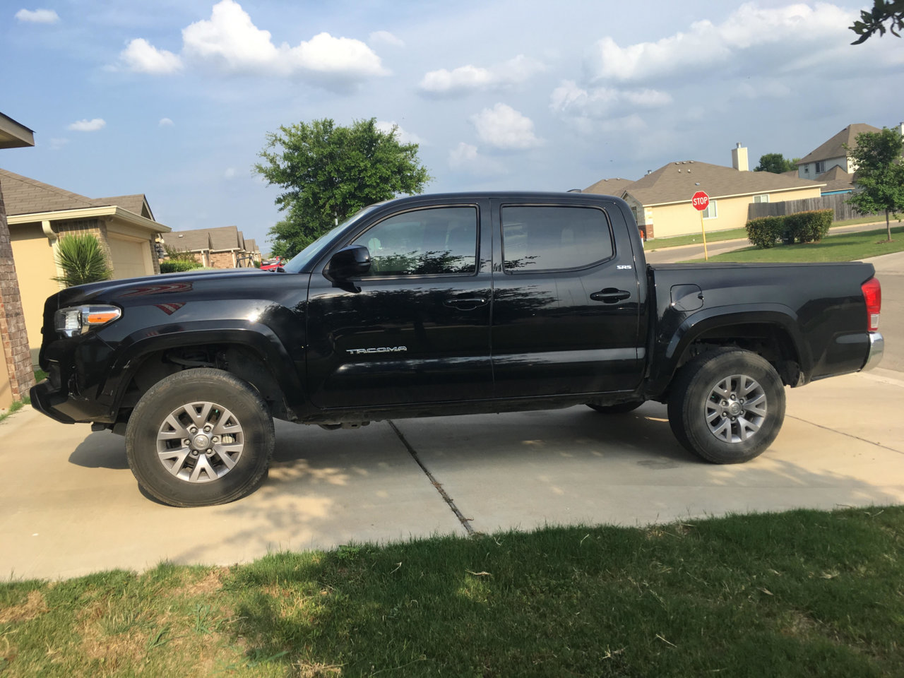

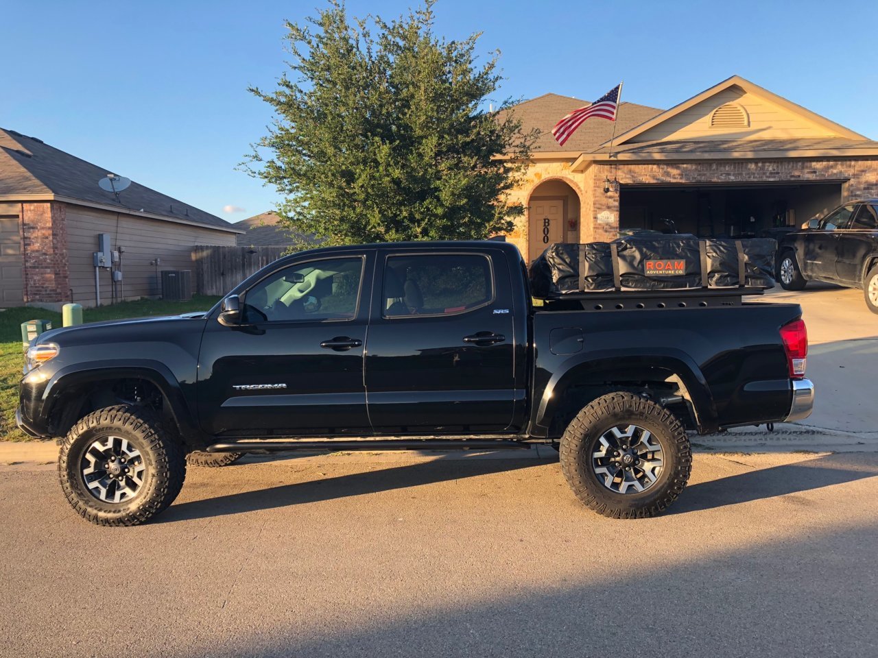

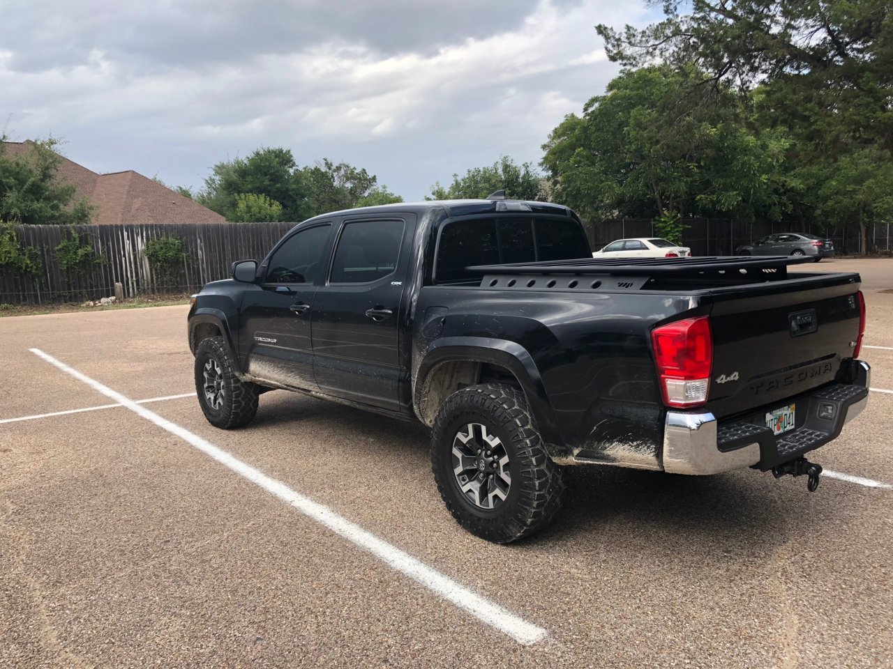

    Current Pics:
    Progress Pics:

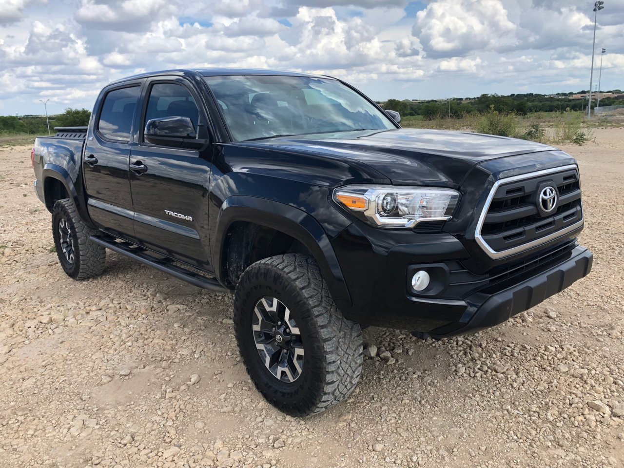

    Stock Pic:

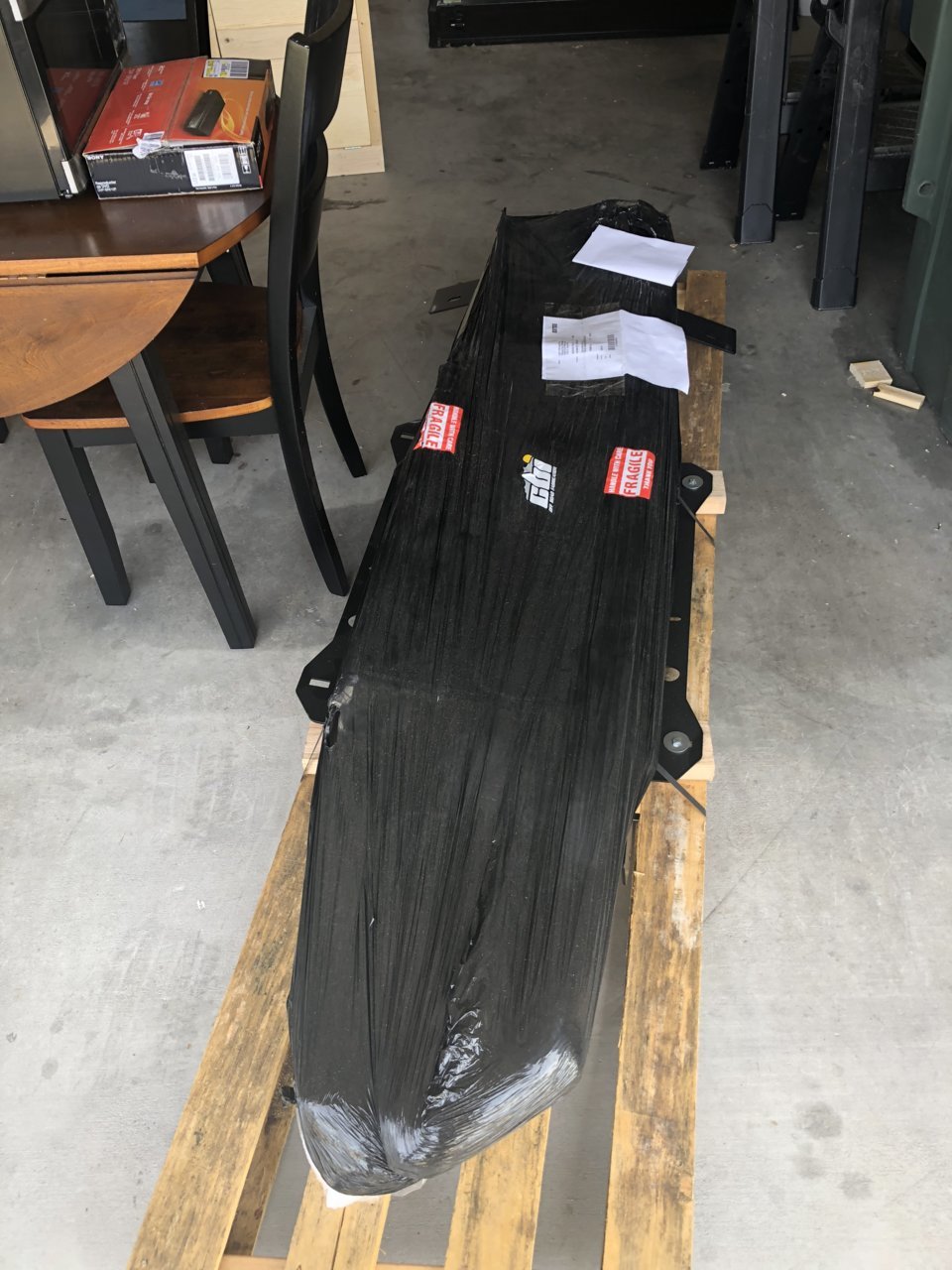

    My rack arrived yesterday, and will install today. Had a mini freak-out because I hadn't thought of the weight capacity of the bed rails themselves - and the rack I ordered is supported solely by the rails. After google and forum searches resulted in nothing but "I think the rails support 200 lbs", I dug into the manual which states "Do not exceed a total tensile load of 440lb (200 kg) per deck rail." My very limited engineering knowledge tells me that tensile stress is basically a pulling stress, and my brain is struggling to understand how a pulling stress would be applied to the bed rails (youtube/internet reading didn't really help). Either way the manual reads to me that each rail can support 440lbs, combining for a total supported weight of 880lbs between the 2 side rails; which will be more than adequate to support the weight of the rack, a RTT, my GF and I and our 2 dogs.

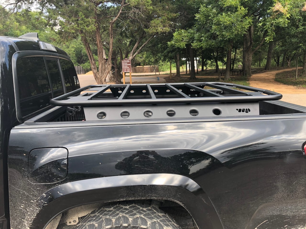

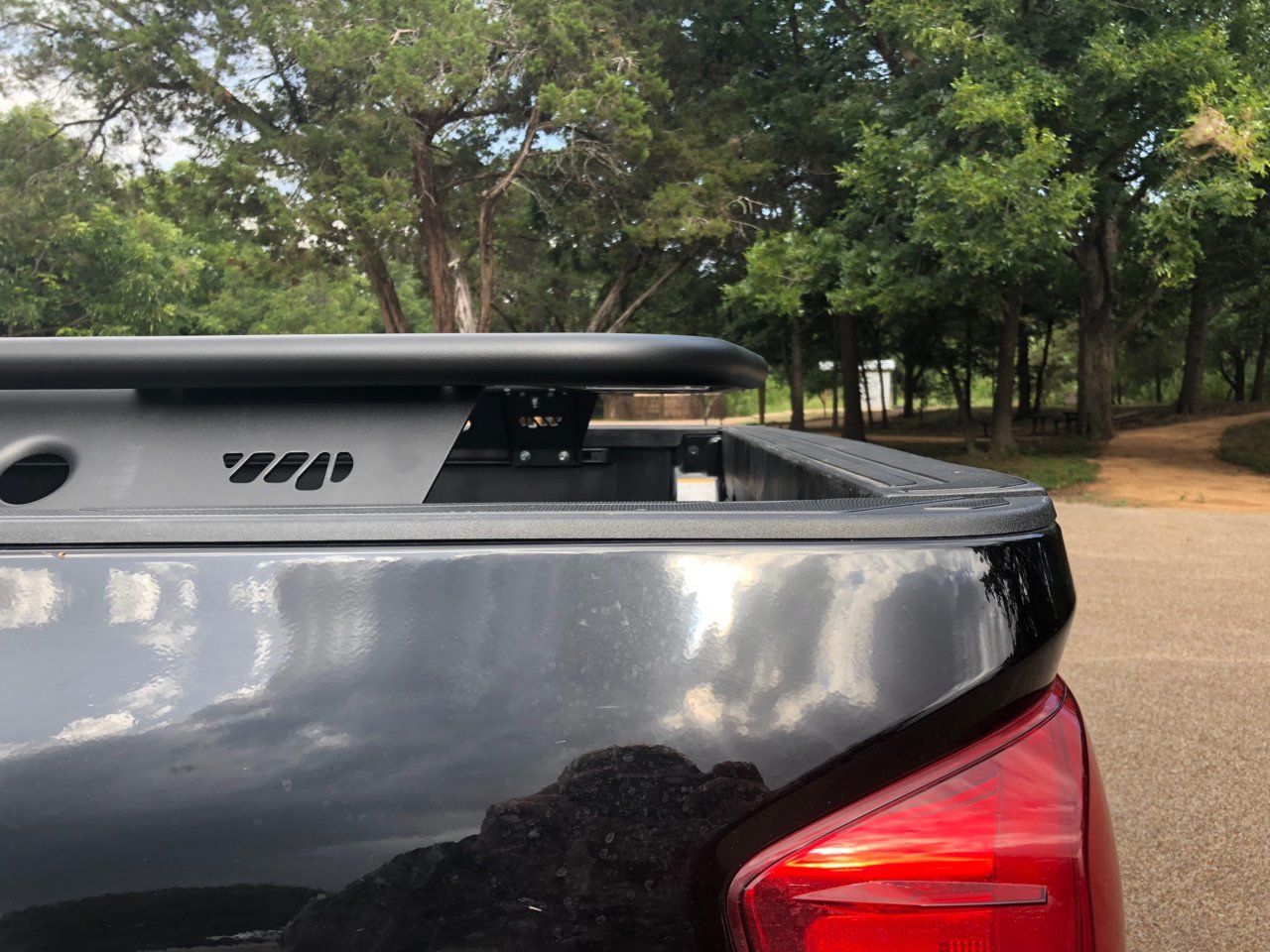

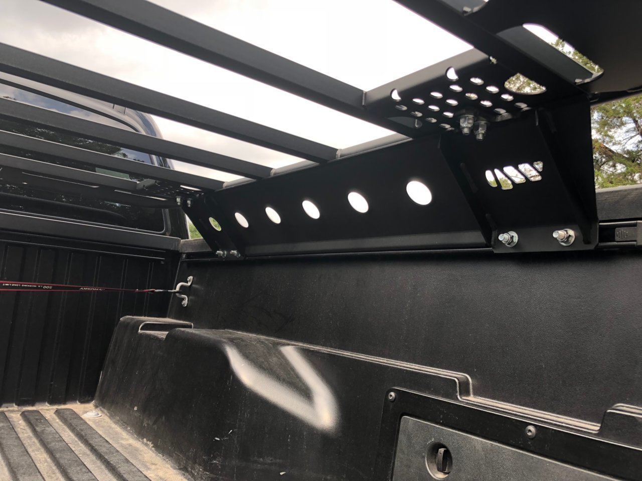

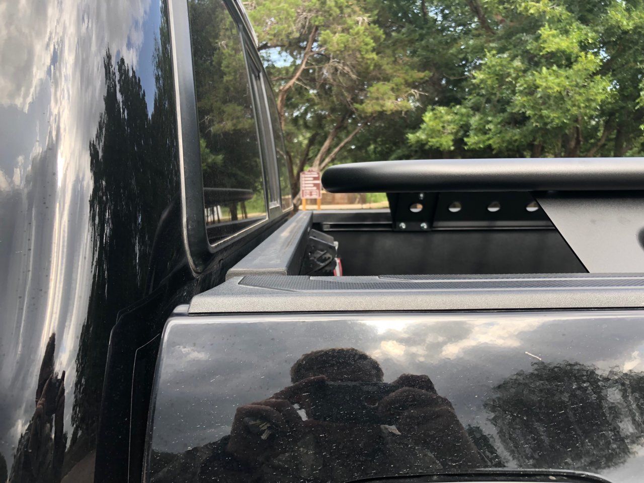

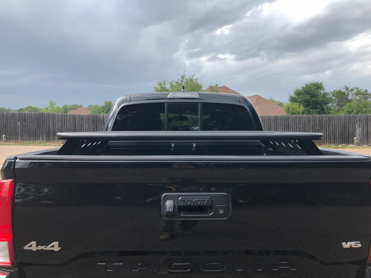

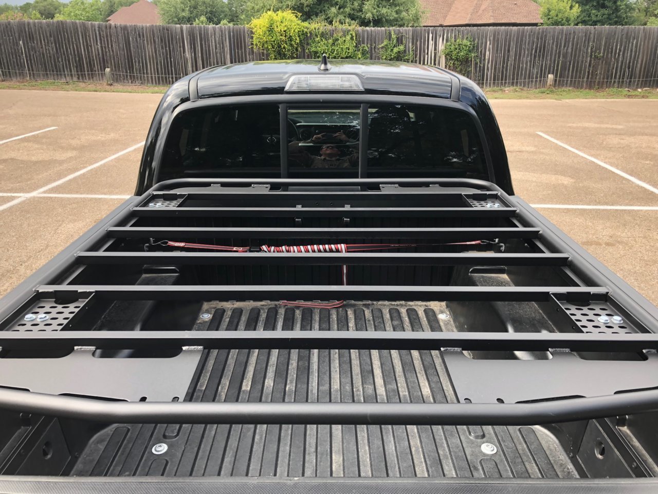

    Installed the Warrior Products rack! Really pumped about it. Seems to be a great product that will suit my needs perfectly. Install was super quick and easy - took a total of 45 minutes from unboxing to cleanup. It does feel solid - I did a jump test after installing and it didn't seem to flex or bend the rails in anyways. I opted not to install their included tie bar as I felt it would take up additional usable space in the bed. Ordered some Total Chaos bed channel stiffeners to prep for the RTT.
    Pros/Cons / why I decided to go with the Warrior Products Bed Rack
    Pros:
    1. Low to bed profile
    - Will keep the RTT low and shouldn't affect the aerodynamics / fuel economy.
    - Should have room to mount kayaks to a cab rack and not interfere with the RTT when it is packed up and mounted.
    - Won't obstruct my rear view when RTT is not mounted.
    2. Security
    - The solid side mounting brackets and multiple crossbars should stop anyone from being able to take bigger items from my bed when the tailgate is locked. I hate the idea of leaving anything unsecured in my bed and this seemed like a good option since I'm losing my bed cover.
    3. Weight
    - Shipped weight was 75 lbs. When installing it really could not have been more than 50lbs.
    4. Warrior Products is based in Tualatin, OR! I went to Tualatin high school, so obviously had to support the hometown!
    Cons:
    - All the things I like about it being low come with a trade off. I see that tradeoff being limited usable vertical space in the bed and accessibility. However, I think I can mitigate these tradeoffs with a drawer/slider system.
    2. Supported solely by the bed rail system. As we figured out in this thread, I believe this won't really be an issue. However, it probably is better to have the weight supported by the caps instead of only on the bed rails. Time will tell.
    All in all the pros outweighed the cons for me.
    And of course, pics:

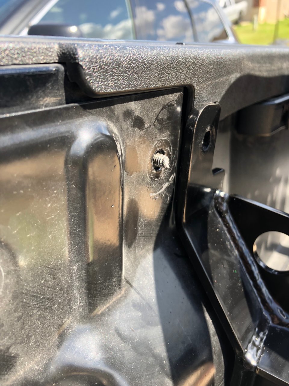

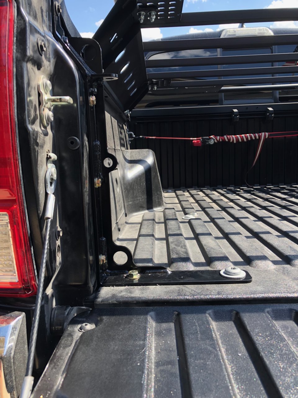

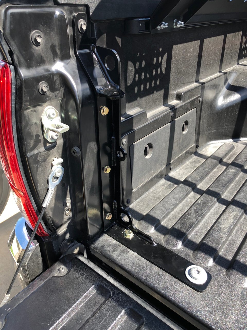

    Installed a pair of Total Chaos Bed Stiffeners. Easy install. I made one rookie mistake and over tightened a bolt on install which caused the bolt to shear in half. Was fun trying to get that out. This was also a milestone for me because it was the first time I have ever drilled a hole into a vehicle sooo... cherry popped. Anyway, should be ready for a RTT now! Won't have a chance to play with the truck for the next 4 weeks due to a field exercise, but that's ok because my CBI sliders should be arriving about the time I come out of the field!
    Of course, pics:
    My casualty for the day, RIP. I re-purposed a bolt from the headlight housing to take this ones place. So the headlight is holding on with just one bolt until I can get my hands on a replacement.

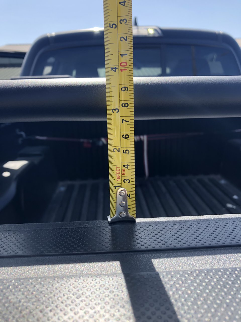

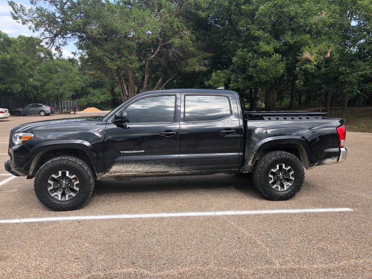

    Got out of the field for a few minutes and got some measurements for you @Scoutman (and really for myself too).
    Distance from the top of the rail caps to the bottom of the rack is just under 2 3/4 inches:
    Distance from the bed to the bottom of the rack is just under 21 3/4 inches:
    Ps: found out my truck looks great with a yeti 65 in the back (not mine, but maybe one day :fingerscrossed:)

    When you did the bed stiffeners, did you have to tap the holes you drilled? I haven't drilled into my truck yet and am a little nervous of doing something like that! But this looks like a mod I want to do.
  8. Jul 22, 2018 at 8:30 AM
    prest14
    prest14 [OP] Well-Known Member
    May 30, 2018
    #254996
    188
    Temple, TX
    2017 SR5 4x4
    Bilstein 6112/5160, TC UCA, Dakar Medium
    No tapping required! Each bolt is secured by a nyloc nut behind the tail light housing. I was nervous to drill into my truck too; however, I think this is probably the easiest mod for drilling that can ever be done. There really is no chance to mess up the holes and have to re-drill. Before drilling, the bed stiffeners are already secured in place by two factory bolts into factory holes on the horizontal portion, and secured by one factory bolt into a factory hole on the vertical portion. So all you have to do is place your drill bit into the existing hole and drill it out - no measuring required.

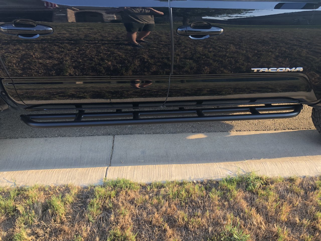

    GF just sent me a pic of the sliders that were just delivered! And early too. Only two weeks left of this field problem and I can install these bad boys!
    Beretta4x4 and ChadsPride like this.

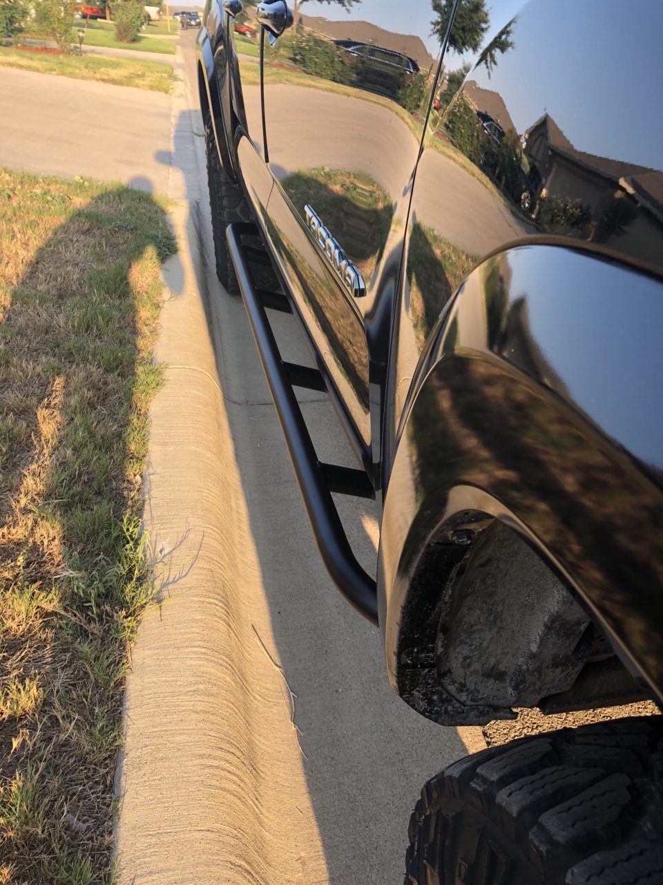

    Well Fort Hood is actively burning down so all training areas shut down for a few days. This means a break from field time and a chance to install my CBI sliders!

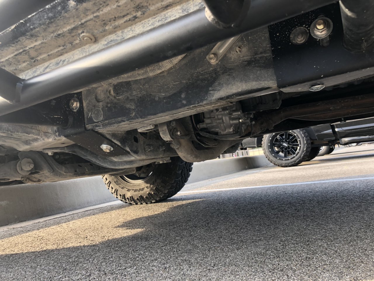

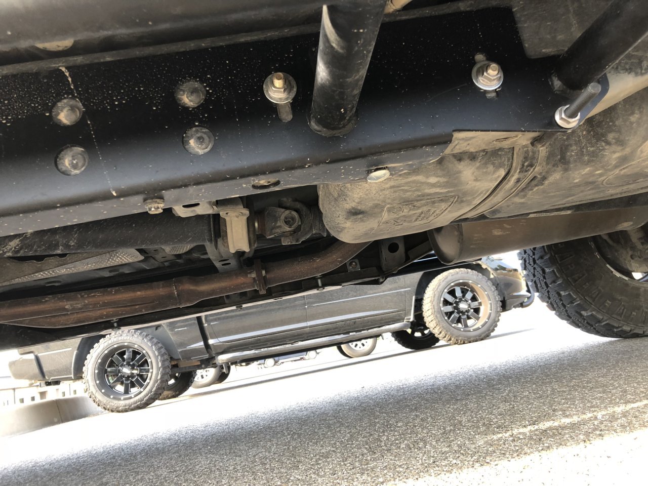

    I hadn’t read the instructions prior to installing, so I was pretty surprised when I found myself elbow deep inside the frame of my truck trying to thread a nut onto a bolt! If you try to install yourself, I recommend starting with the passenger side - it will give you a good idea of where the holes will line up so you can visualize what you need unscrew from the driver side frame in order to install (the directions confused me a bit as I didn’t really know what I was looking at). Getting everything lined up by myself was a bit of a struggle but it is possible!
    E9922B0C-94F8-46D1-BB85-292C70B36BE0.jpg 824AC10A-3048-4EAB-BF61-52372A5FC240.jpg 2218389A-1A48-4284-8619-444F49A811C2.jpg

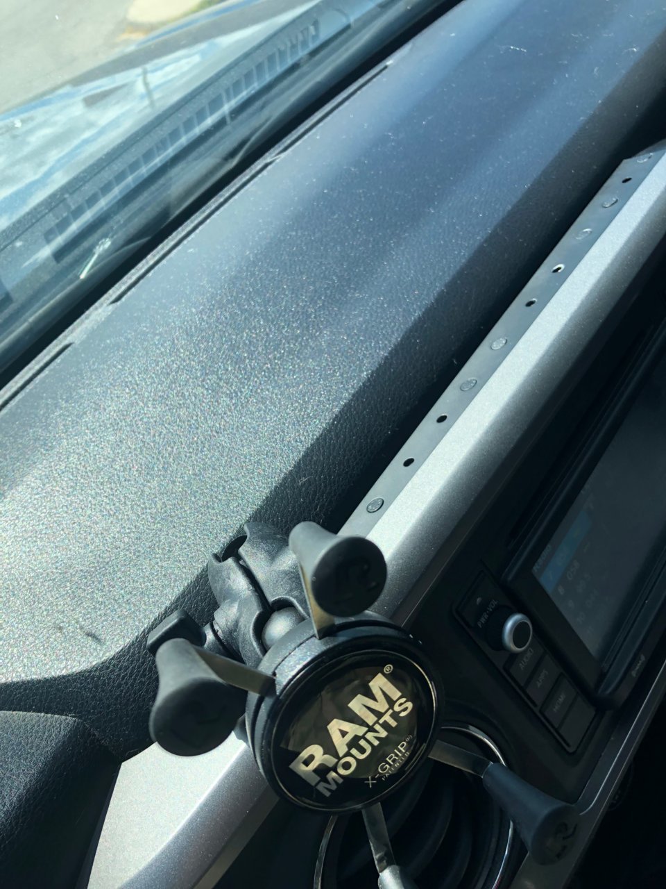

    Installed the Taco Garage Dashtop Multi-Mount. Easy install, and provided me the second opportunity to drill some holes in my truck. I really like how low-profile this is - I can't see the mount from my natural sitting position, and neither could the passenger riding shotgun. I had to really lean forward to even notice that the mount was there. Also a big plus that I can retain full use of my vents, and have room for expansion if I decide I need to mount anything else. Great product @FreshMexicanTaco!

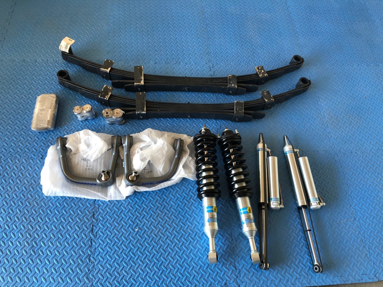

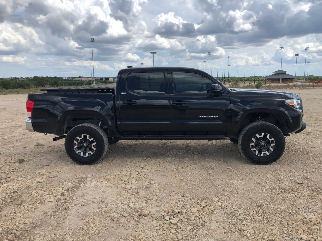

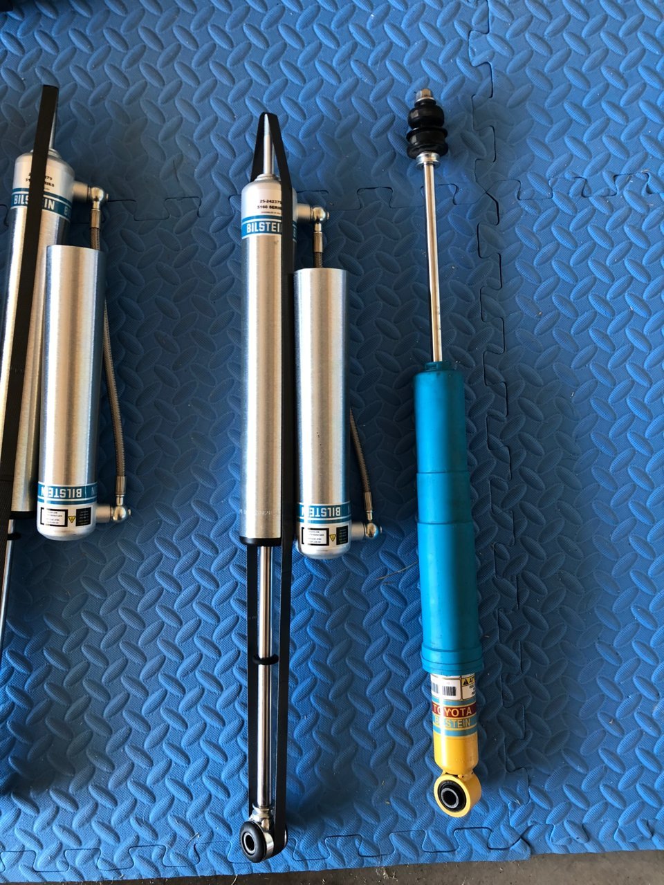

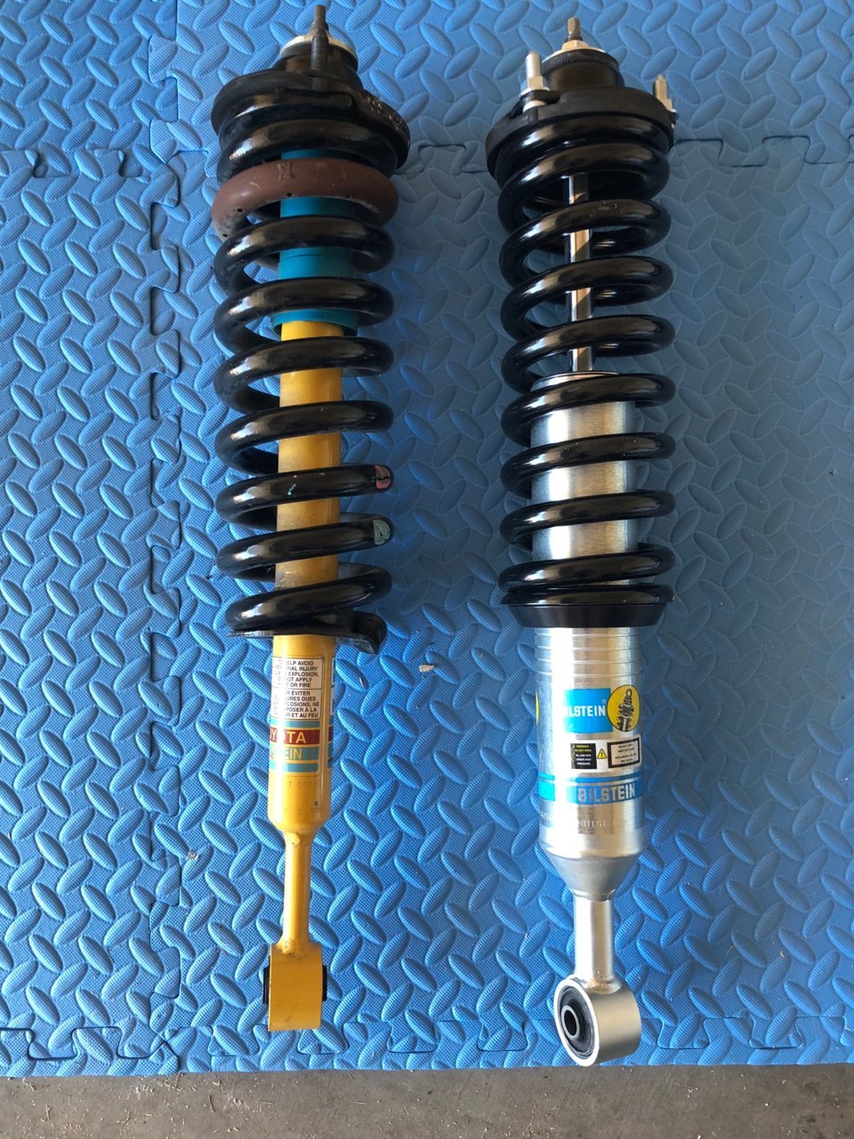

    New suspension arrived and damn is it beefy! I know I said I wanted to do all the work myself, but looking at all this stuff has got me a little nervous - might look for a local shop to do the install...
    Here are the 6112s and 5160s compared to the stock OR suspension. Can't imagine what they would look like next to my stock SR5 suspension.

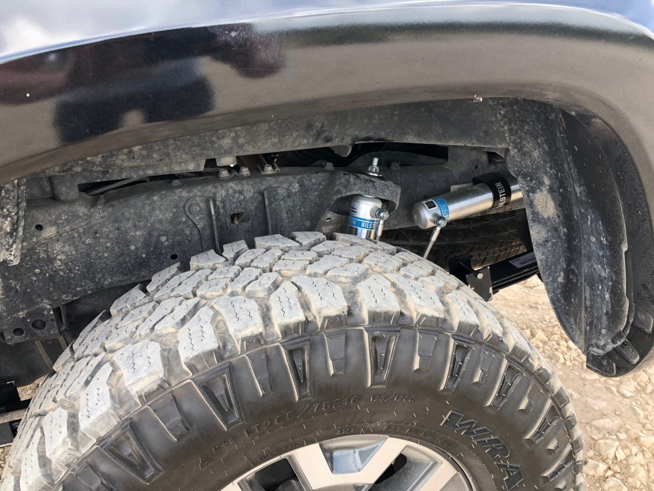

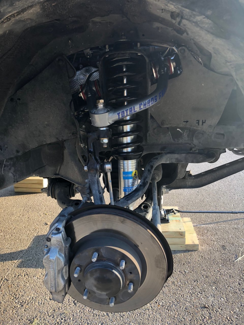

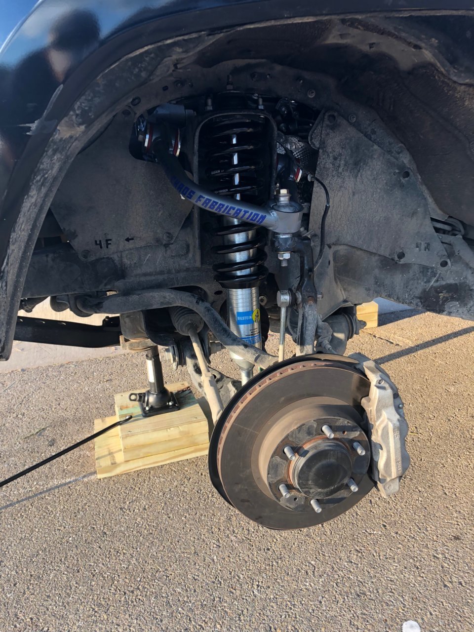

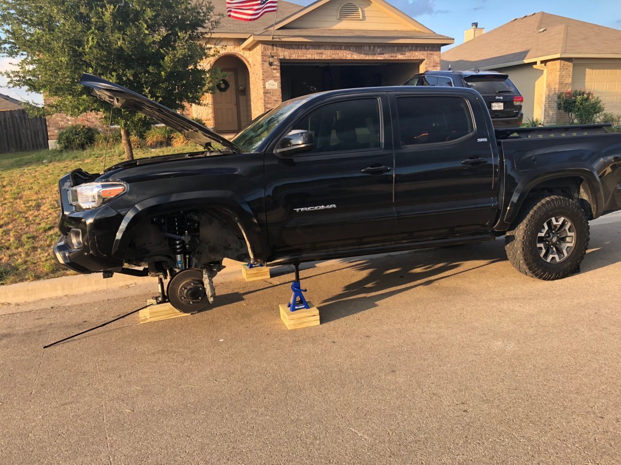

    Finally got around to installing my new suspension! Got through the front half today. Will tackle the rear tomorrow then get it into a shop for an alignment. The 6112s went on easy once I figured out how to get the truck off the ground high enough. The UCAs were a total pain in the ass tho. All-in-all it took me about 6.5 hours to to the front end. I have some serious reverse rake happening right now. Gonna hold off on full pics till I get the rear put on.

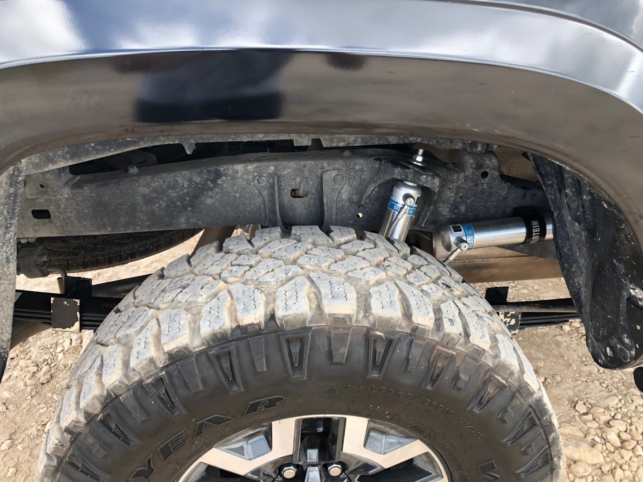

    Butt lift happened today. Finally got the 5160s and Dakars installed. I'm honestly surprised I didn't duck it up haha. Anyways loving it! Love the new stance and I can already feel such an improvement from the stock SR5 suspension.. unreal.

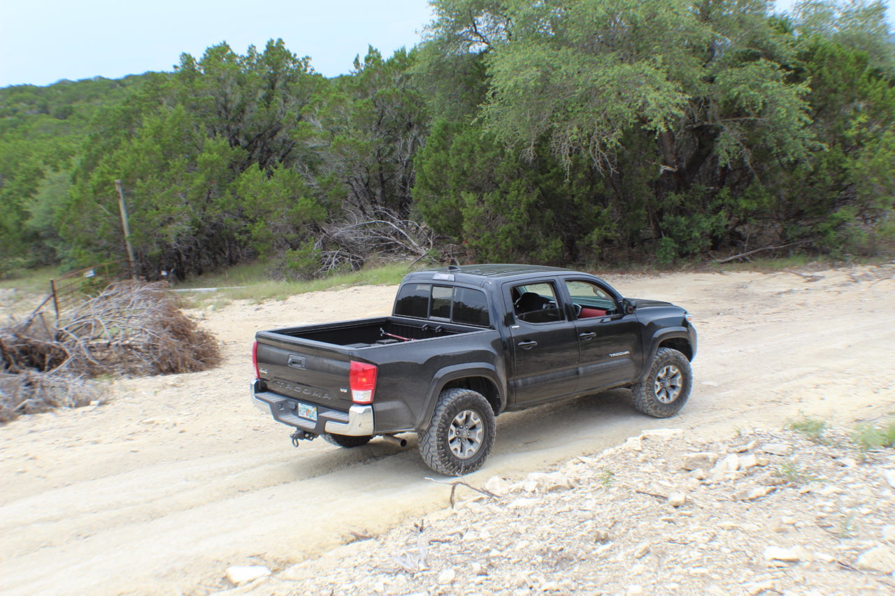

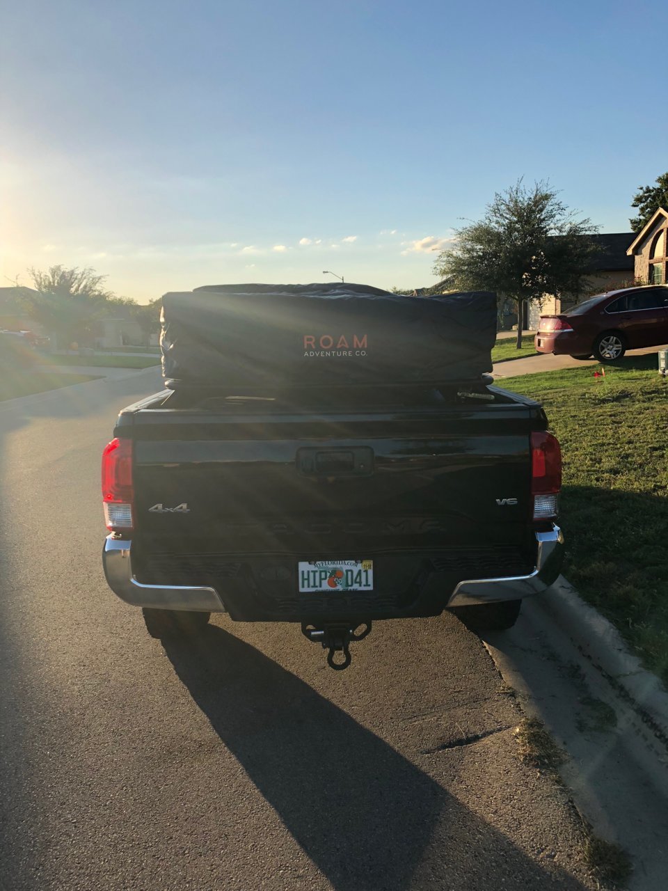

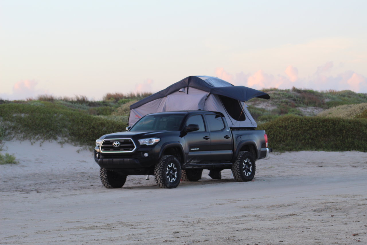

    Finally got the RTT! This thing is sweet. Ground sleeping is for suckers. Went with the Roam Adventure Co Vagabond 3. Local company to Austin TX that offer a lot of features standard that others offer as upgrades. It held up great to wind and rain on its maiden voyage to Padre Island National Seashore. Didn't get quite as far down the beach as I would like since we were camping with a group - but it was still fun to test the new setup!
    I did notice that with everything loaded down, the back end was sagging pretty good - probably should have gone with the HD Dakars instead of the mediums.
    Also, the Warrior Rack did absolutely fine with the tent and everything loaded down.
