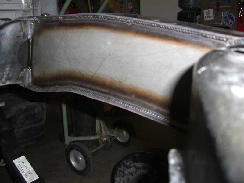

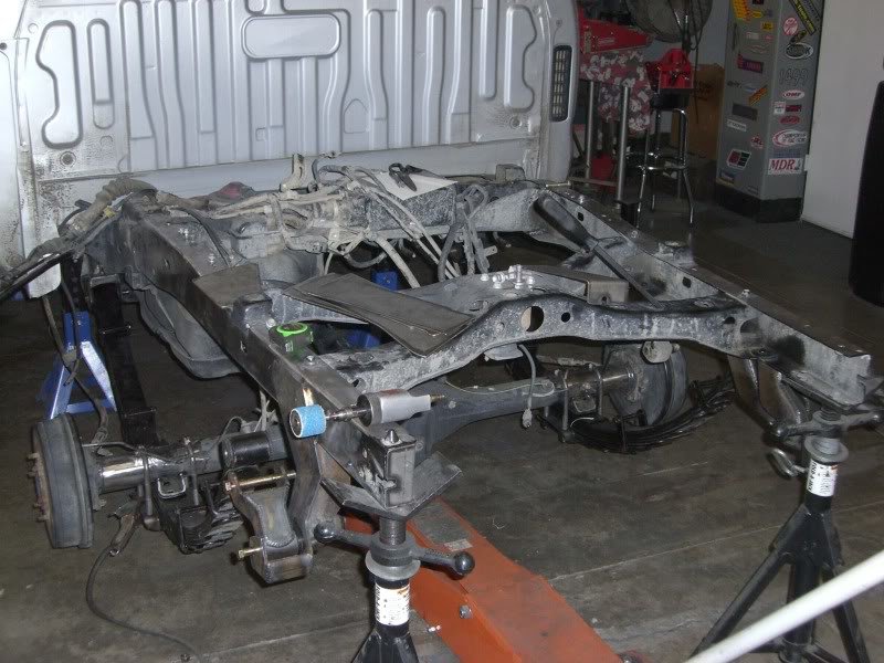

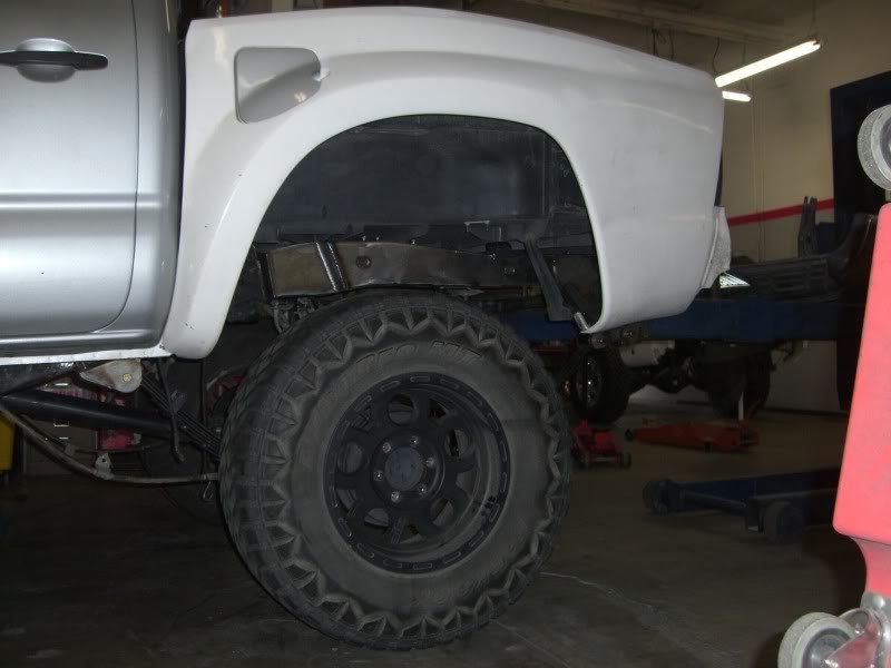

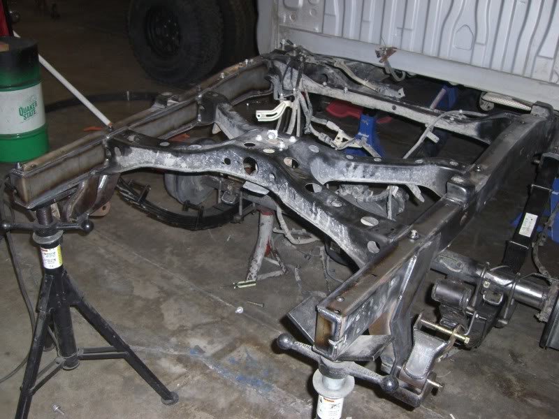

    If you're going to have rear LT, i think its good to have the rear c-channel frame boxed in. IDK if its essential once you get a rear setup, but it would prevent any flex or bending in the future. Preventive maintenance! Heres mine.
    The stock crossmember (X) was left because my fabricator believes that it actually is a very structurally sound part of the frame. Its a big X and it supports both the top and bottom of the C-Channel. Its just a bitch to plate around it. Some people have cut it out and add their own crossmember, which i think is good as well.
    I had to box the frame anyways because i have a fat notch in it lol

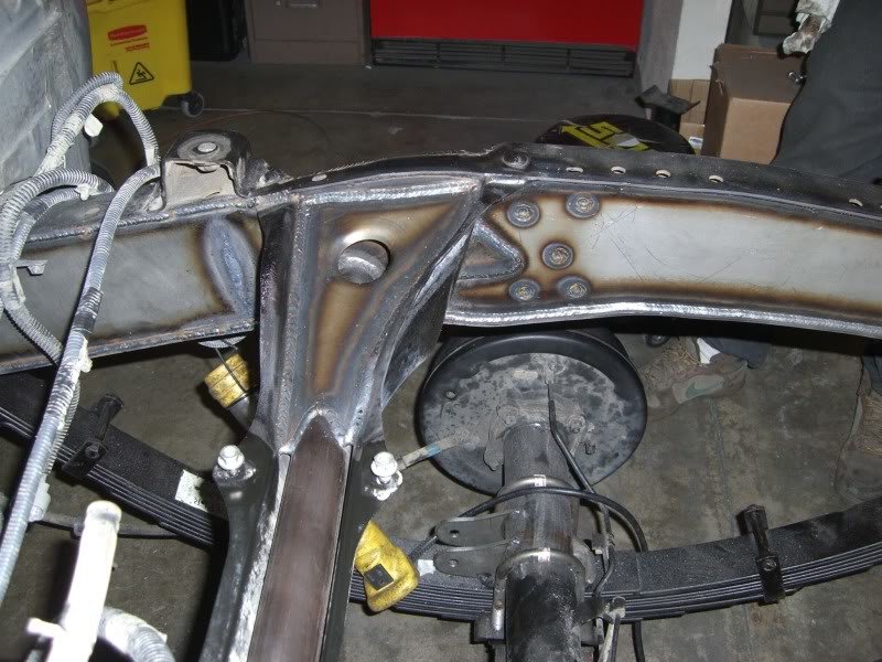

    thats very good frame plate work. ill get a pic of mine.., you can make it yourself....
    heres mine..

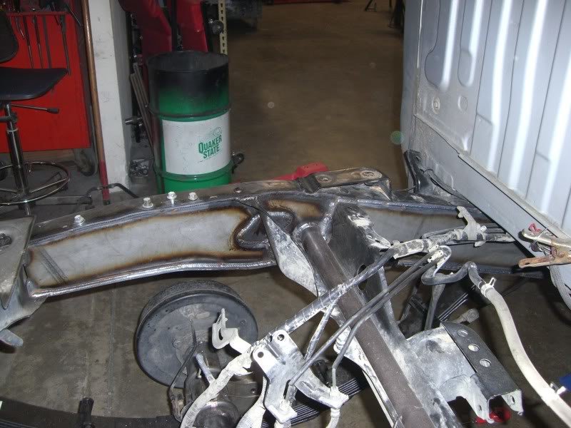

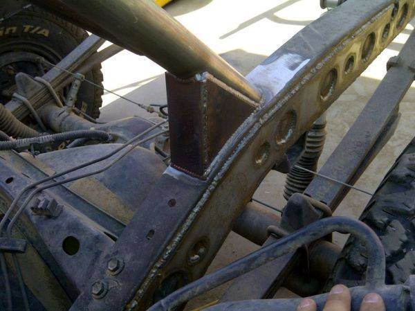

    Boxed frame is a good idea. Here is the only pic I have of mine. Also moved the hitch up into the frame rails and welded it in

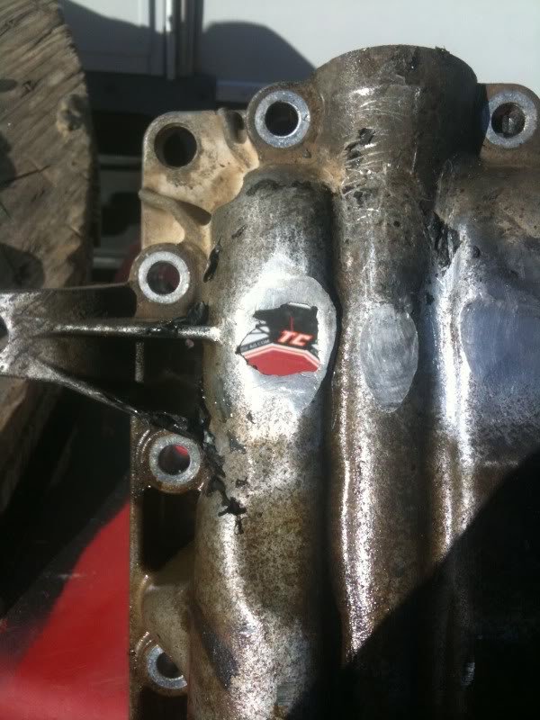

    I would like to emphasize motor mount gussets again. My engine smacked the front diff so hard it blew a hole in the oil pan.
