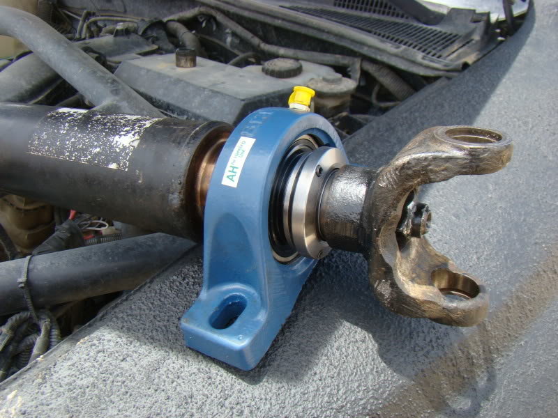

    Anyone know what bearing that is?
    DistortedAxis likes this.
  9. Sep 25, 2012 at 11:33 AM
    #49
    Cr250jumper
    Cr250jumper Señor member
    Dec 2, 2010
    #47033
    11,968
    The moon
    50 shades of tan©
    Tacoma with some stuff melted to it
    A few posts above yours VVVVV
