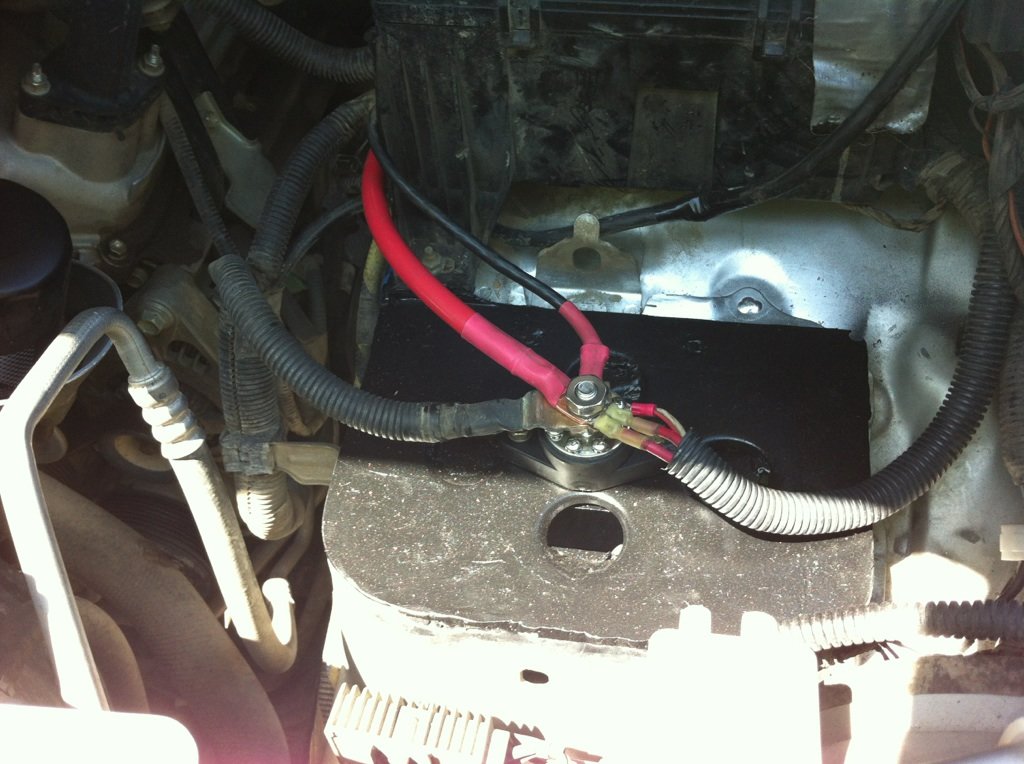

    Dont wait till the sheetmetal starts to crack and come apart......
    Added this awhile ago...but here are some pics....the sheet metal upfront will not support your heavy battery for long if you are beating up your truck in the desert.

    man sticky this shit.....people should know that the spending doesn't stop once they buy a Kit and shocks......wallet will never be the same again

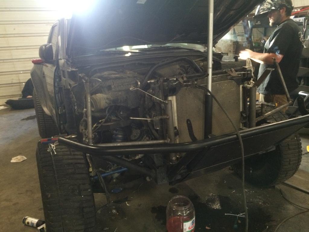

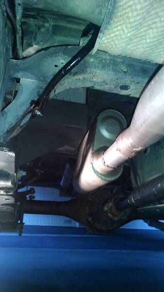

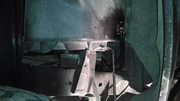

    Mine got to the point where removing the core support was necessary. you could see in pictures that the entire front end of my truck was sagging.
    soooooo if anyone else is having those issues dont be afraid to cut it all out. it took me and some friends to do it all in 2 days. Id say the hardest part was lining everything up so it looked straight.. everything else is pretty much straight forward.

    just get a battery tray from whoever, then just extend the stock wires with ground wire for a welder. you can buy a roll of it from any welding store usually.

    Got a pic where you relocated your battery?

    How did you mount the ac condenser since it's only hanging by clips on the core support? I replaced my core support with an aftermarket sheet metal. Gusseted the whole thing up before re-attaching.

    there is a square frame around the radiator that it bolts to along with tabs coming off the 1.75 tube that it rests on. you can barely see them in the first picture.
