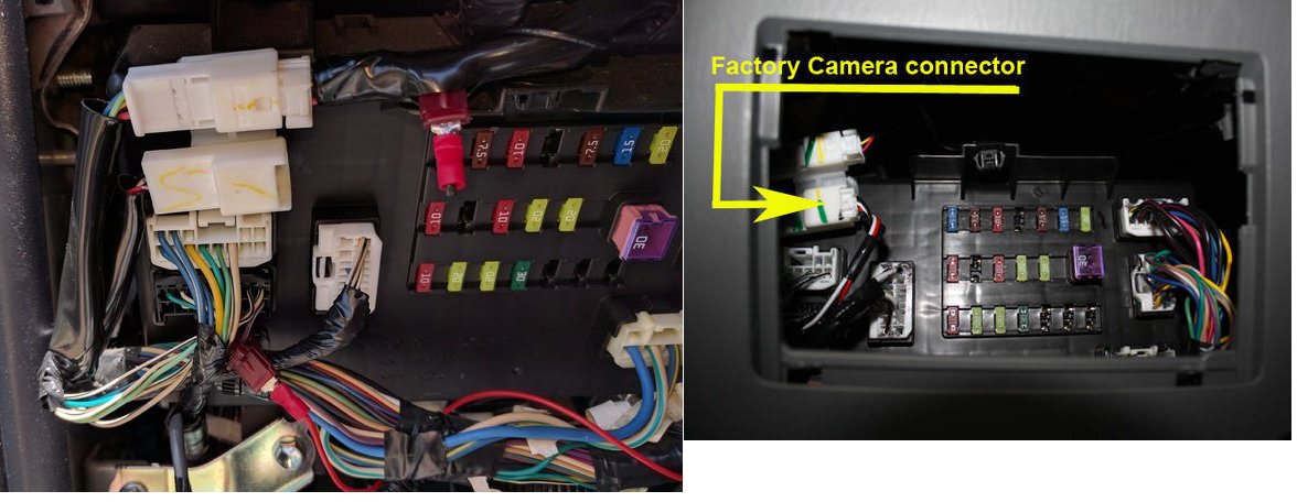

    If you drop the overhead console you should find the wiring.
    My 5 lug '13 was all set. My replacement mirror has the display, auto dim and temp, all PnP

    There's an old thread here somewhere. I had the same situation as you in my old 2009. I'll see if I can find the threads I used for info.

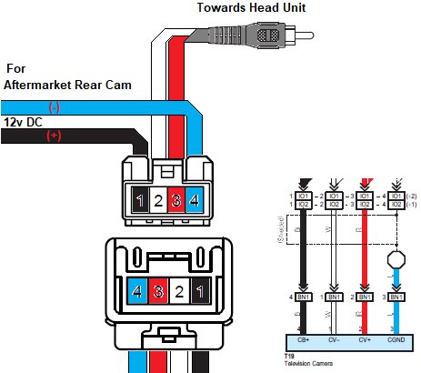

    Don't overlook the fact that the OEM rear camera requires 6vdc, not 12vdc. This is talked about in the threads I linked.

    Would also need to snip the T19 connector at the tailgate handle for an aftermarket cam.

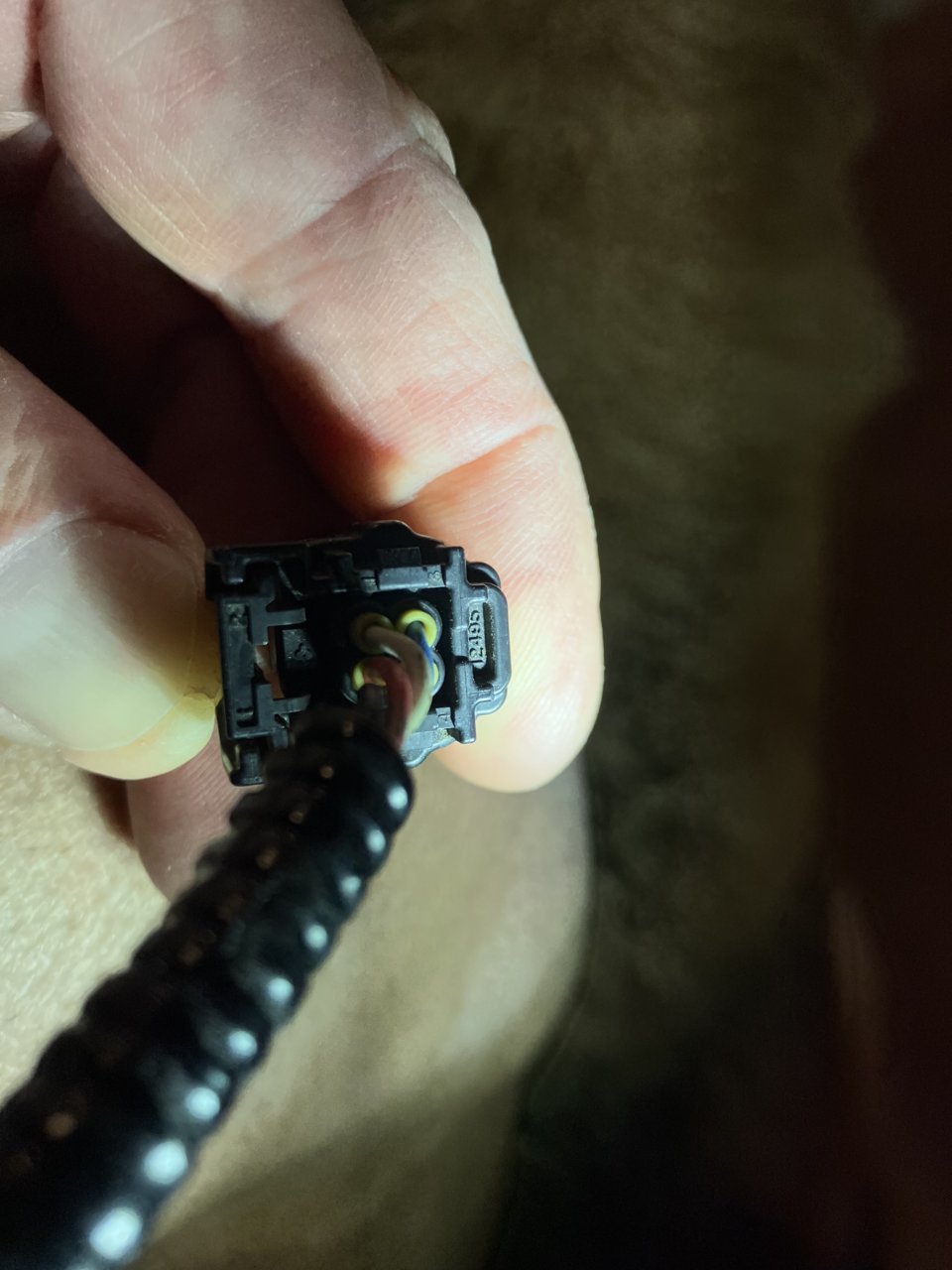

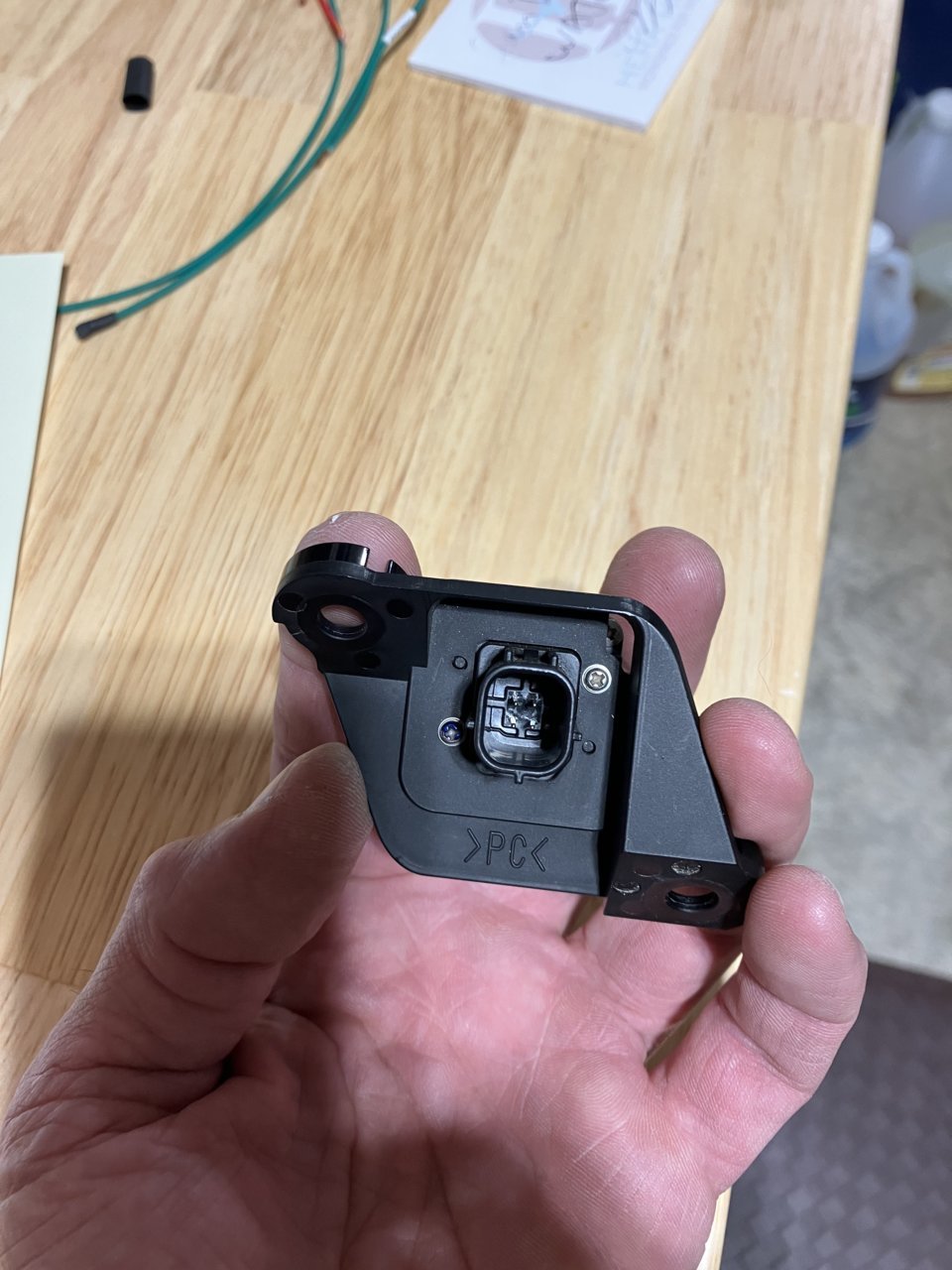

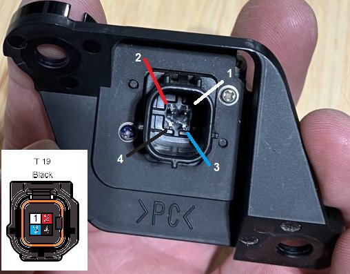

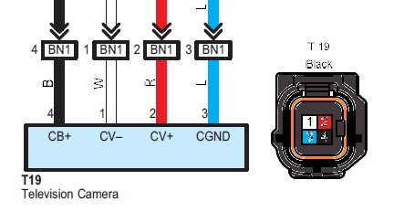

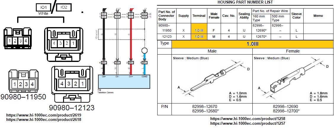

    Do we have the connector into the OEM camera itself documented?
    959582FB-8480-461C-9A73-66E660FC9E3D.jpg E7445542-32B9-44F8-AB07-EB5832E94F96.jpg

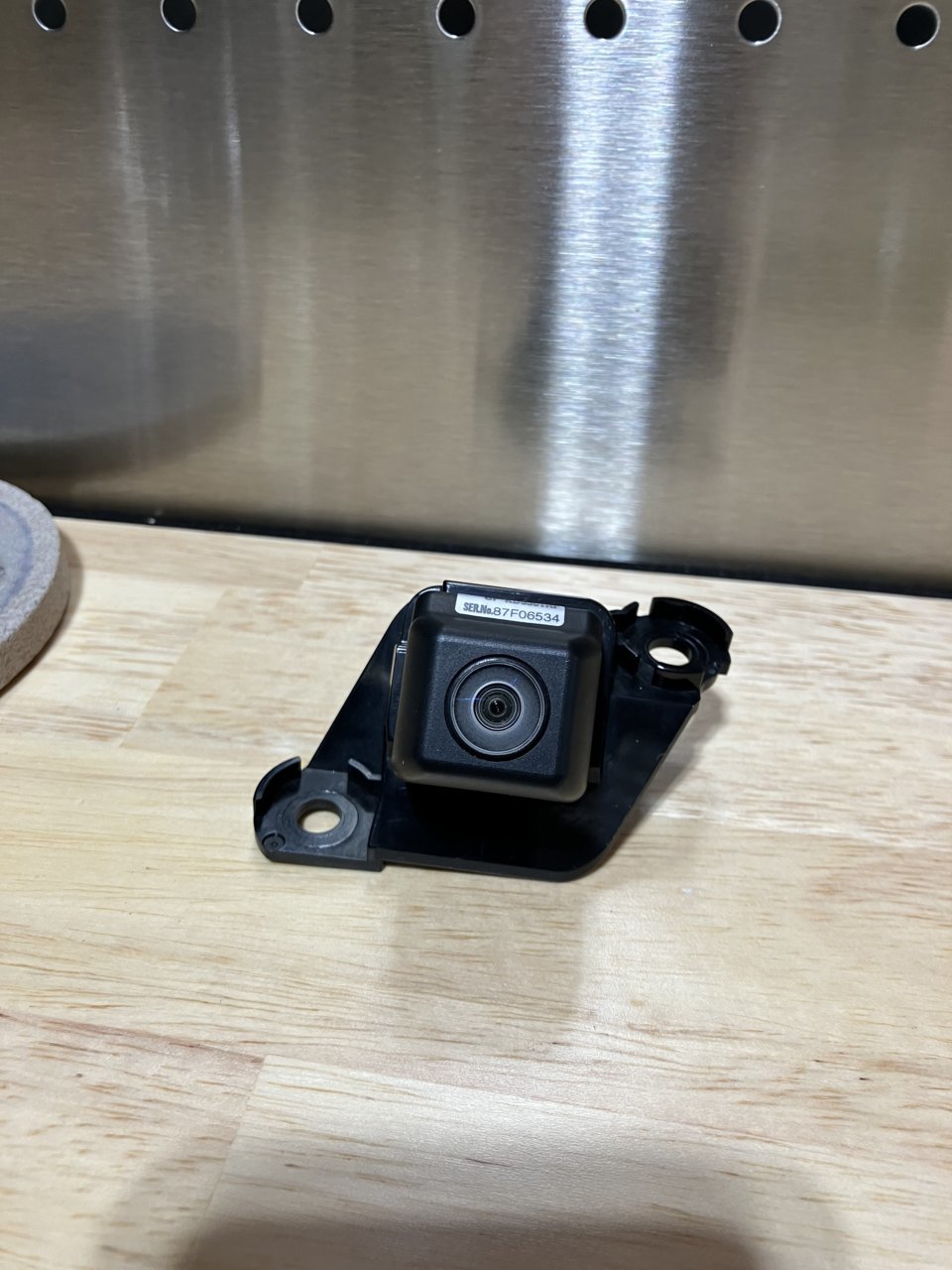

    I think there were 2 cameras. 09-11 and 12-15. I happen to have a 2010 camera and mirror off my truck to take pictures if needed. Let me know
