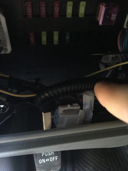

    Ok so I just took another peek behind my coin tray... Never saw this before but is the connector pictured in the bottom the one that runs to the camera?

    Take a better picture. can't really tell. I have a 12 and bought the camera for the tailgate then bought a 13 headunit which now displays the camera image. I made up my own harness. All that is needed to to buy a connector that plugs into the back of the headunit then run the wires down to the fuse box where the connector to the back camera is found.
    Here's a link to get you started. https://www.tacomaworld.com/threads...camera-install-question.399556/#post-11284478
