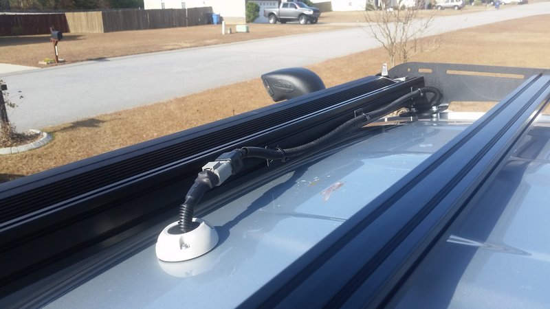

    Used some adhesive zip tie anchors to secure the wiring. 10 pack for $1.80 so if I have to replace them every year then oh well.
    Wrapped it in wire loam as well to keep the sun off. kinda want to wrap the connector also but not sure what to use?

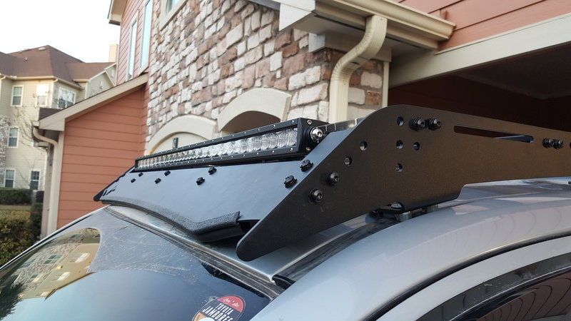

    I also need to play around with the front crossmember to get the light bar possition just right. My 40" is like 1mm to wide for the 40" cuttout fairing. need to bring it back and up just a tiny bit and may need to drill new mounting holes in the side rail, no biggie.

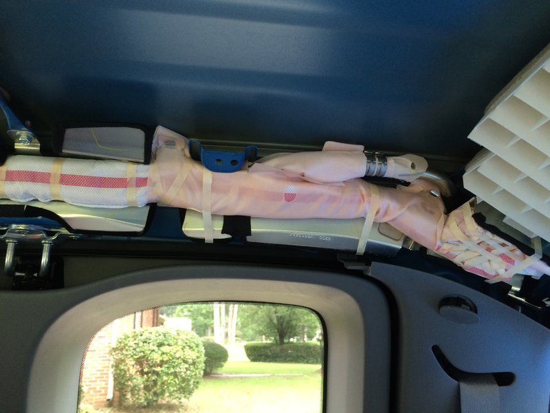

    If I hadn't taken out the headliner, I would have drilled right in to the airbags on both sides for the rear mounting feet. Luckily Zach offered to make me two longer sides that will put the holes I have to drill in the rear past the airbags. When I get some good weather I'll get mine installed. That tool will make it go alot better for me. Good luck.

    Take the headliner out, that way you will be sure. Here is what mine looked like on both sides: The air bags were up against the channel you have to drill through. I would have been screwed. I think the new racks are comming with the longer sides, so it won't be an issue. But to be sure' take the headliner out. It's not that hard, and while it's out you can Dynamat the roof.
