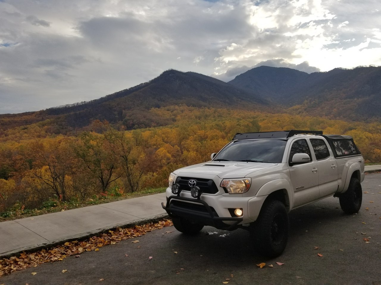

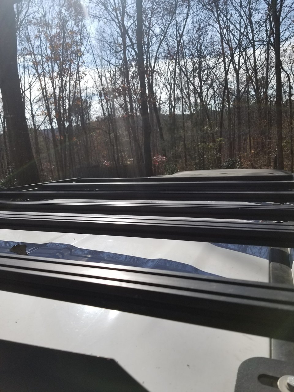

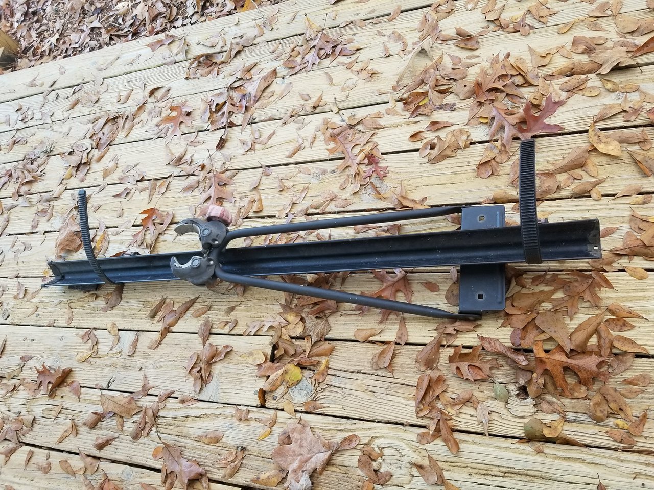

    So I currently have a Prinsu roof rack; I want be able to mount my bike to it preferably by the forks of the bike. I know this isn't a fan favorite because you still have to find a place to store the tire and you have to take the extra 10 min to but the tire on and off when you want to use it. But like most things even though its not practical i just like the way it looks better without the front tire. I have some old yakima bike racks but Im thinking Im going to have to start fresh. I tried mounting them on but they had a little too much wiggle to them for me to feel comfortable about driving with a bike on top. I'm thinking Ill just grab a cheap yakima fork mount and but it on the rack but the part im not sure about is how to mount the back tire to keep it in place. Any ideas? is there a totally better way?
    ill throw in pics of my truck and old yakima racks. and i guess a closer picture of the rack for those who don't have one.20171204_132823.jpg 20171204_132746.jpg 20171106_075100.jpg 20171204_132924.jpg

    Check out 8020 Inc for some t-slot mounting hardware. Should be something in there to get the rack set up.

    Do you want the fork mount on the front of the roof of the truck or at the back with the rear wheel on top of the soft topper?
    Rear wheel doesn’t move much when you use a fork mount.
    I have one that I use and the rear tire sits on the factory hard tonneau cover. because our roads are bumpy and I drive like a teenager, I use a simple tie-strap to keep some tension on the back wheel just in case. I’ve driven without the rear tire secured and it may move left or right a whole 2”.
    Rear tire trays can be made cheap from 1/2 of a PVC pipe.
    Front wheel gets secured in the bed or cab.
    I’d avoid the roof mounting because it’s a pain to get the bike up there. I ride hard and fall harder, last thing I want to do when all banged up is lift my bike over my head and try to hold it steady when setting the fork mount. Trust me, I’ve had incidents...

    The tire will bounce when not secured, but only slightly.
    I’ve used the same setup without the tonneau, the back tire rests on the tailgate instead.
    On my previous Tacoma’s I was able to fit the whole bike in the bed, and I never secured the rear wheel.
    On your roof rack, if the back tire touches the back bar at all, any bungee cord or Velcro strap will secure the wheel to the bar and prevent bouncing or sliding.
