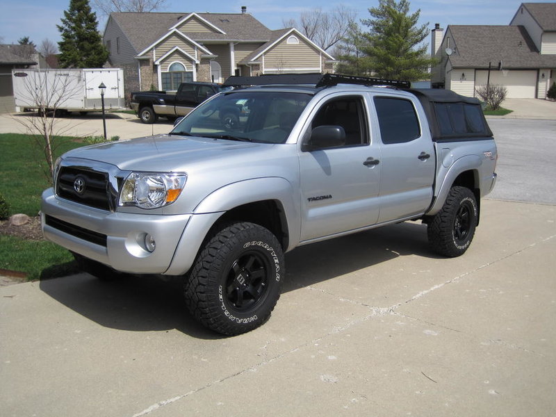

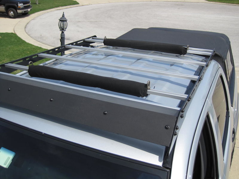

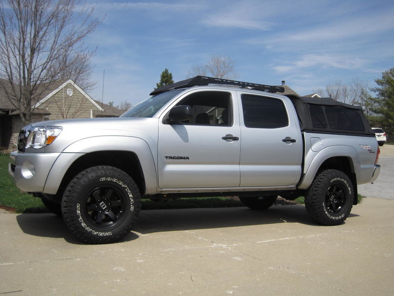

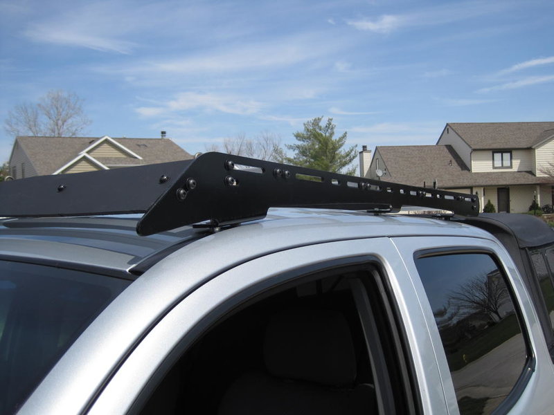

    Ok here are a few pics of my rack powder coated and installed. It's just in my driveway so don't expect some epic pics with the sunset in the background in Moab or anything like that.

    Looks great! What type are your wheels? I really like them as well.

    Looks great....what was your technique with the weather stripping? I plan just to drill holes. Any tips?

    I still haven't done mine. Too much other stuff going on to work on the little things, but I know Goose8651 used a large gauge hole punch to do his.

    I used a hole saw. It wasn't pretty! There is a thin piece of metal that runs down the middle of the weather stripping. The punch might be the way to go.

    Yep, I used a 3/4" punch. Took a little bit of time to punch through the strip, but got it done. If you go this route, start punching from the underside and work your way to to "shown"portion of the molding. Makes the cut cleaner. Need to be spot on though when punching.
