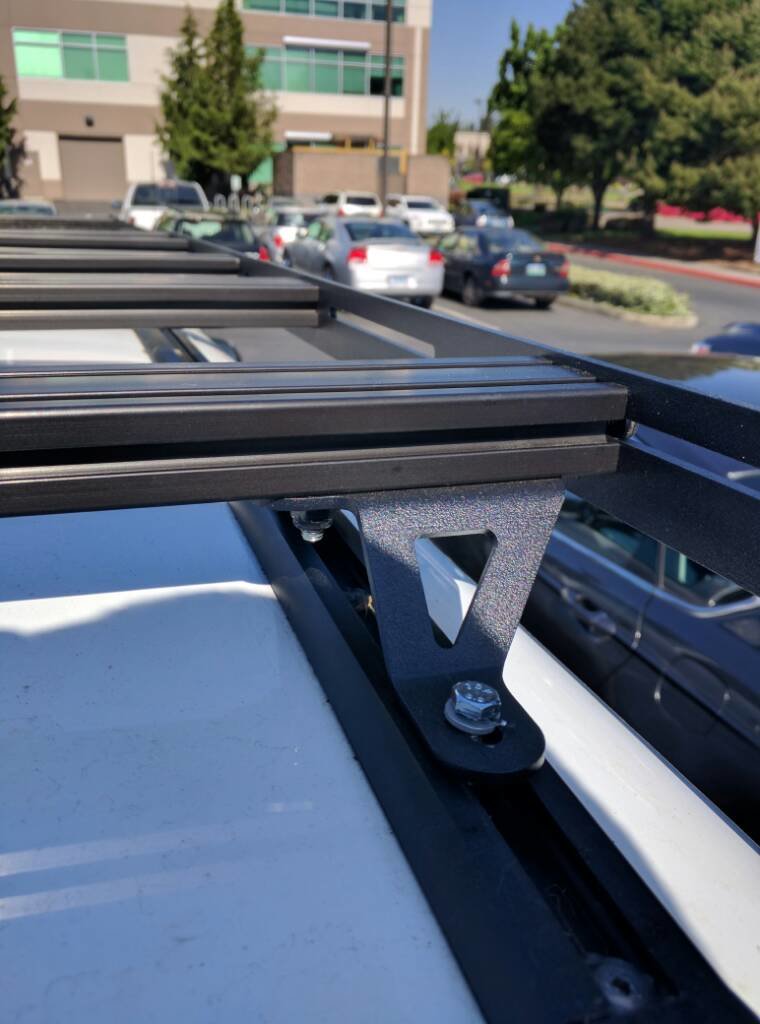

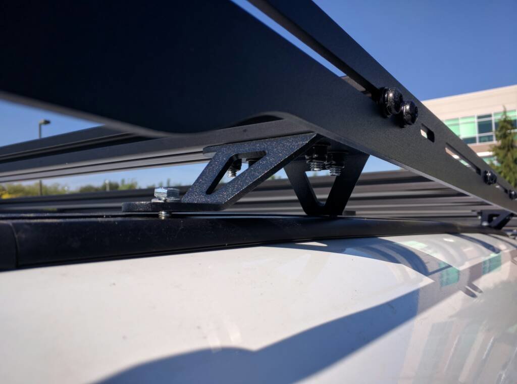

    Here is all I have of the feet. The bracket on top of the cross bar.

    Give me 5 minutes and I will run outside and snap some pics for you!

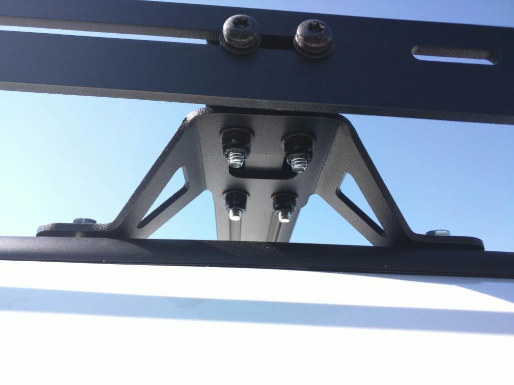

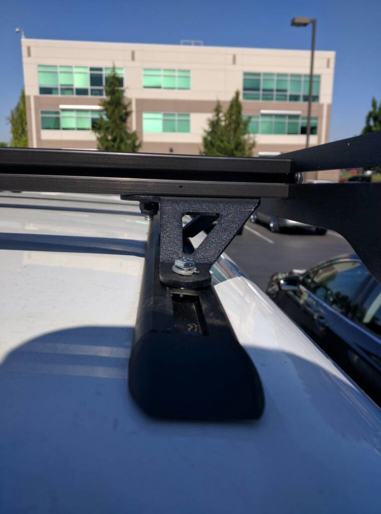

    Hopefully these help!

    Helps a LOT! so the little aluminium colored squares are suppose to just fit in the rails? That was the missing piece of the puzzle lol.

    Yes, Slide the little aluminum squares into the track then the feet screw into those.

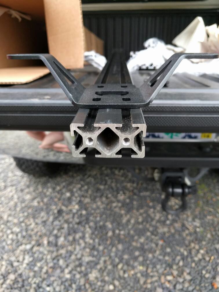

    the feet for yours look a lot different than mine. these were for my toprac from this GB..
    Blackout14 likes this.

    I believe he changed the way the toprac mounts awhile back. You may have a older one?

    mine just came in last month w/ the GB that just ended. could have swapped mid-GB i guess.

    Those brackets look really nice. And thanks for the pictures.

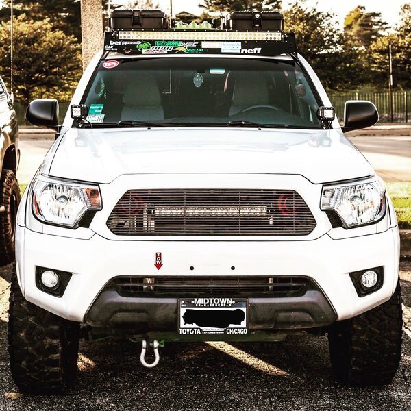

    Single row Heretic
    Double row AVEC

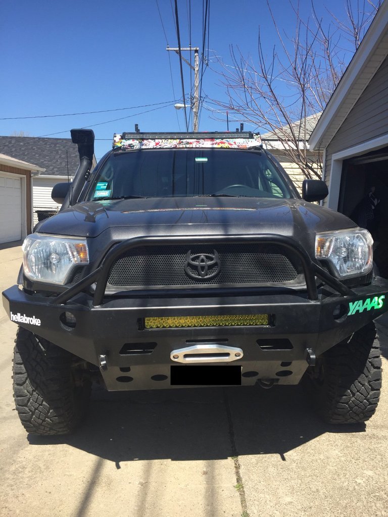

    Double row cheap light bar that sits below my cross bars. Made a mount and posted about it earlier in the thread.
