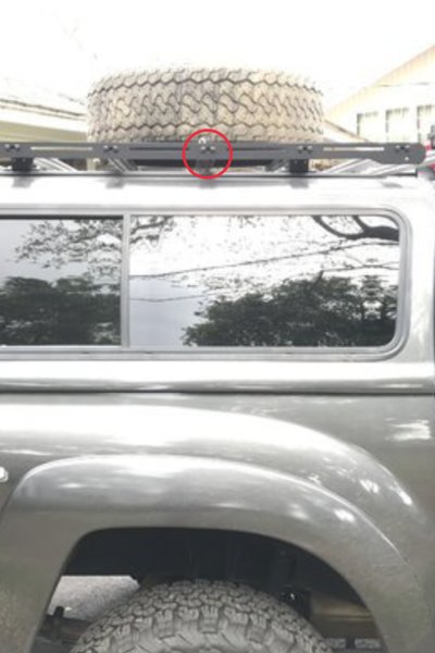

    Nothing worthy
    What about rotating a bar, say the one that sits close to centre under your wheel 90* so it sits vertical and takes a lot more weight that way..?
    Simple and easy to rotate back when no spare is up there..

    So take one of the crossbars and make it perpendicular to the other crossbars underneath the wheel?

    Exactly!
    this one here, take out one bolt on each side, tip 90* and it should keep all three crossbars from bending in theory..

    Ah, I see what you mean, will have to see if that works. Not sure as there is not a hole to be able to put it in that configuration.
    I thought you meant take it out completely and attach it to the crossbars down the middle perpendicular to the other crossbars.

    Works fine, escpecially if just occasional. We 3gens have to run our furtherst back bar vertical all the time. Just tighten the two existing bolts good and it's solid AF
